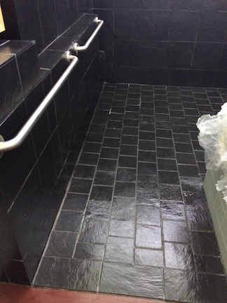

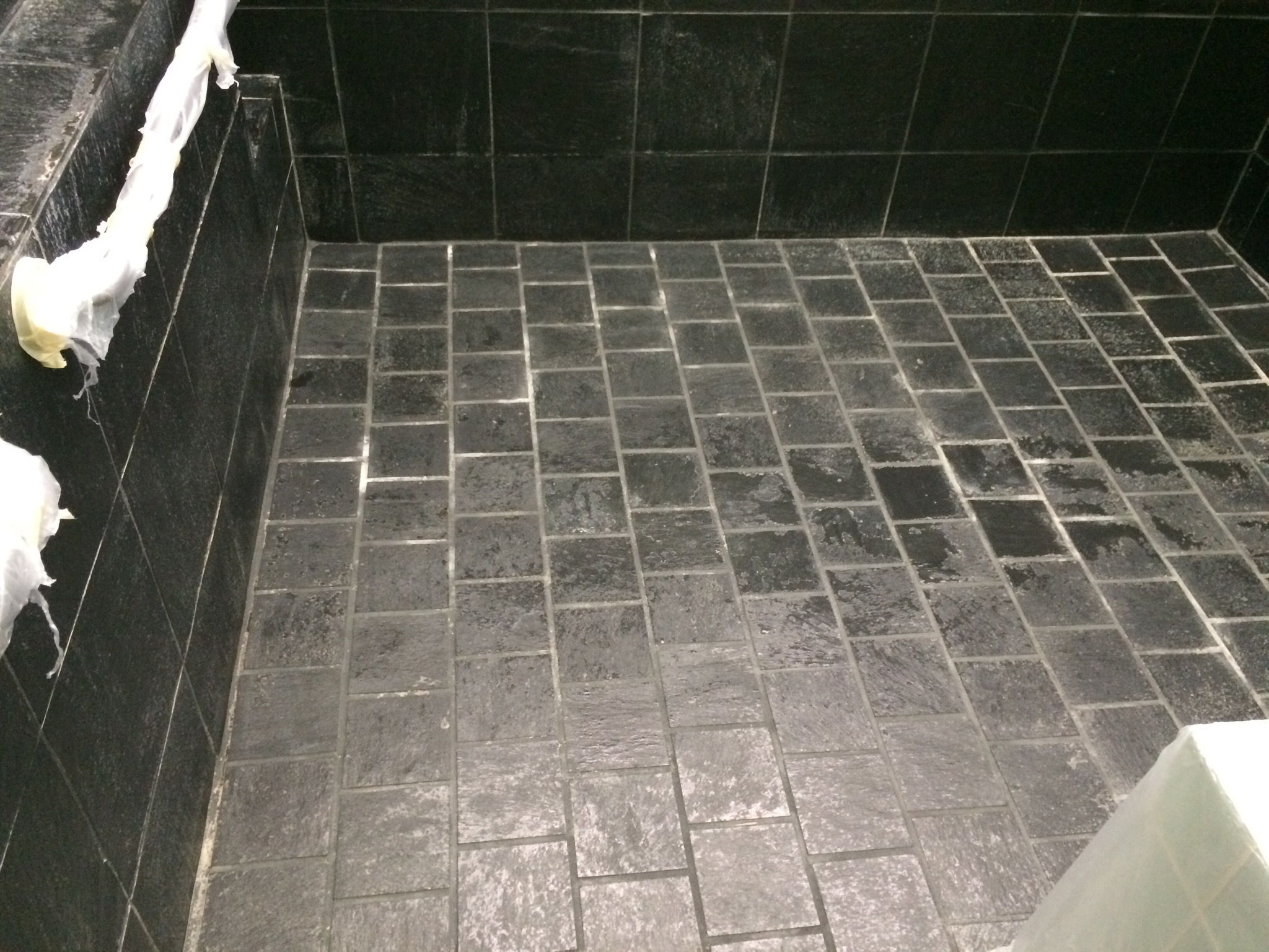

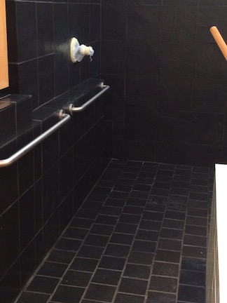

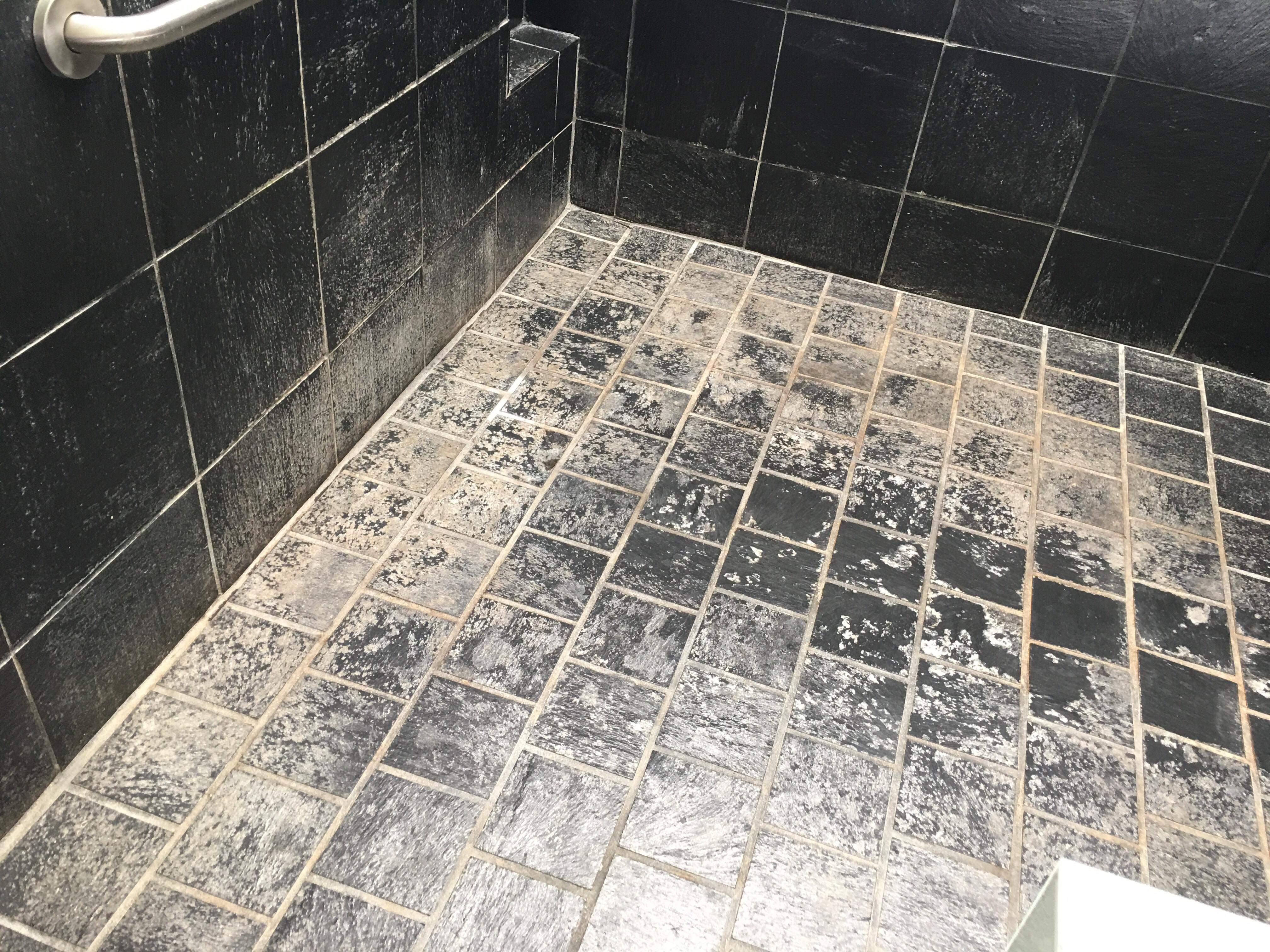

I’m gonna go attack it on the 16th.
I suggested Prochem Professional acid..
forgot to mention a resporator and a tetanus shot.
Diana and I repaired 5k of new quarry tile that a construction company burned with muriatic acid. We toothbrushed all the grout with an enhancer. We were probably 45 thenI've yet to see a Enhancer that was a topical.
Typically they are a penetrate live with a wood stain like additive, which make them oily. They need to to be wiped or buffed off after a few minutes of saturation.
Looks like this owner didn't do that properly
What is mb3?mb3 spray heavy dwell 15 minutes, 220 antiquing brush, repeat if necessary.
Is it possible to put sealer on top of the enhancer?
It's not dried yet.. go back in 3 days
That’s why I told her to send me another pic 2weeks from now. We’ll see. It’s been a good learning job for meMy shower dries so quick I think I could pull off a stone shower if I use triple distilled RO water..
so start to finish how long did the job take?That’s why I told her to send me another pic 2weeks from now. We’ll see. It’s been a good learning job for me
