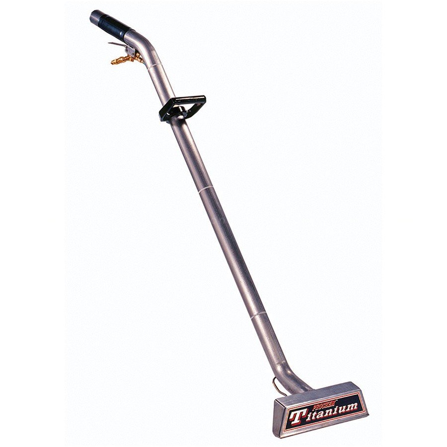

If Ti Prochem was 2 lbs lighter, it would be an ideal wand for me. When six jets don't leak, have an optimal spray pattern and flow, and the head is perfectly aligned with a surface, it's carpet cleaner heaven. Ergo handle and the gun trigger are essential for me. The weight is 9.6 lbs, not so much

Am I the only one in this world who hasn't tried glides? I find them discriminatory towards the carpet. Would there be one that fits Proxhem Ti, a 13.5-inch wand? The wand locks down on cgd at 200 feet at times, but I keep swinging. We have to stay in shape somehow, right?
I'd be willing to try it if someone can recommend good quality glide that lasts a while .

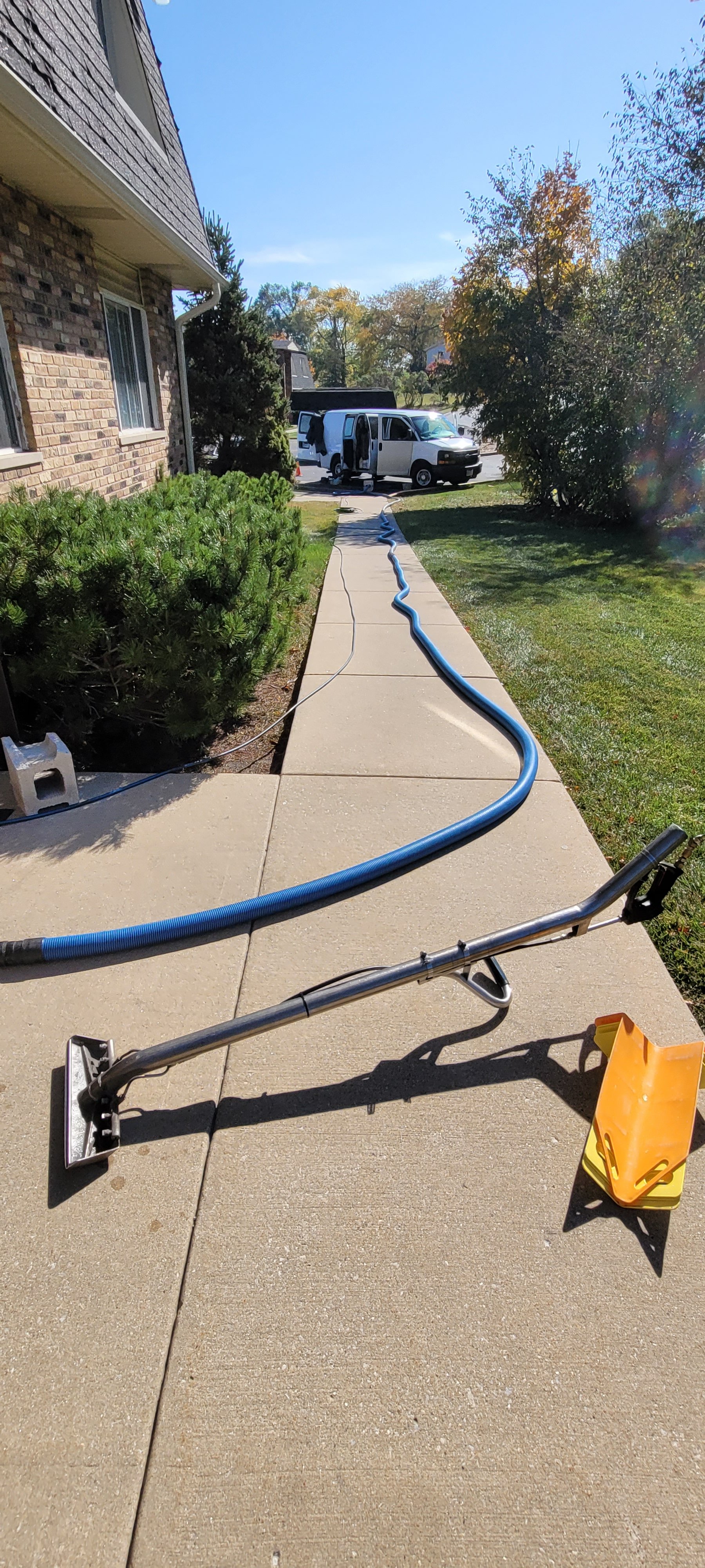

The side handle on Prochem Ti, in my opinion, offers the operator the most allowable comfortable swing. One thing is to have our body aligned with a wand, but the wrist on the side handle means freedom of movement compared to positioning your hand in front of the body when the handle is on the tube of the wand. Maybe is the matter of habit, but I like to use my ' big boy'. I have wands with two different lengths; 62 inches and 65 inches. Both feel right.

Yes , I have four options for the PCTI.
Tearing your right shoulder and elbo apart and setting your self up for arthritis in your later years, is a horrible way to get your exercise.
If you scrub carpets clean with your wand, you are doing a discriminatory disfavour to your body, your company's reputation, your bottom line, your customer's investment and you're damaging the image of our industry as well.
Teflon Glides can last from six months to two years depending on how much cheap rental carpet you clean, as the protruding tackless nails eat up the ends of the Glide.
You can probably find one made out of a harder plastic such as delrin or uhmw or you can make one out of PVC or even a broomstick but none of them will serve the purpose of a Teflon wide and you're probably better off without them.

I don't see the use of glide on the residential carpet where there is enough air movement under the head. Prochem Ti has a wide mouth, lips are nicely rounded, and the wand glides just fine. I don't have to throw the wand forward, and I like to keep it on the carpet most of the time and let it breathe after a few strokes.
The commercial carpet is slightly differrent. The way the others described my" struggles," at the count of 23 restaurants, I should be either Hercules or in a wheelchair. None of it it's true. I would be more concerned about blooming using pads than my wands. I use Brush Pro 20 with renovators, so I'm not throwing all that nasty stuff around. I like to use oreck on the stairs, and on most of the jobs, I use air movers, so when I get an excellent review, I feel appreciated instead of entitled. Reading all that, I don't feel like a hack, but I'm willing to try a glide if I can get one. I used slotted glide( Teflon) many years ago and felt that, contrary to popular belief, I didn't make the carpet dry enough, even with extra dry passes. The glide was used on two jets wand with a number 6 flow. Both of my 6 jet wands are running
"only" on number 10 flow, so I don't think I'm over-wetting the carpet. I'm also satisfied with my current setup
( Reliabilt) and hopeful of adding another in less than two months.
Who distributes green glides? Is it Mike P?
If I were to use glide, I don't think it would be hybrid; I don't want to dig debris from the holes. I have slotted glides on Bonzer. What's your take on hybrid glides?
