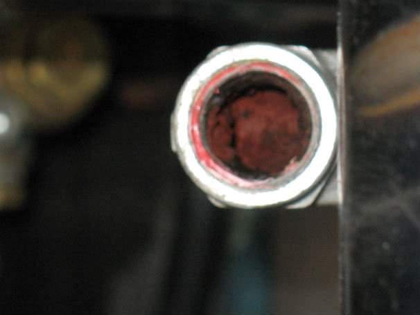

My Super Swivel was leaking.
I pulled it off to replace the O ring and good god, how the water is even getting to my wand is beyond me.
02 flow if I'm lucky.

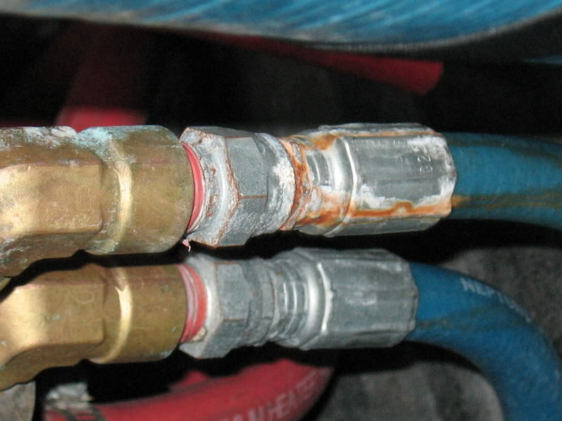

I had heard threw the carpet cleaning grape vine that when I bitched about this way back when..( after I pitched mine out )..AT got wind of it and talked to eagle reels and they made up some stainless shafts for them and can be replaced..I was also told that eagle said that these reel were not intended for water in the fist place that is why they went with the galvanized...Mind you ..this is what I was told I never talked to them personally..but one would think it may be worth a call to Ted and ask...

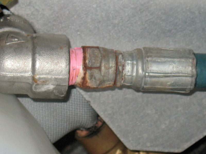

while you are at it you also might want to check out some of you water lines to and from the cat pump..those were galvanized on mine also...If they are do yourself the favor and take them down to a hose shop and have them remake them in stainless and be done with it...sooner or later that crap is going to start flaking and then you are going to have all kinds of problems like I did.....

typical design flaw..there is a lot more machines running around with galvanized parts then what you think......

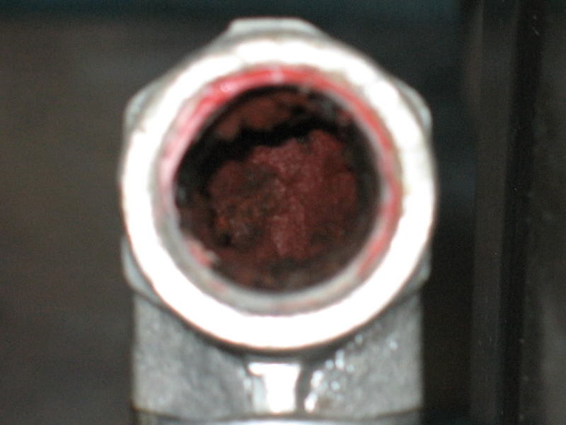

I have a galvinized elbow on my hose reel and some other gal. plumbing I did to hook it up... :oops: Why dose it flake(is it the chem)? I'm checking mine out tomorrow...

galvanized parts and water do not mix well ..the water causes it to rust on the inside and it builds up and starts restricting everything....after awhile the rust starts to flake off and creates problems to some of your other parts...

AT has some new hose reels that they developed that is supposed to kill this issue. I have not seen them or talked to anyone in detail about them. I replace all my internal hoses and fittings after I was getting junk in my check valves after every job. You can replace the hoses and galv fittings 7 times before the SS pay for themselves - already priced them out.
I needed/wanted heavier duty hoses internally anyway to run higher pressure for paver work, so it worked out ok after having one of the hoses blow anyway.
