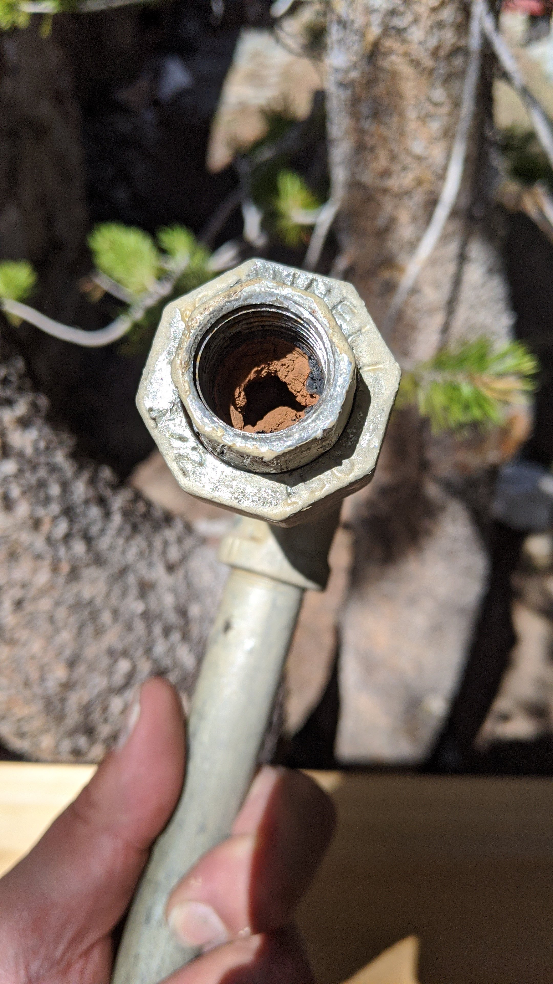

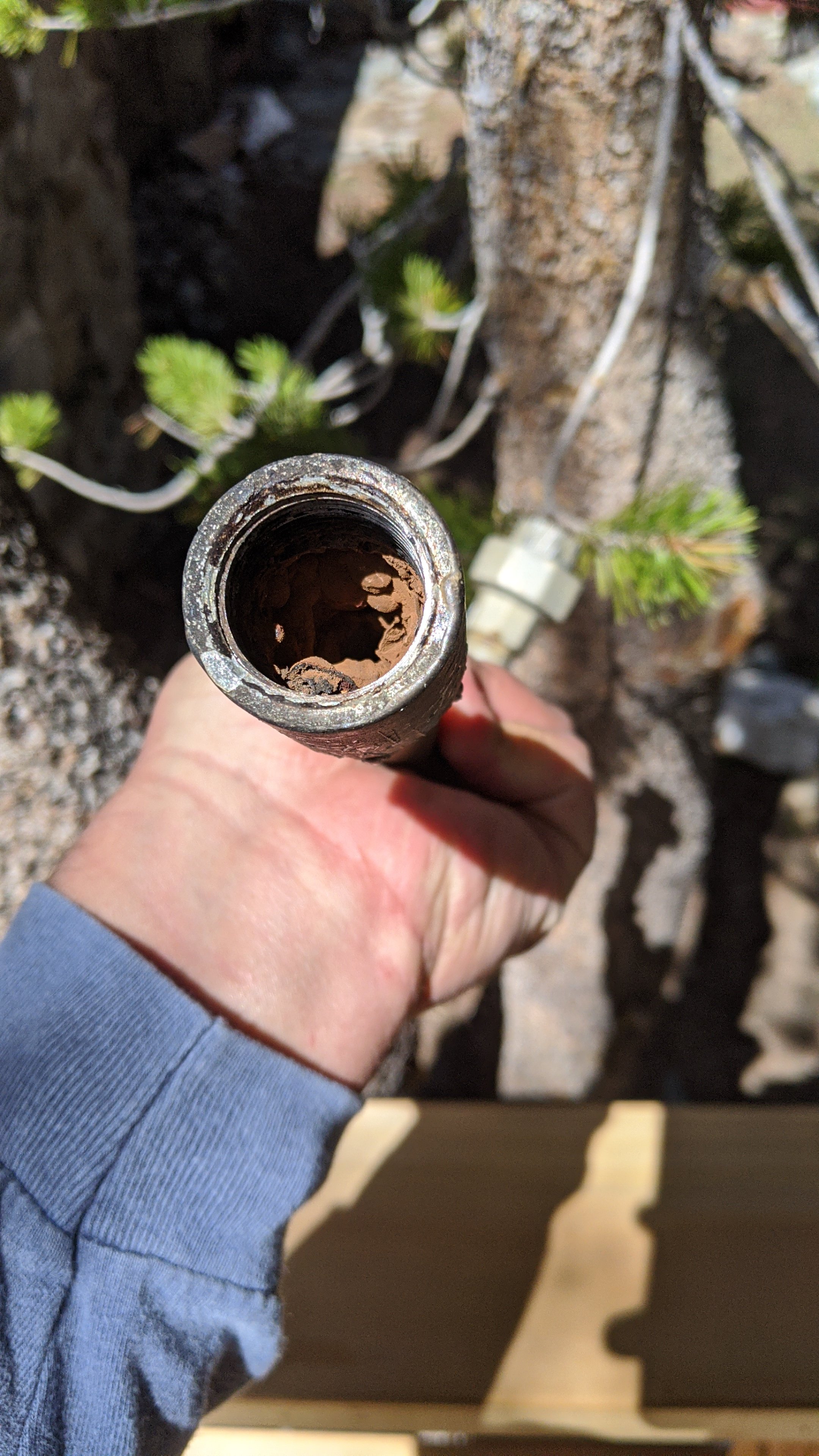

Lake water in Gavly pipes

Cost and time will dictate the fix...
Plastic or stainless....
Scd 40, or for permanent fix, stainless...
Hack Attack
Dec 19, 2017
5,620
Dan
Is it the iron content of the water or breakdown of the pipe?
Had deposits like that in plastic piping from high iron content
Reactions: Fat Mike
galv pipes don't look all that different after 100 years of city water either
replace with PEX (poly)
like they use for well pump plumbing to house
"plastic is fantastic" ...and fo-evah
