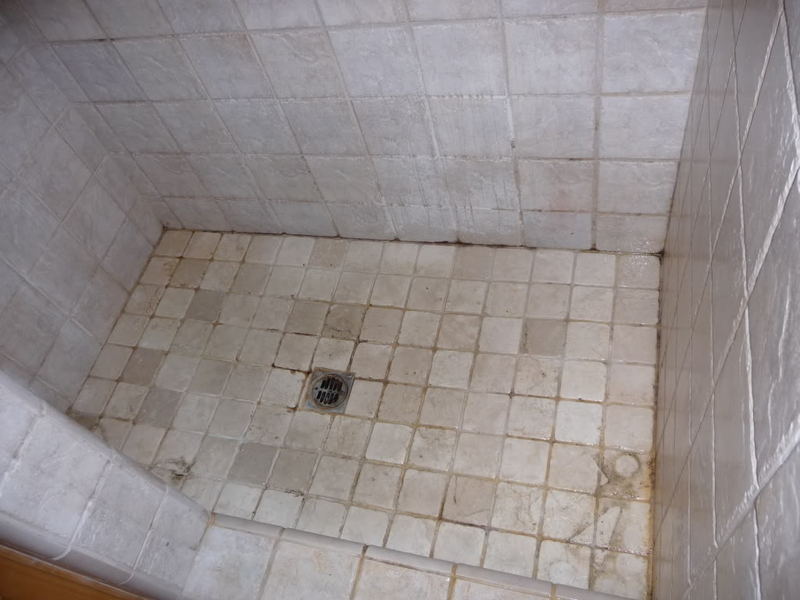

I did that shower and another tub (more pics tomorrow) in 2.5 hours for $715, including some grout repair and re caulking the tub.

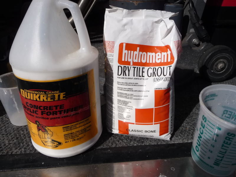

Al's non acid soap scum remover, Stonetech Restore(acid) five razor blades, a grout saw, a small grout brush, a pressure washer(your V and a HF gun), some cotton towels, the Acrylic fortifier and matching non sanded grout for repairing the cracked edges and a well formulated sealer.

Killer, the shower looks great. What do you do when the grout is stained

Albert, use the above tool to scrap off the stained area and cover it with the acrylic non sanded combo

Mikey, I know that concrete doesn't stick to concrete. Does grout stick to grout. I worked for masons and had to apply latex adhesive to get concrete to stick to its self. Is there something in grout that makes it stick to itself.

Scuff up or dig out some old grout and use the Acrylic additive instead of water and it will stick
