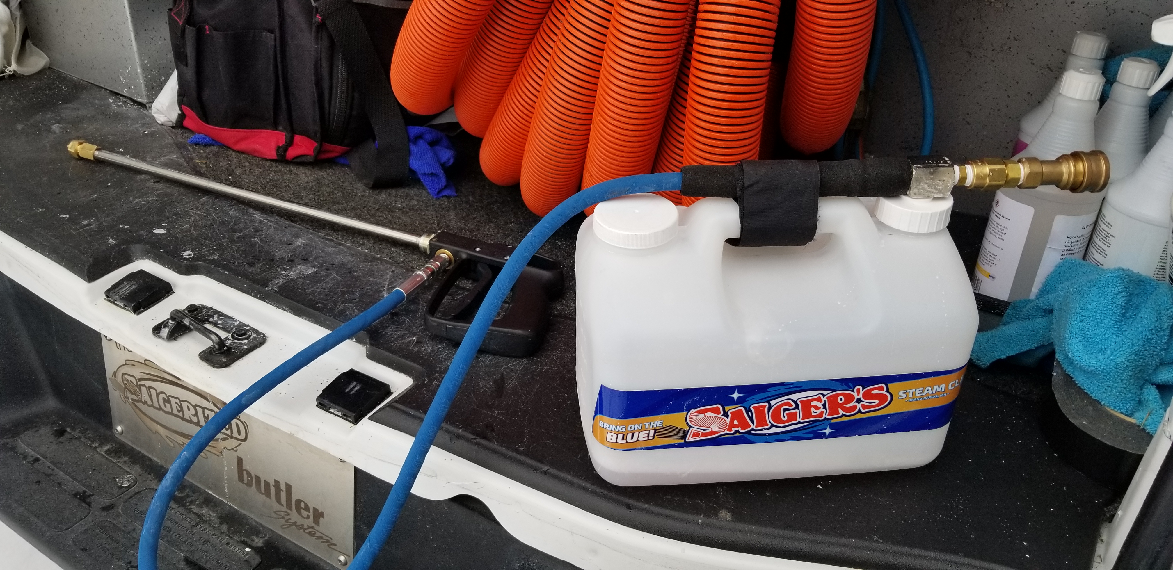

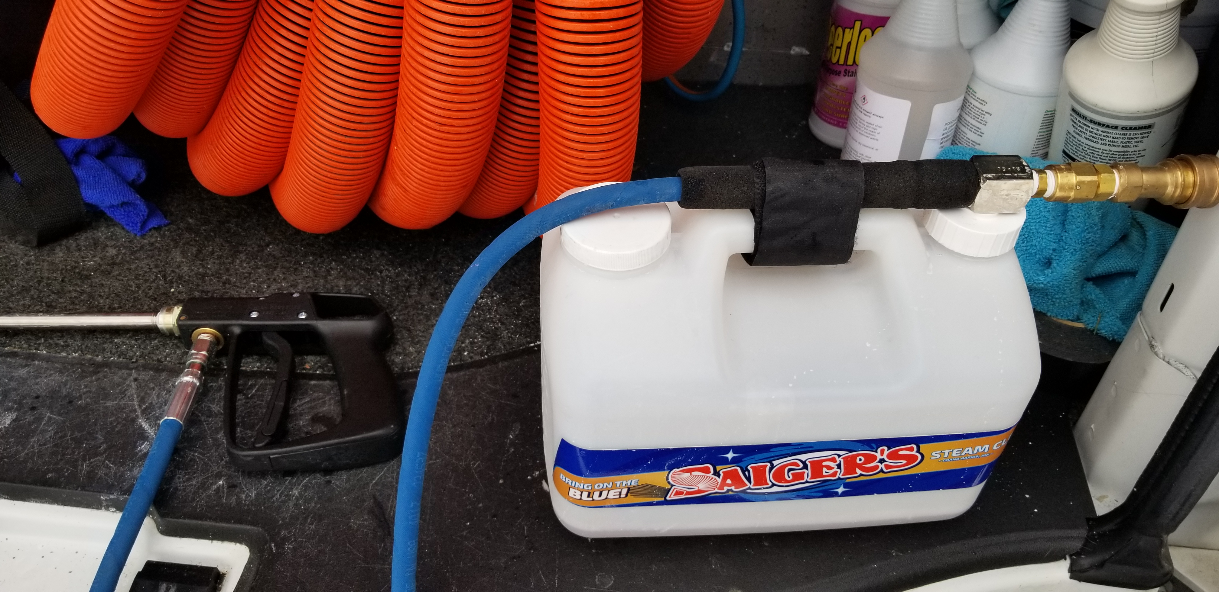

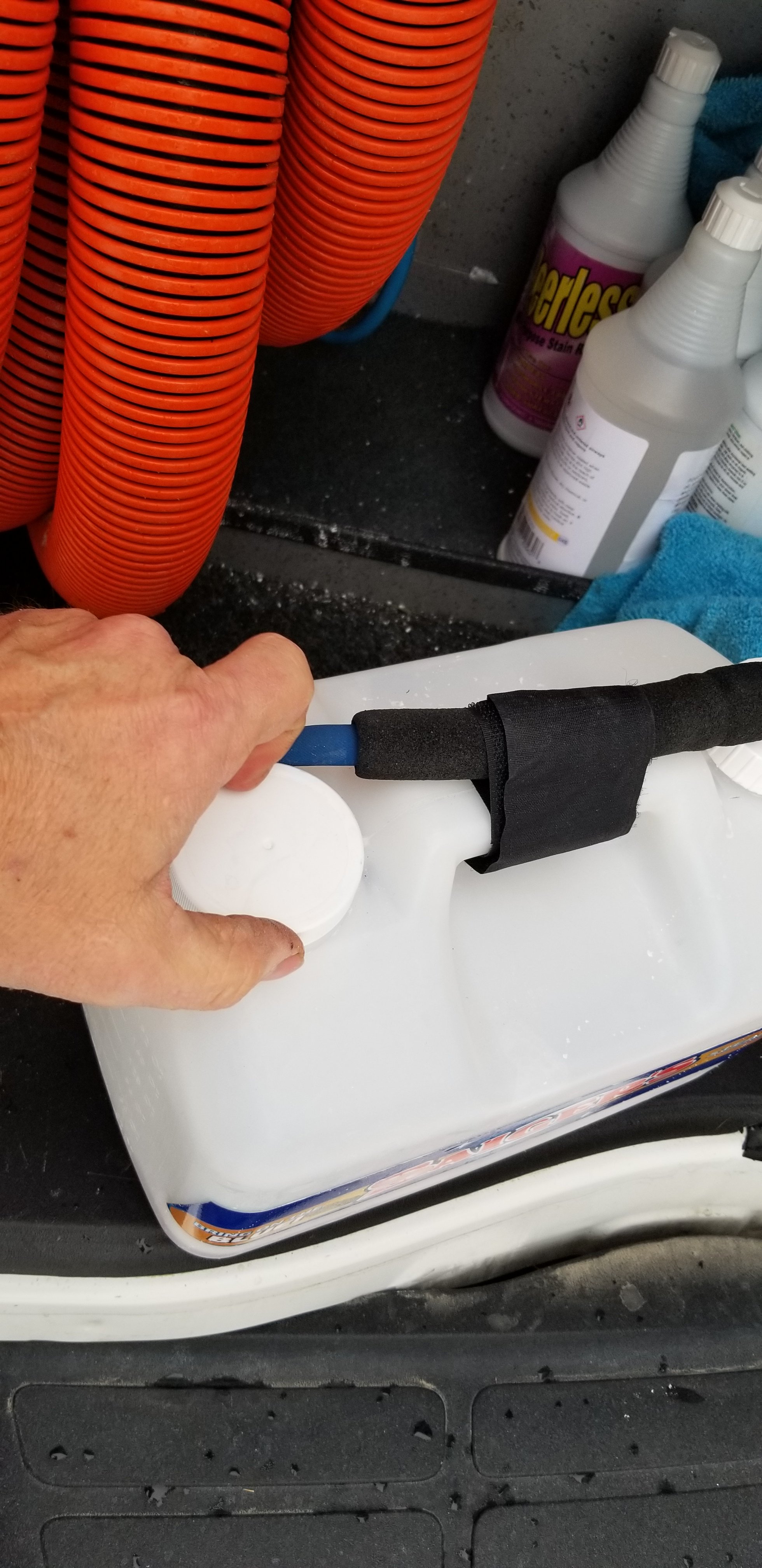

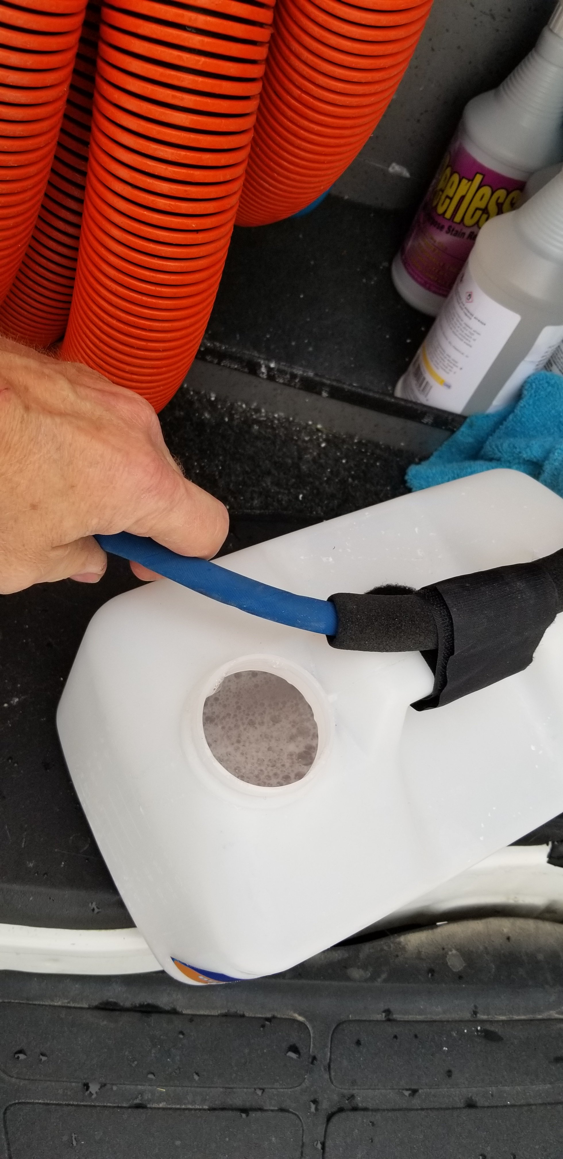

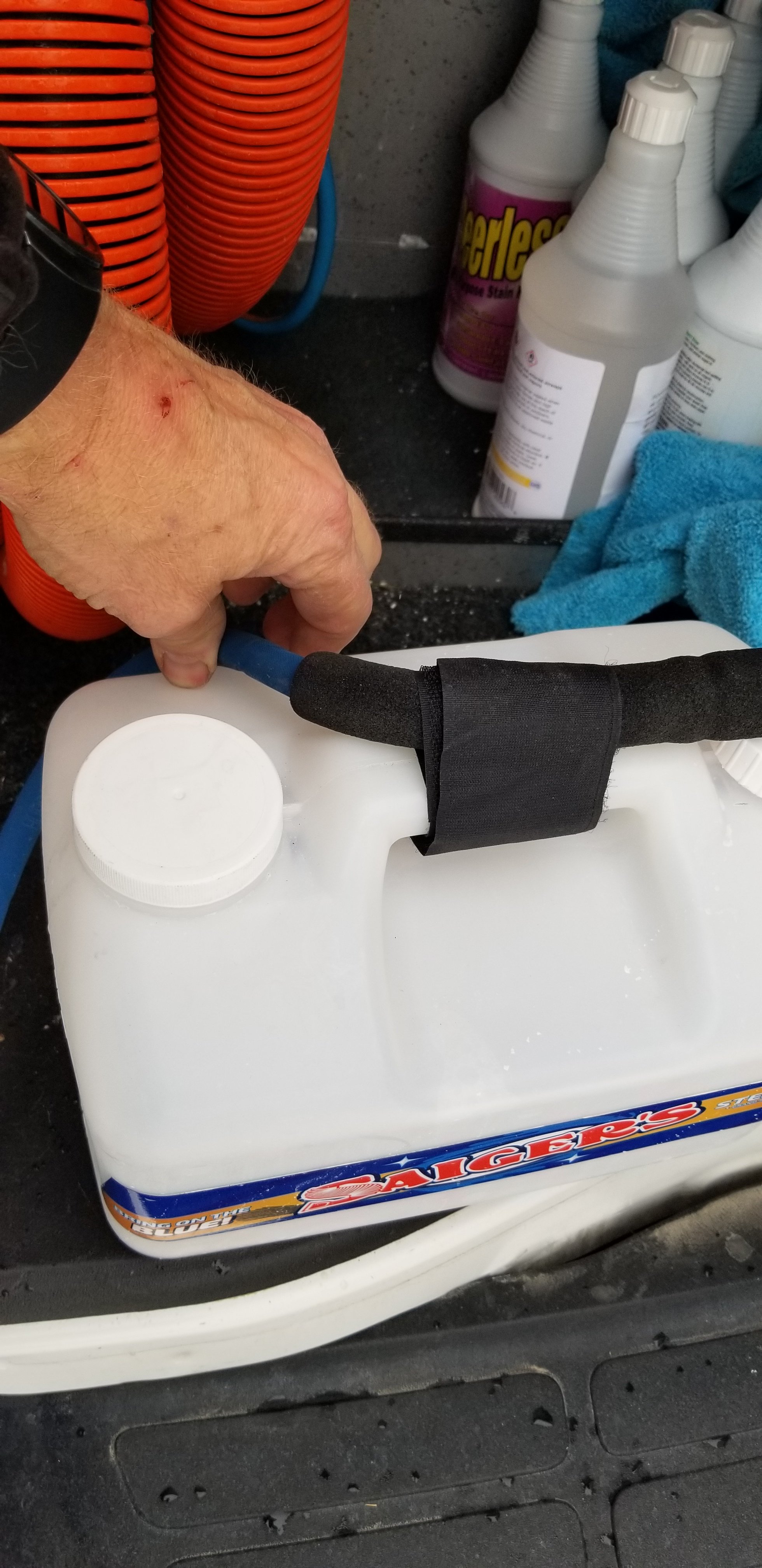

A buddy I know rigged up a spray bottle with a quick coupler. He leaves it full of vinegar and at the end of the day he hooks it up and sprays vinegar through his hydro force. Says it makes them last forever. Seemed unnecessary to me, but I guess he might be smarter than I thought.
28,273
All you need is a bottle of vinegar in the truck. At the end of the day, just put the siphon hose in the vinegar and blow a little through it.
