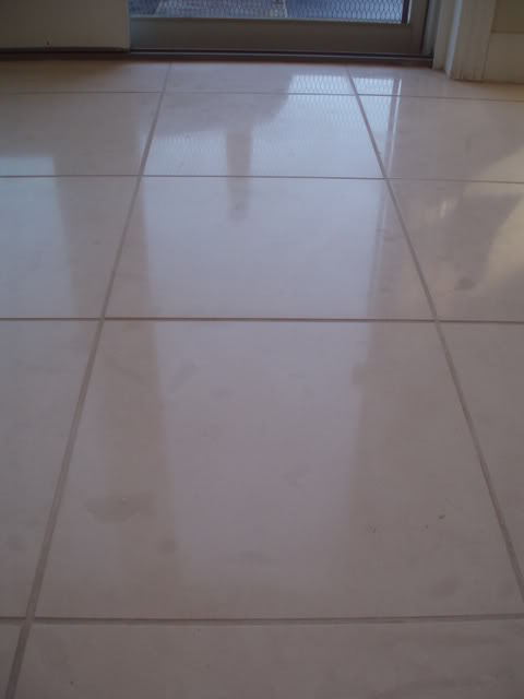

I'm gonna slap some serious Monkey today.
117,324
600 feet of very worn and dirty Limestone.
Monkey pads to the rescue!
I'm gonna win the video contest too.
Wish me luck.

Very dense Limestone full of streaks form the maids using vinegar on it.
I tried the Defender first but due to it's light weight it was not doing squat with a 400 grit pad.
Next I put my 50 pound weight on my 175 and I got results but it was real slow. Next the CX20 came out. It looked like it was working cause the slurry appeared almost instantly but after going through all the grits it just didn't get rid of the vinegar marks.
So back to the 175 we went. It got late so I didn't bother polishing it. I'll do that when we seal it tomorrow.
I got a video clips today and will get more tomorrow.
600 ft @ $3680.

Before we started.
We tried the CX20 w/ the Monkeys buy even it was too lite.
Sealing w/ Dry Treat. 2 coats.
Looks way better, the vinegar streaks are gone but I need some weights for my floor machines for a more consistent shine.
