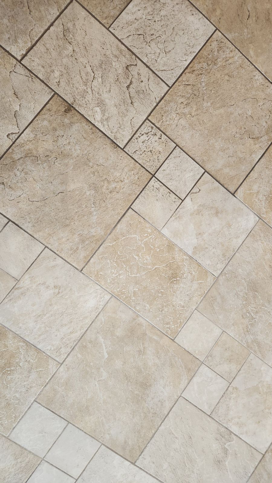

Equipment failure right away, and grout lines look dingy after scrubbing with a high pH cleaner. So this is why folks use acid grout restorer and price accordingly if the customer wants to pay for it. It's all ceramic. Off to my local supplier. I'll be here until night time. F#@! it, I'm going to make this floor sparkle. I want those after pics for my profiles, and a hundred church goers marveling at the stunning tile and grout. This is fun.

The people who contact you will notice and maybe the staff, but in general the people in the congregation won’t notice just a general clean of the tile even if you get the grout sparkling.
Yea that makes sense. I only ended up doing an acidic grout treatment in one small highly trafficked area anyway. It was fun to try it and see the difference. I fully dried the area with air movers after the initial alkaline cleaning so I could see what the grout really looked like, it improved a lot after scrubbing it with the acidic cleaner. I can see how one can restore grout to an extent using it.

Looks like the blue did good. I use black for tile. I’m sure your gauge is just showing 300 when you pull the trigger.
I thought black would be too stiff to dig into grout lines?
My trigger pressure usually hits 400 when I am maxed out. For a while it would only hit 300, seems like something was clogged... Are you saying that maybe the gauge just reads incorrectly?
