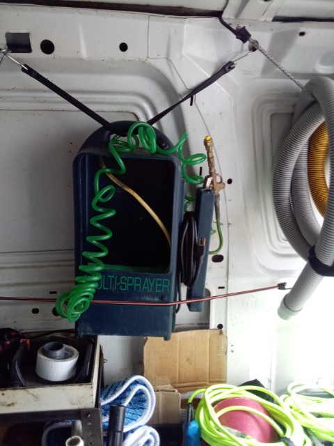

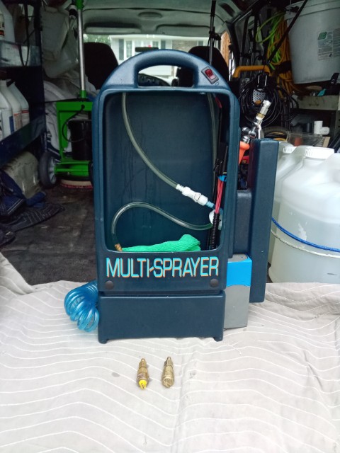

I do a lot of Upholstery. Multi Sprayer is the BEST
I have electric and cordless battery Multi Sprayers. Electric is always in my van and used as a backup. It has to be 20 years old
Battery is what I use most of the time. I've had two. First one lasted about 5 years.
Easy to change jets and jugs
Multi Sprayer is also used for Carpet/Fabric Protector and Deodorizers

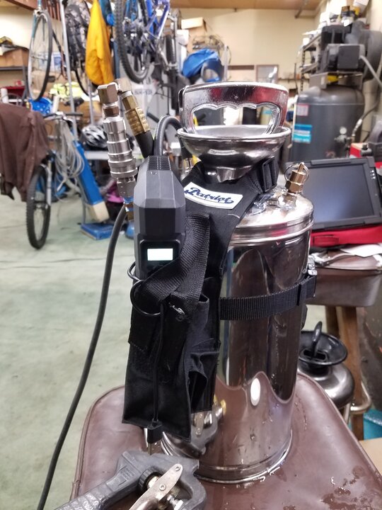

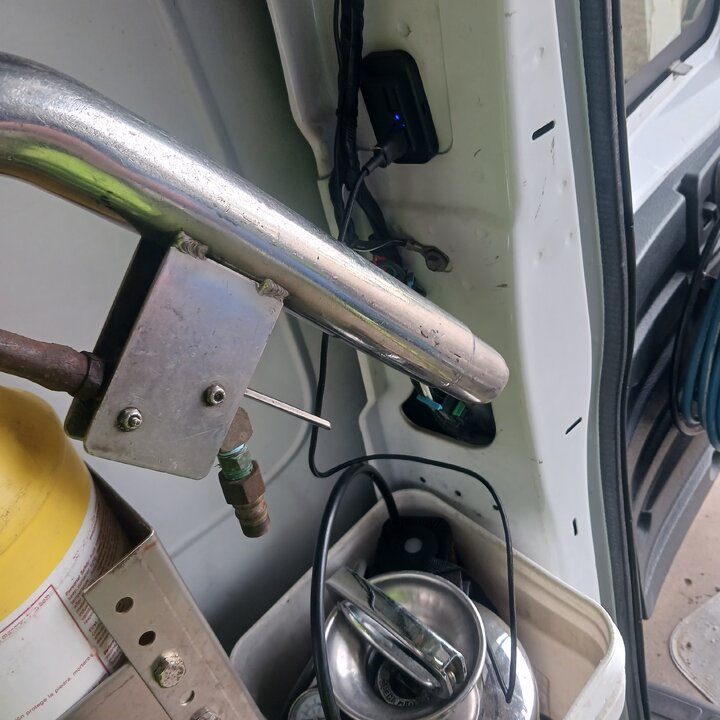

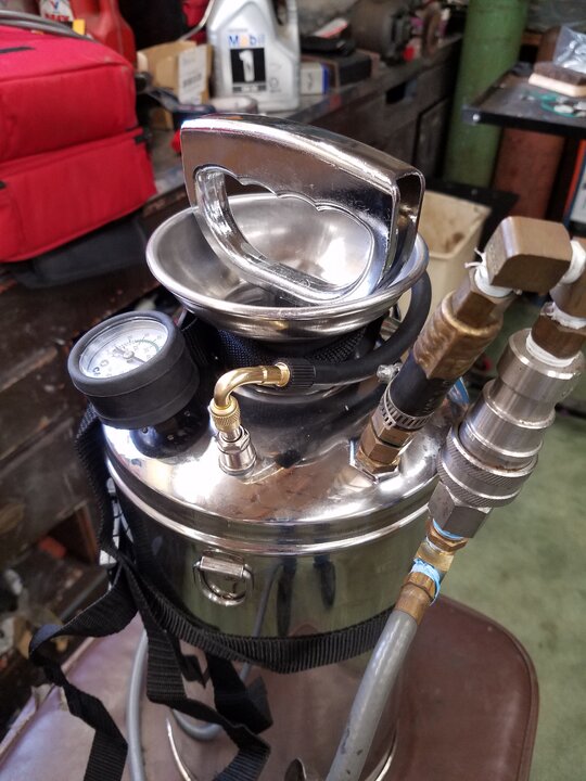

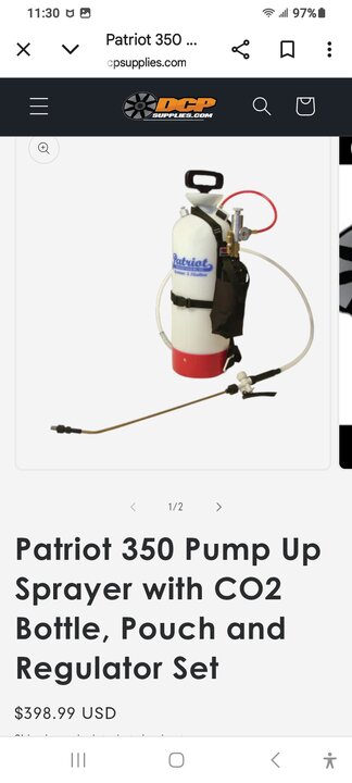

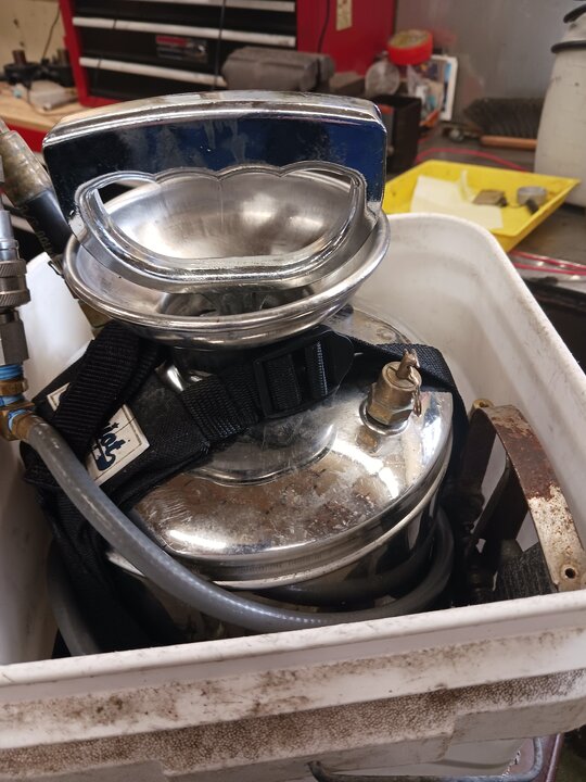

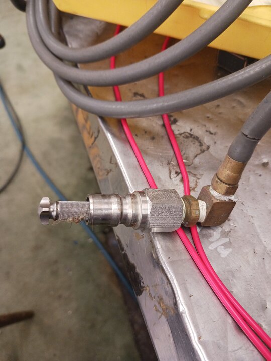

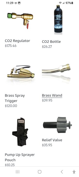

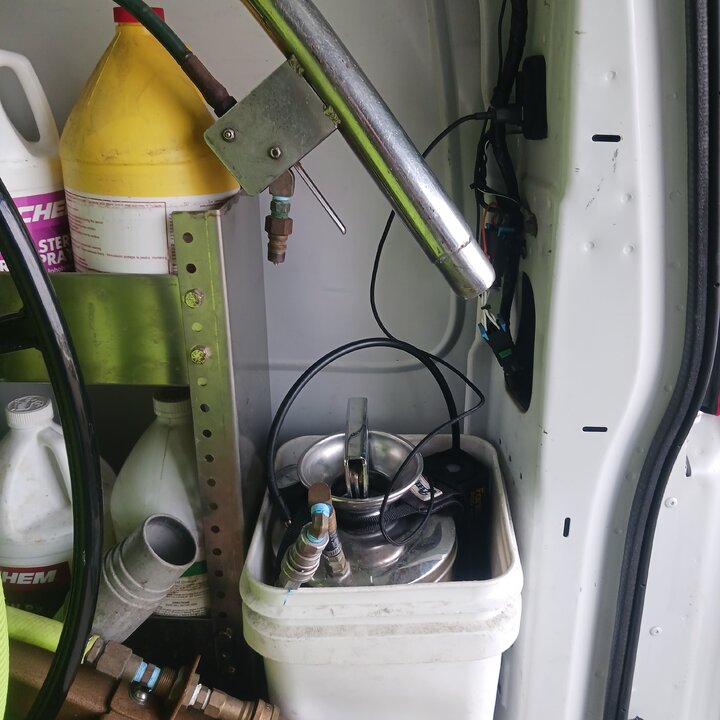

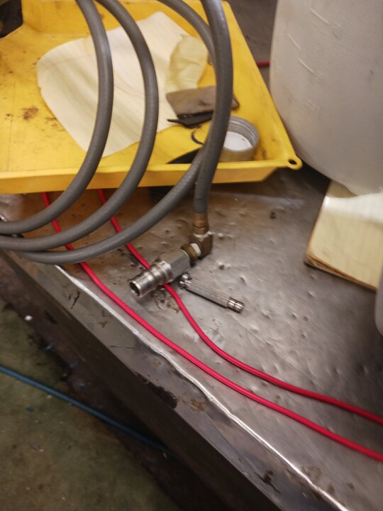

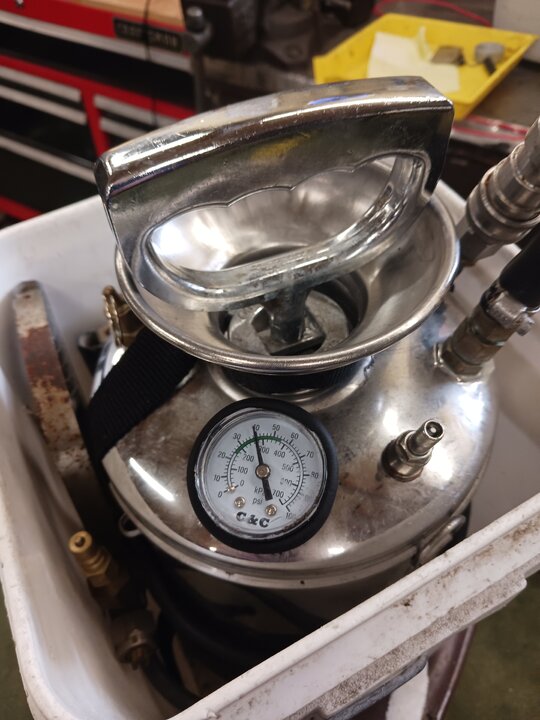

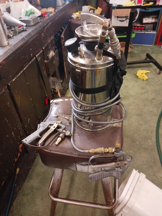

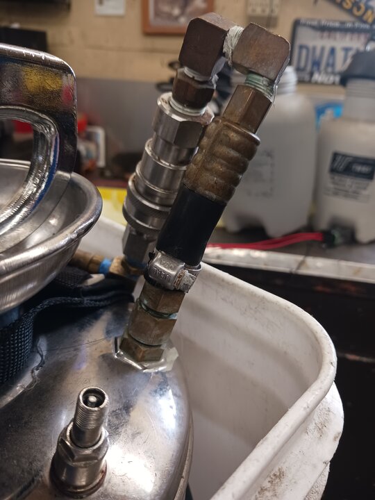

I built mine . Using a longgray 1.5 gal stainless pump up a kleanrite inline quick connect filter 10' hose and gunjet off my hydroforce sprayer and a rechargeable air compressor from Costco. The compressor in in a bag i bought from patriot sprayers. They sell a sprayer that uses a paintball gun co2 bottle to maintain pressure. been using it for yearsno problems even have a dedicated charging port built into my truck to keep it charged i like the patriot sprayers idea of constant pressure but there's no place close for me to recharge the co2 cylinders otherwise i would have bought 1 of them with a spare bottle and modified the hose. A friend of mine stains concrete and uses um and said that the patriot sprayers are expensive but last forever with little or no maintenance . I got about 200.00 in mine

Thanks hope it works for ya. I would like the constant pressure that co2 would allow. As it is now i set the pressure at 60psi and when it drops to around 40 i have to hit the button on the air compressor. Look up patriot sprayers you can just buythe pressure regulator and bag and hang on any sprayer that has a Schrader and relief valve like the longgray.

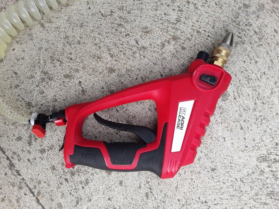

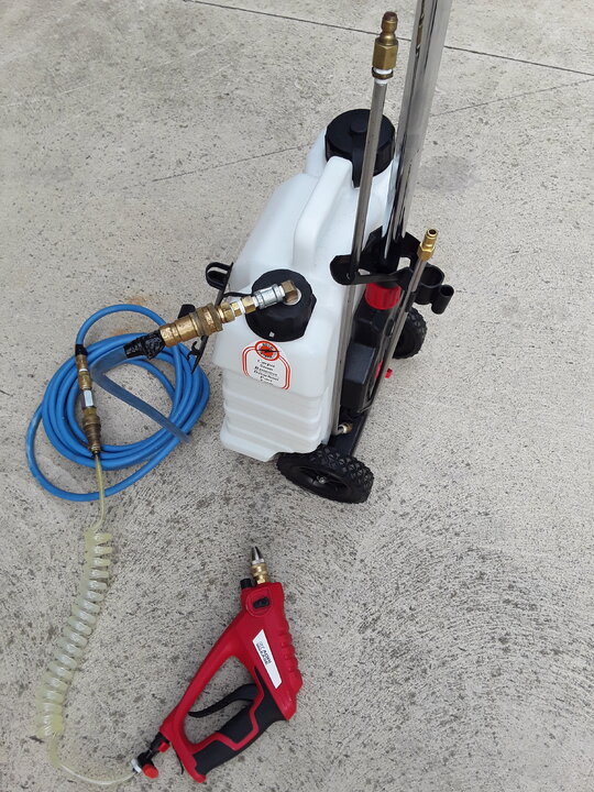

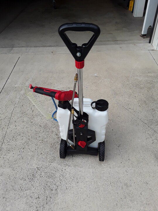

Cool, are you using the wand and jet that came with it or swapping it out for longer hose and tee or vee jet?
Dwain Ray
Jul 22, 2020
1,175

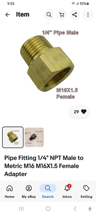

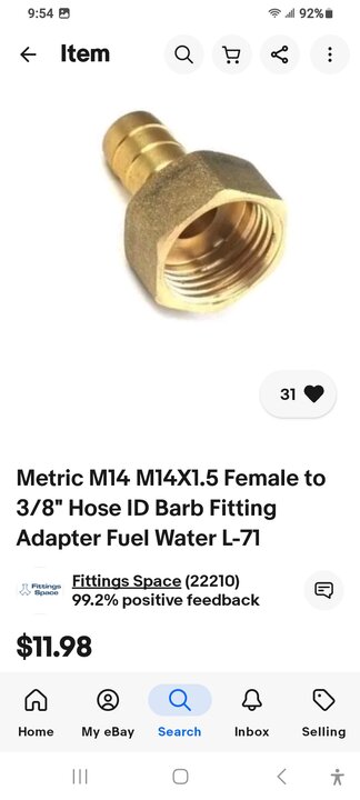

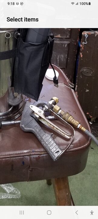

yeah, im not too impressed with the jet on it, s I'll see how I can switch it to a v jet

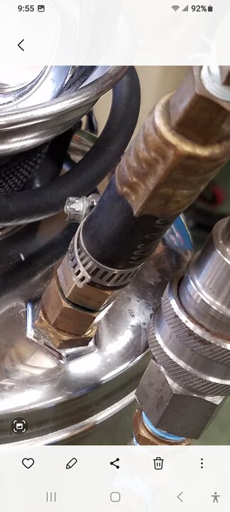

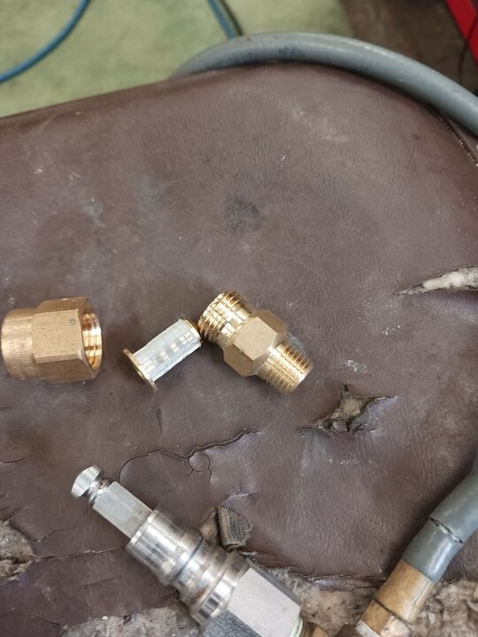

Im sure you can do it with the right adapters. Youll need a metric &sae thread pitch guage to find out what you're adapting from and to for me it was a couple of brass adapters and the hose and gunjet off my hydroforce sprayer and I was done( the ebay adapter pics were from 2 different things i adapted. But sent to.give ya the idea)(i used the hose barb one on my sprayer)

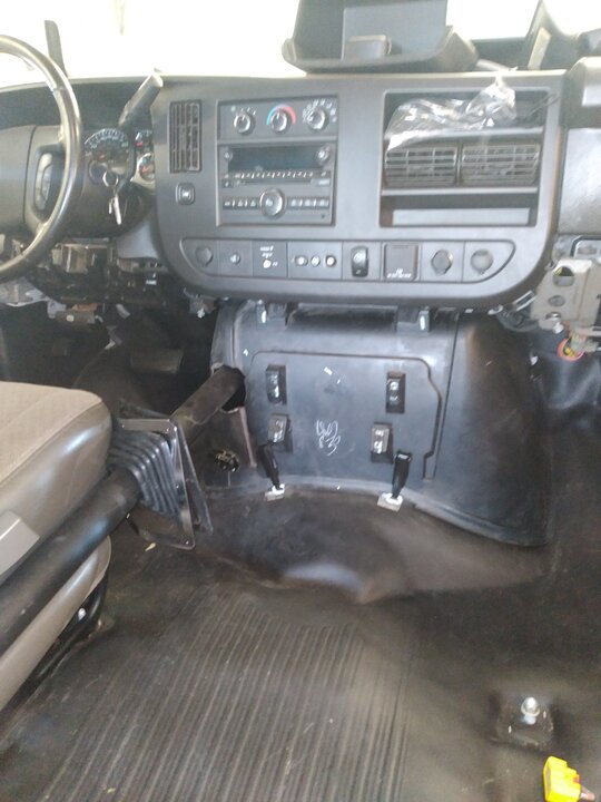

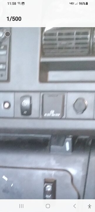

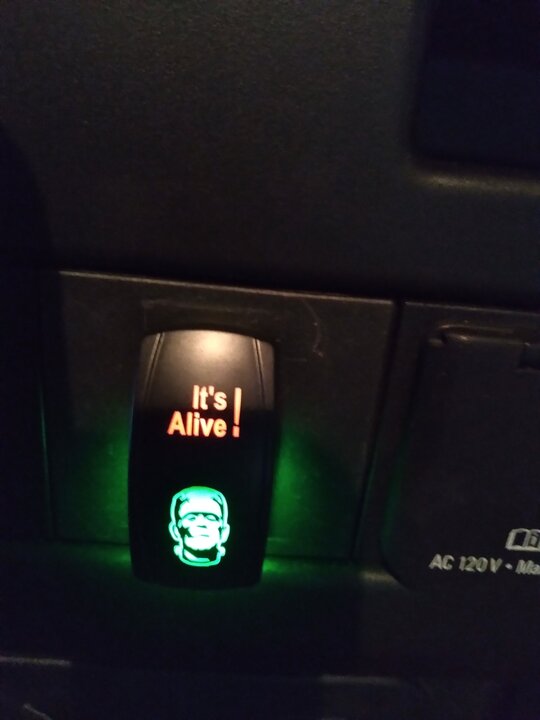

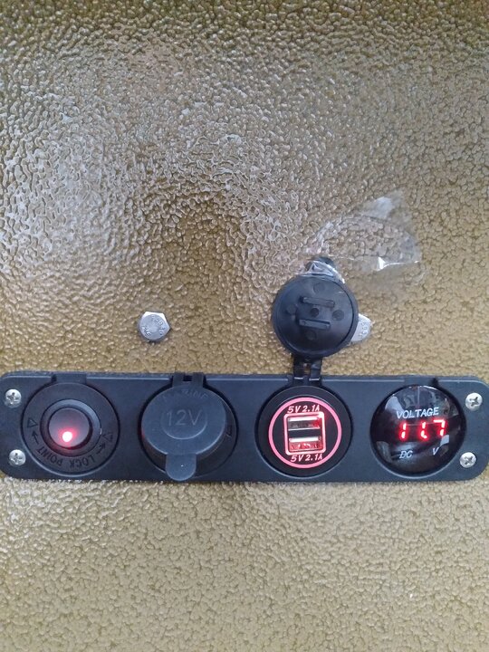

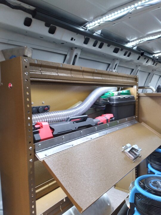

I agree, id have one if i didn't already have the stainless sprayer. I had already converted it to the 10' hose, inline filter and metal gunjet. To add the bag and compressor it was only 60 bucks more. I wish the compressor had a setting to maintain a set pressure instead of having to start it when the pressure runs low . But i do like the fact that if anything happens to the compressor i can still pump it up manually . And in the unlikely event that i have a low tire on the job i can pump it up with the compressor too. Does your van have a 110v outlet for charging? Mine has one on the dash. It comes in handy when i have to use my milwaukee m12 led light tower. I can keep a battery in the charger ready to go i also built in a usb&12v charging ports into my back cabinet

Mine is both, ya might say best of both worlds or built with manual backup.I can use the compressor and if it for some reason doesn't work it has a stainless steel hand pump and i can just use that and continue working
