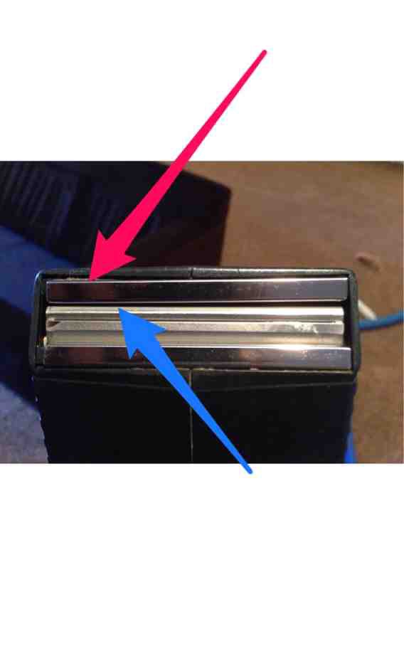

I replaced the head of my upholstery tool this summer because the metal glide or lip was catching the fabric and giving me inconsistent and uneven cleaning. I don't know about you big shots but I can't believe something like this costs @ $500. When I charge a custy big money, I try to give them big quality and service. This is a pic from today. Should I just chuck this thing in the trash and go for the SS that everyone loves?

Got rid of mine several years ago for similar reasons.
Good riddance said I.
My favourites now are the:
HydroKinetic & the Sapphire Scientific hand tools.
The SS is marginally lighter than the HK.
For most upholstery I choose the tool depending on the curves and tightness of the fabric.
I believe I get a better dry time with the HK.
For big runs of large flat expanses, the HK is for me.
Everyone has a different idea of their tool of choice.
Not too many (apparently) choose the DriMaster, unless they want a cheaper priced tool.
There's also a reason why tools are priced cheaper. :frown: :winky:

I'm a little put out because this is clearly a design flaw of the DM. I had to buy the new head for cost @ $60 that was supposed to fix the problem. Now, just a couple months later, same thing. Some of you hot shots can find $500 in your sofa, but not the Kid. I spend that kind of scratch on an upholstery tool, I expect it to practically clean for me while I sit back and watch it all happen.

Take tool back to your distributor and ask him to exchange it for the new design

I bought the DM several years ago and replaced the head early this past Summer at my expense. I guess it's worth giving them a call to see if they'll do anything for me.

Doyle and Marcus from HydraMaster have jumped on this issue and are taking great care of me and the situation with the tool. Marcus told me they are aware of this design flaw and they have gone back to the drawing board with a completely new design being released sometime soon. Thanks guys!

I hope they replace the tool for you out of courtesy for selling a tool not suitable for the job it was designed for.
It pleases my heart when I see manufacturers &/or distributors take note and action on constructive criticism of their products that have been posted of forums.
I've always been a believer that if a product is not suitable for the job it was designed for, then it should either be replaced or purchase price refunded in full.

that was a main selling feature of the HK tool, teflon glide. No chance of snagging
I really liked the original Drimaster, I thought it was a great tool. Didn't care much for the new generation, same issues with the sharp lips as mentioned.
