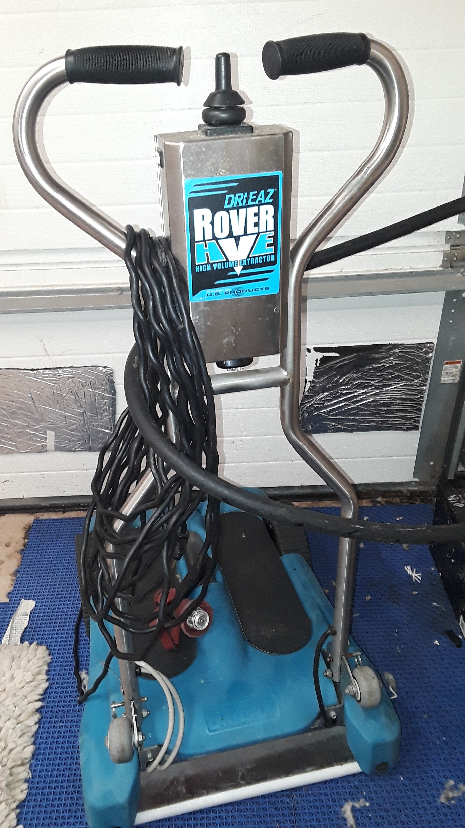

Lots of COLD water, a Cimex, An 1800 psi pressure washer, a garden hose and nozzle. An extractor of your choice-- since you don't like mine.
a dri Eze Rover. Pro'd choice HD odor kill or Centrium force U-Turn. I tend to use a citrus prespray for soil suspension
