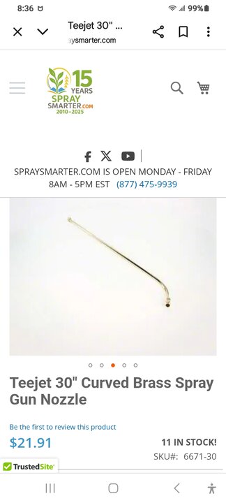

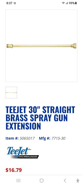

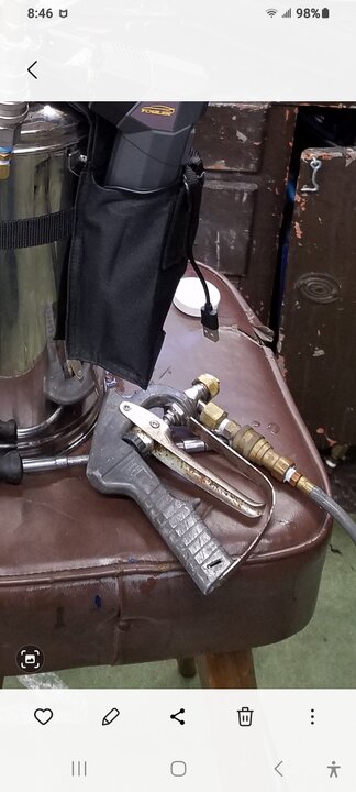

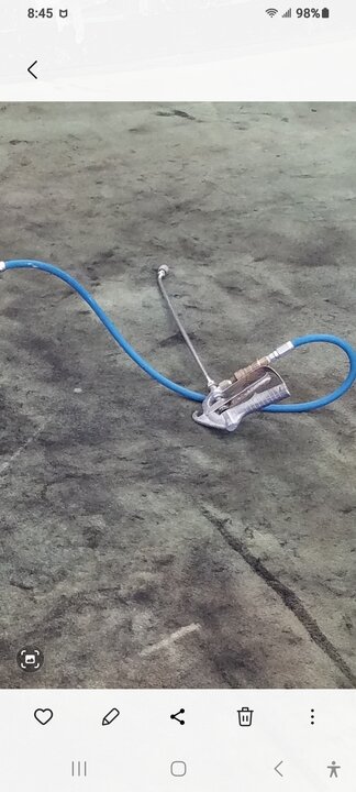

I hate all those plastic guns i went to the metal guns that came on the original hydroforce models when they first came out. They're made by spraying systems and last a very long time without any maintenance or problems for those of you whos business plan is to make 250k per year on a 1,500 investment, perhaps these are not for you. But anybody looking for a quality product this might be it . Wands are sold separately and come in 20,24 or 30" curved or straight they ues tee jets and the wand will also hold a ball check and unlike some of the guns and wands available this one is comfortable in your hand. I also use um on my upholstery sprayer. I prefer the 30" curved and i straightened it out a bit to fit me ergonomically

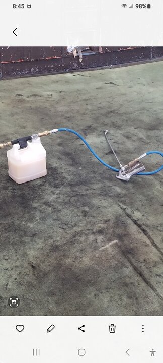

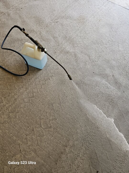

You swing that whole jug around??? My wrist and shoulder hurts just thinking about it. Tahe an old male& female quick connect. Use a punch or big ass nail and a hammer to Knock the guts outa them so there a hole straight thru mount female on the hydraforce and the male on a 3 or 4 ft hose mount your wand on the other end and quit playin around........ your welcome
