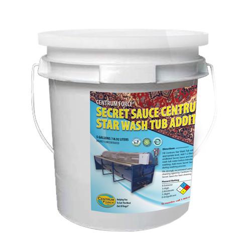

@T Monahan is secret sauce available to non wash tub owners at this point?
Has there been any use of it on the wash floor in any capacity?
It can be bought in 5 gallon pails. One quart product to 1200 gallons of water in The Wash Tub environment. Some have used it in soaking tubs much smaller. https://www.centrumforce.com/products/secret-sauce-additive-for-dye-bleed
