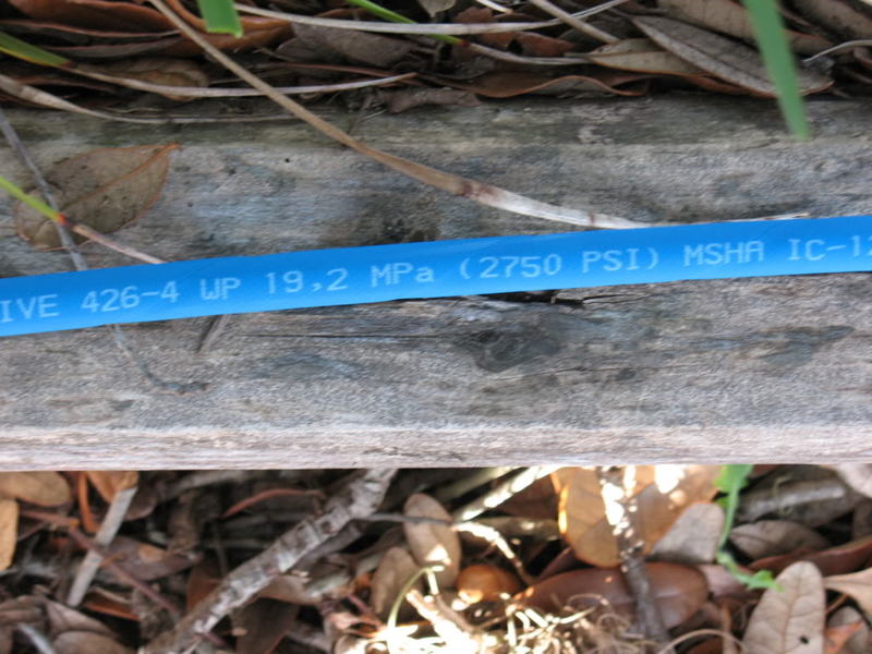

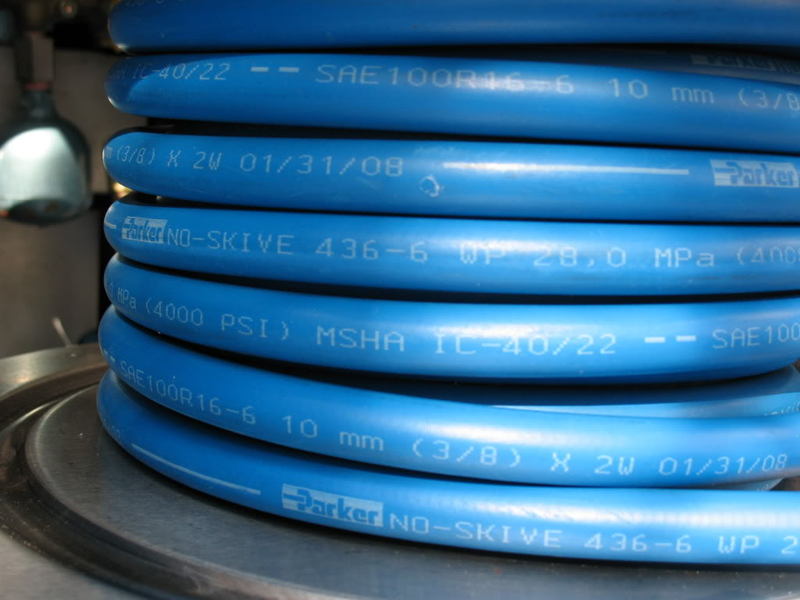

Greenie (well, Lisa really) was kind enough to send me a hose to try for them that was quite an upgrade from the 3/8" goodyear that came with the truck.
Parker 3/8" 4000 psi (a little overkill for a 3000 pump) - no problems at all so far.
Parker 1/4" 2750 psi and 305 degree rated. Had 200 ft of parflex but I fried it one day when thermostat was at 325 before I realized it. Hose was smoking and not from the steam. Used it the next day and hand dozens of pin hole leaks throughout. It ain't cheap, but it better last.

how are you finding it for flexibility?
I'm using the Tornado/Alpha hose more than my Parflex simply because I don't like having to belay(coil) the Parflex. The T/A hose is very flexible thought it does get hotter than the Parflex and it has a rougher skin.
The ideal hose would have a skin as smooth as the Parflex, and interior that would never rust or cause black death and the flexibility and specs (300+F and 3000psi) of the Tor/Alpha.

Boazcan;
I would not use that rubber wire-braid hose much over 200° for water.
The higher temperature rating is for hydraulic oil service.
Larry

Larry Cobb said:
Boazcan;
Larry
Ignorant on your post here. What difference does it make on the liquid being transported through the hose? (within reason)

15 flow, likewise. Dual wanding a lot with 2 - 15 flow wands.
We are going to use that hose combination to improve/expand our hard surface work. We are going to work on doing some more paver work. We utilize a hyperturbo that can take 4000 psi.
I have had several pin hole leaks on the old parker at the crimps over the past year. I have had the 3/8 neptune replace by the new 3/8" parker for all the guts in the machine. That thoroughly improved heat and water flow. The steal crimps were rusting anyway and connections were frozen from internal rust.
