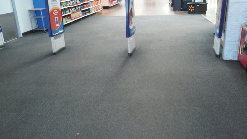

I'll be doing it next week. The carpet is 10years old and has never been cleaned.
What would your process be?

Saiger" data-source="post: 4444000" class="bbCodeBlock bbCodeBlock--expandable bbCodeBlock--quote js-expandWatch">Those are pretty tough to do actually...well to get clean after so much abuse....
We run into the Salt staining and remaining salt problems if we ever get a call to clean one...and after pricing and talking with them, they eventually get someone cheaper....have them attempt (and that company loose their shorts on the deal) then end up replacing the carpet in that area....
Then couple years later....repeat of don't get a maintenance program....try to hire someone cheap....they fail (and I would as well) and replace the carpets within two years.
To clean this is going to take quite a bit of work...and sometimes the sand and soils still get pounded down past the carpet squares and underneath.
It is going to take a lot of prevac (a lot) probably CRB and trays to try to get more soils out....a Zipper SS Super Spinner would give you a great chance, but with a wand, just going to have to take your time, would try to maybe post pad, but speed drying would be a good thing....
But in seriousness, you might not be able to satisfy anyone in this job with them being left too long. I would just do my best with a good cleaner with some PH, and tell them it might not ever get back to looking perfect. (and in your mind know it will not)

Cimex with quadruple strength juice.
Post pad
You'd be nuts to HWE it..
I'm gonna be nuts, because I don't have a cimex. So I'll attach some before/after pics and a time on how long it tookCimex with quadruple strength juice.
Post pad
But I am gonna do a Post Pad with a white bonnet/green stripes after HWE. I'll use that Hydramaster Encap stuff that I won on here

That is a tough one Matty, I'd hit it with the big guns.... Pile lift the crap out of it, vacuum the crap out of it, HWE the crap out of it, Post pad the traffic areas, then Encap the remaining crap....
My wife's aunt is one of the managers there, and she was the one to call me and ask me to come do this before management top dogs come in a couple weeks.Naah...that job's gona cost ya....I don't know how hungry you have to be, to get in on a major Walmart traffic area that has never been cleaned.
lol...don't think for a second that an acid rinse will help.
Dude, I'm telling you. Go rent a Cimex from Jon Don. You'll be done in the time it takes to unload all your HWE tools
