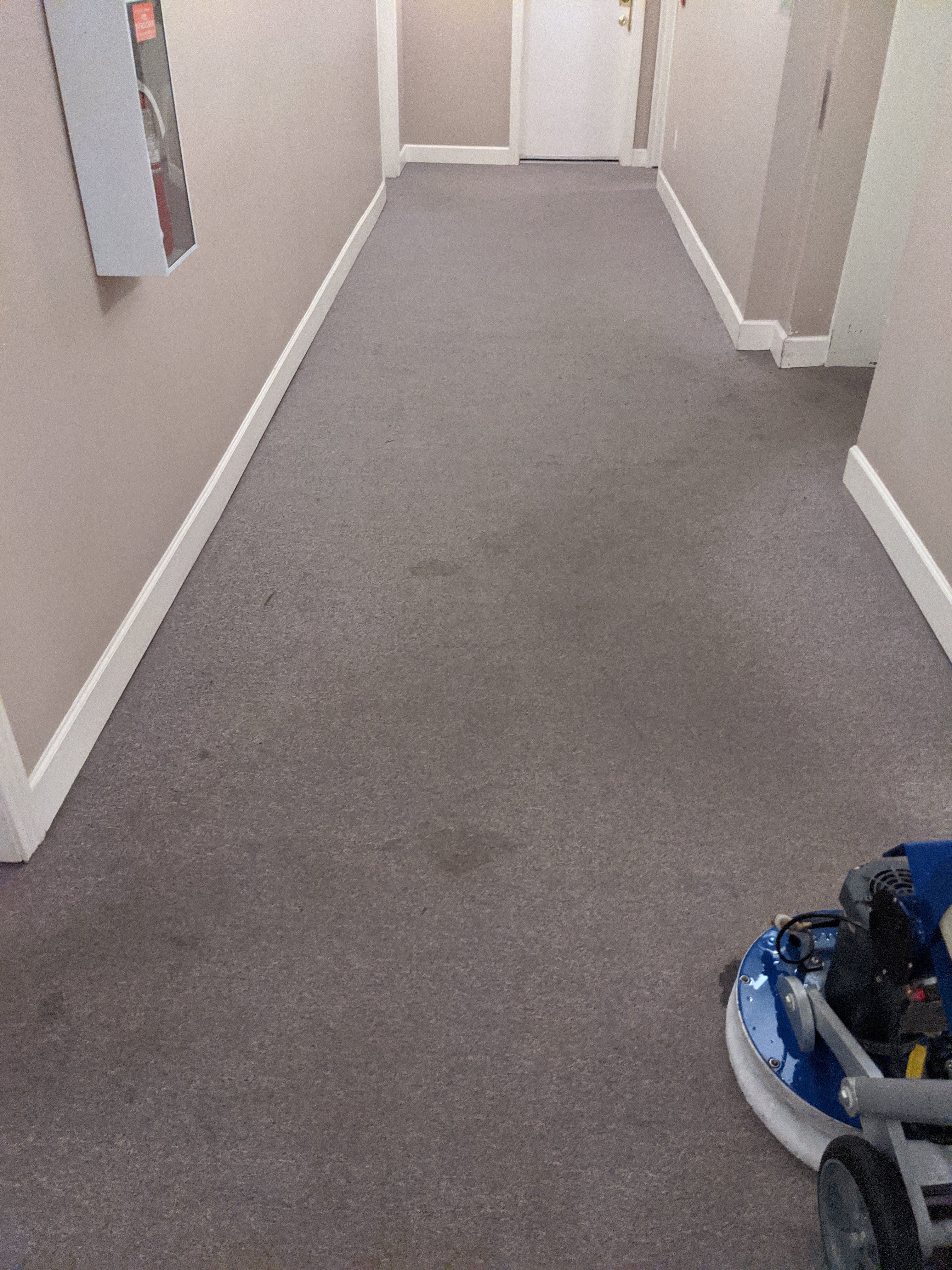

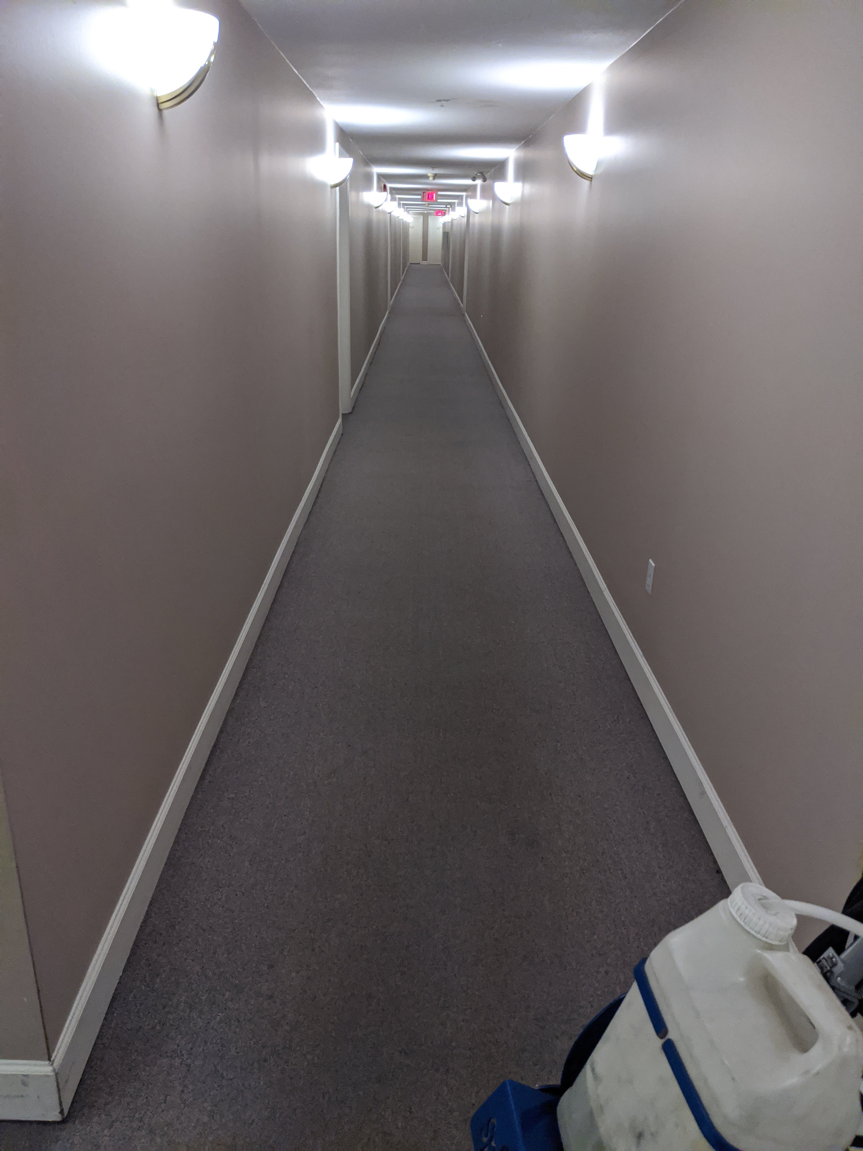

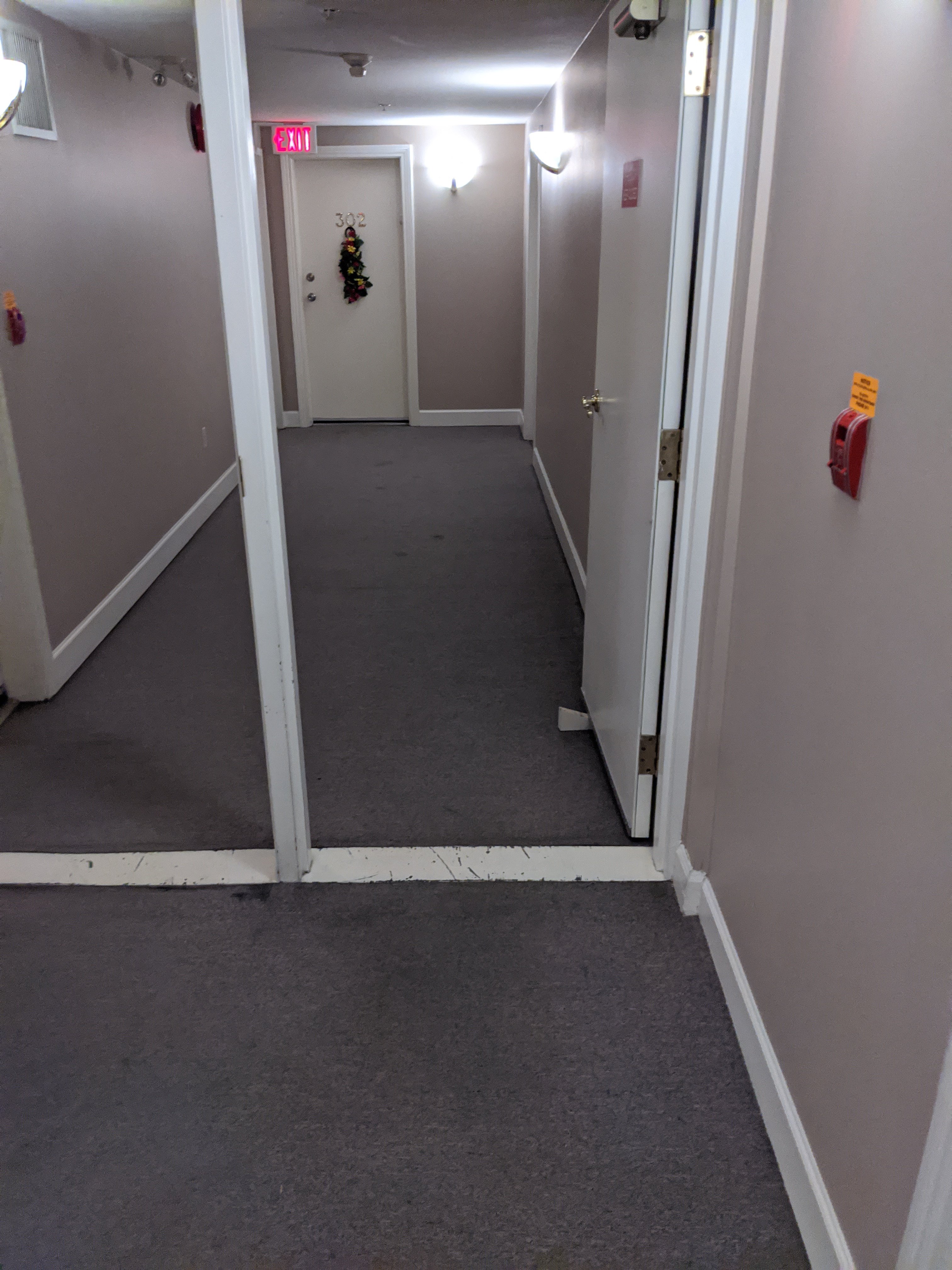

Here is a pic of one of the 4 hallways I did today. At each of the hallway is a stairwell. Aprox 180 stairs and landings. Used the sprayborg for the hallways and the Oreck for the stairs. It was absurdly easy to clean the stairs with the Oreck. Spray a section, plug in the machine then slowly let the machine fall over the bullnose. Sweep back and forth a couple of times and it's done. Best tool ever for bullnose. This job normally takes 7-8 hours with 2 men using the truck mount. I finished in 5 today by myself. The strata president was watching for a good part and was thrilled by how clean the carpets came. She was happy she didn't have to sit by an open door all day too.

Can you post the before pics?

I know I buy too much stuff but most of it makes me either a better cleaner or a more productive one. I forget what I charge for the job I did today, I'll have to look it up but I think it's between $1200-$1400. The carpets are past the point of being steam cleaned anymore. The floors are just too uneven. Having the ability to encap and even encap the stairs is a real bonus. This building isn't looking at replacing their carpets anytime soon so if I can keep them looking good for a few more years, they're happy. So today I made over $200 per hour doing easy labor. The Oreck was so easy to use, I'm surprised I haven't seen more people using them. I have some other buildings that I have been using the truck mount where I could be encapping because of not having anything to effectively clean the stairs. The Oreck changes that. It was well worth the money.
