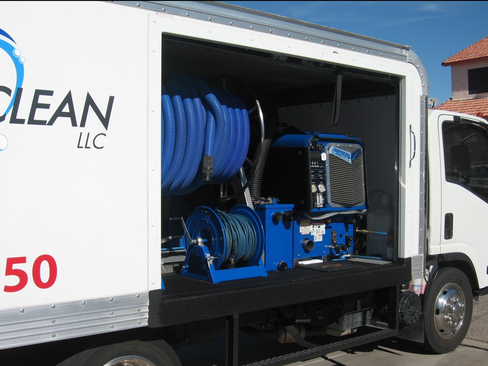

Those were great machines.
Everyone kept saying how complacated the machine was.... My 570 was way more complacated to work on... And we had pretty much just gave up on that therm valve...........We ran a A. P. O. on all the jobs so we just let it go... Everytime we replaced it.. That water box would just burn it out... It was always blowing fuses on the automatic hose reel or A. P. O.. and shorting out a float valve now and then.. ... That Thermalwave... It didn't matter how hard you ran it... It just kept going....very easy to service.. Lots of space to get to anything and work on it... Shame they stopped making them...

It's a 47. I think the DDS may spin at a higher rpm. Sounds like it. I like the idea of that machine but I have had good success with the CDS. Hydramasters is just across the border from me and I have 2 distributors near me. That's probably the way I would go if going new.
It's got a 4.8 same blower as the peo1200se.
Heats better from what I hear on par with the butler high heat.
