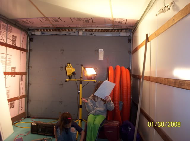

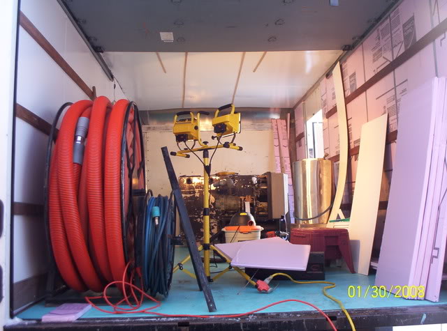

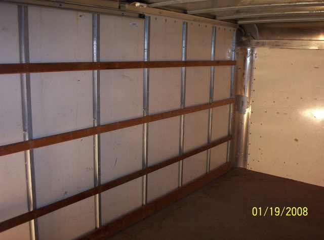

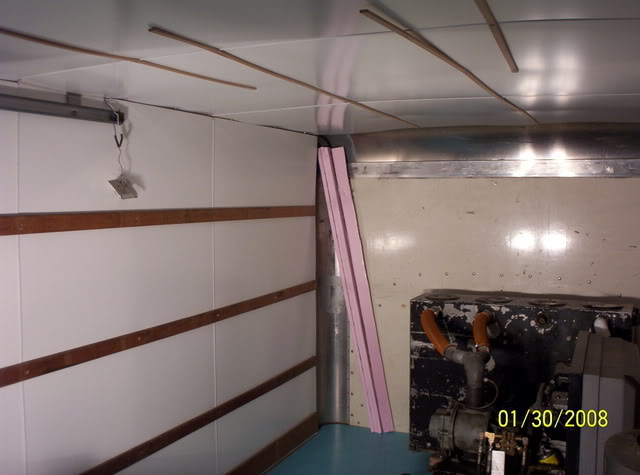

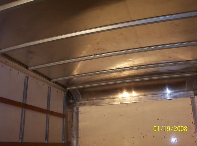

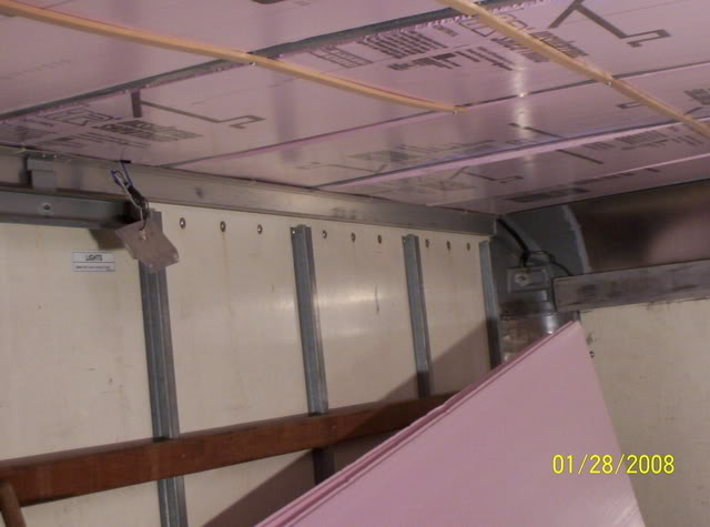

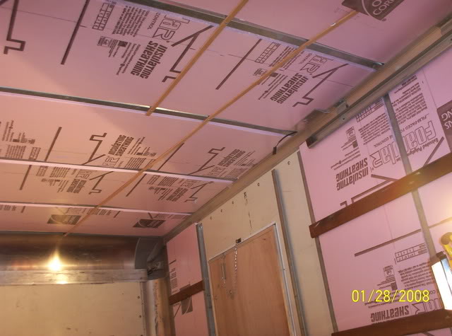

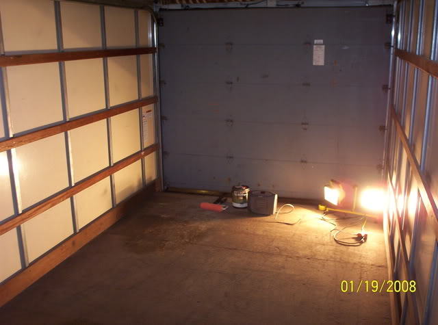

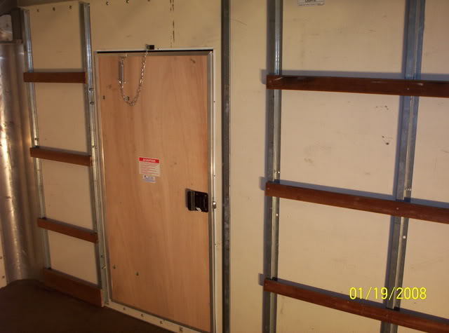

ok after long enough time here are some before and after of the inside...still needs some stuff done..

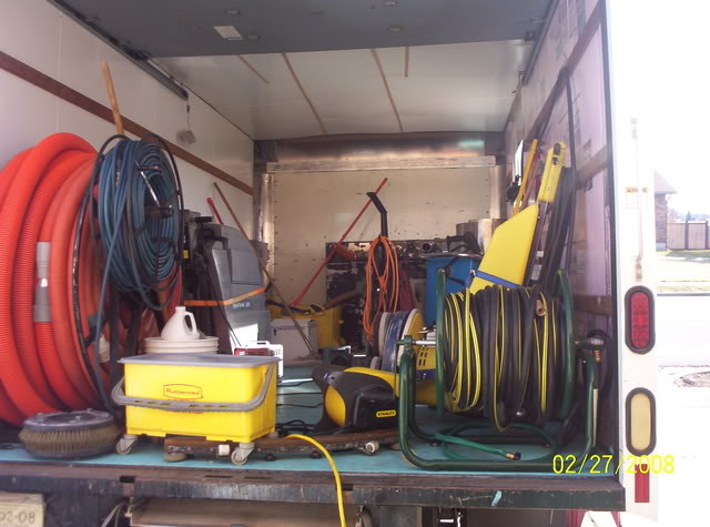

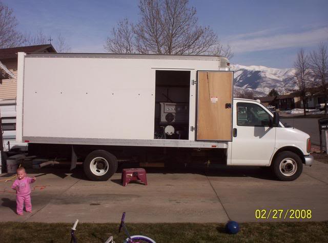

also a few of the out side and with it loaded...YES I KNOW I NEED SHELVES!!!
lip they left when they cut door, bugged me at first, but gettin use to it.

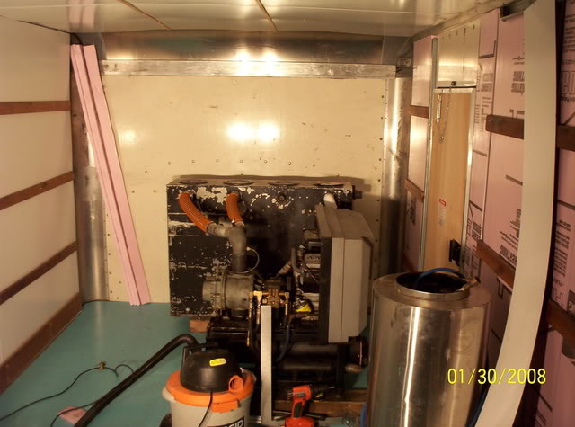

almost full truck...26" autoscrubber, 27" burnisher, cimex, old porty for prespray, misc, chem boxes and crate, hose reels, propane burner, and the TM...and still plenty of room for a fresh water tank, and other equip as needed...

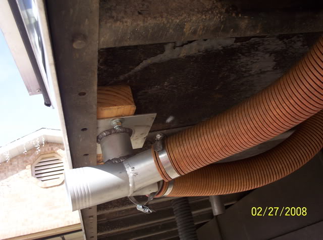

my 2" to 2.5 hook ups...looks like the big boy trucks :wink:
with side door open, and of course a helper to tell me what i did wrong
side closed, had the door put in when bought $500 instead of 1000-1500..and shes going down...first few times shes been out side and walking..those down hill drive ways are a bitch :lol: :lol:
hack exhaust hook up I talked about before :x
the 2 2" going out for the 2.5" hook up, and the drain valve
stock interior

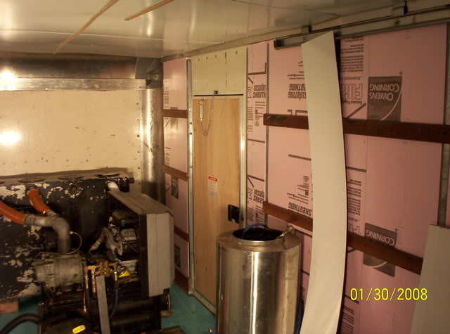

partial insulation

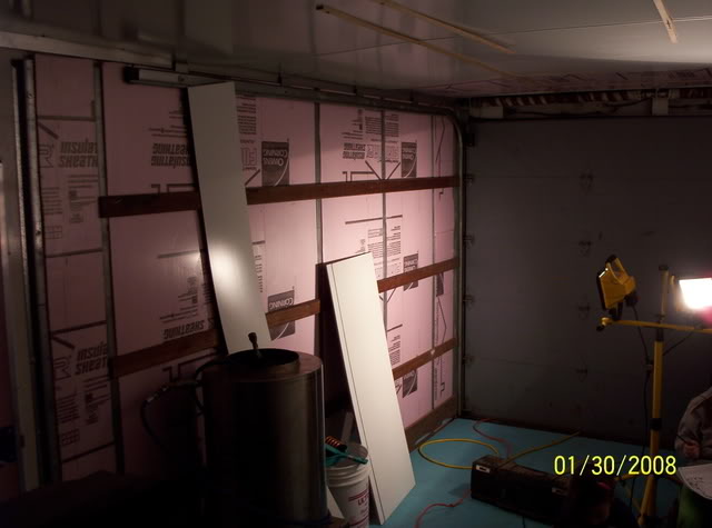

sidewall up
well there it is for now, need to finish other side, get some 2x4s and 2x8 for new anchor points, make a shelf like in my trailer (ill post that pic later) get some hooks up, and put a nice looking wood trim on the roof, its to heavy to hold up with just screws, would look like crap...

Looking good. Some of the V guys should look into that insulation.
That round stainless tank, where did you get it?. Does it hold up under pressure?
Albert
floorguy
Nov 7, 2006
6,948
Doug
Albert, that stainless tank is the propane heater for the TM.. It works up to 4000 psi I believe..It is from silver eagle http://www.silverhawke.com/carpetcleaner.htm
The guy I bought it from put a new engine one in at around 200 hrs, it now has 920 hrs and it went down in the fall...
So I said bag it I have the big boy heater, and i only kept the blower one to
A. take the chill of the water before it hits the burner
B. I am guessing it is part of the silencer stuff..and I really dont want to mess with it now...Maybe a engine side exchanger and a new blower later..or a new machine..

what are the box walls made from?
What was the material you sided the walls with?
I'll be fixing up a box similar to that in a couple weeks.
floorguy
Nov 7, 2006
6,948
Doug
The interior??? is like 1/4" coated masonite...I think is what its called
exterior is fiberglass reinforced plywood FRP I think its called..
The insulation is the pink stuff from home depot..this is the 1" thick stuff they have 3/4 or 2" as well...the 1" has a R-value of 10
I checked lowes but their selection sucked something fierce
