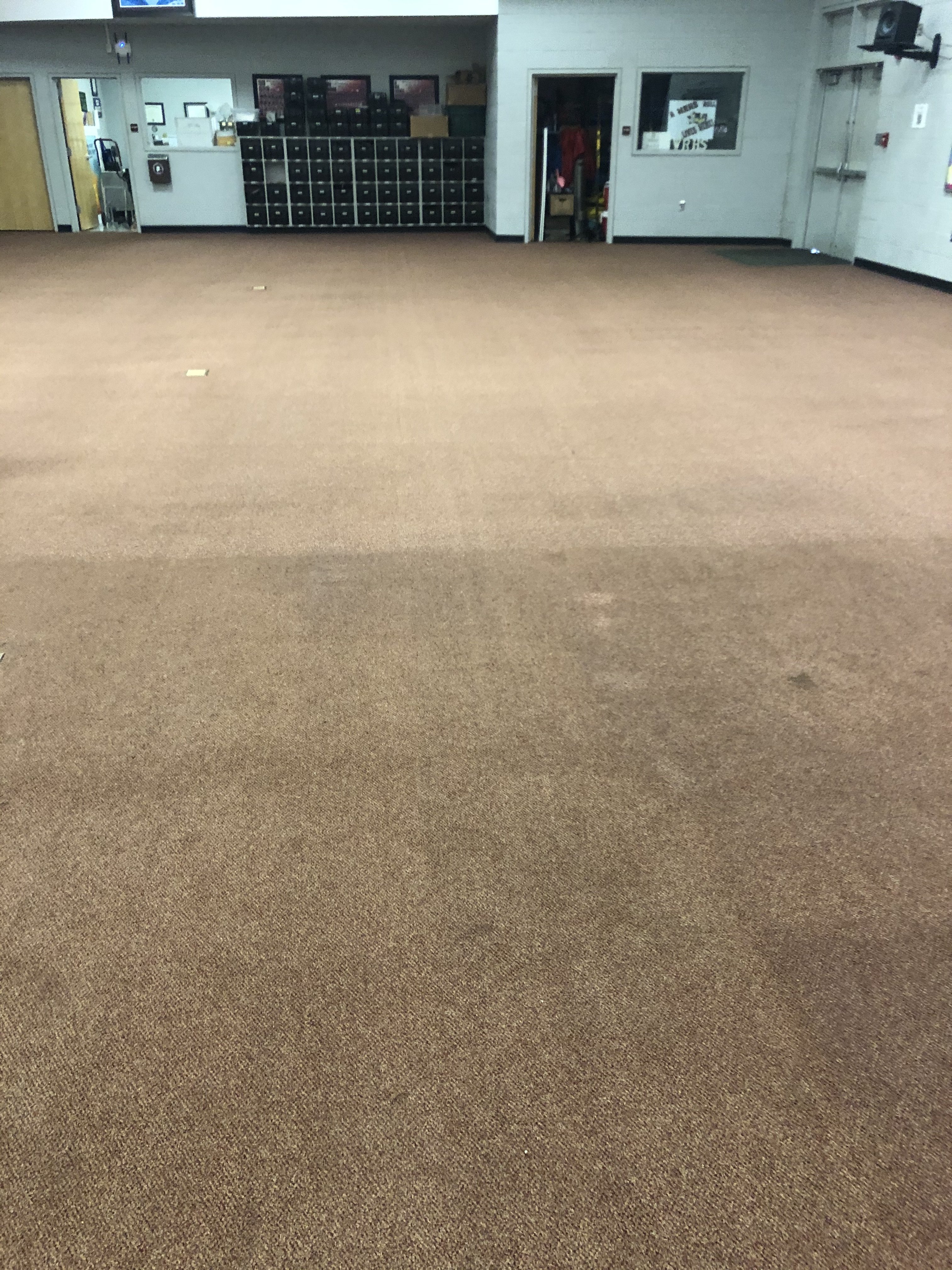

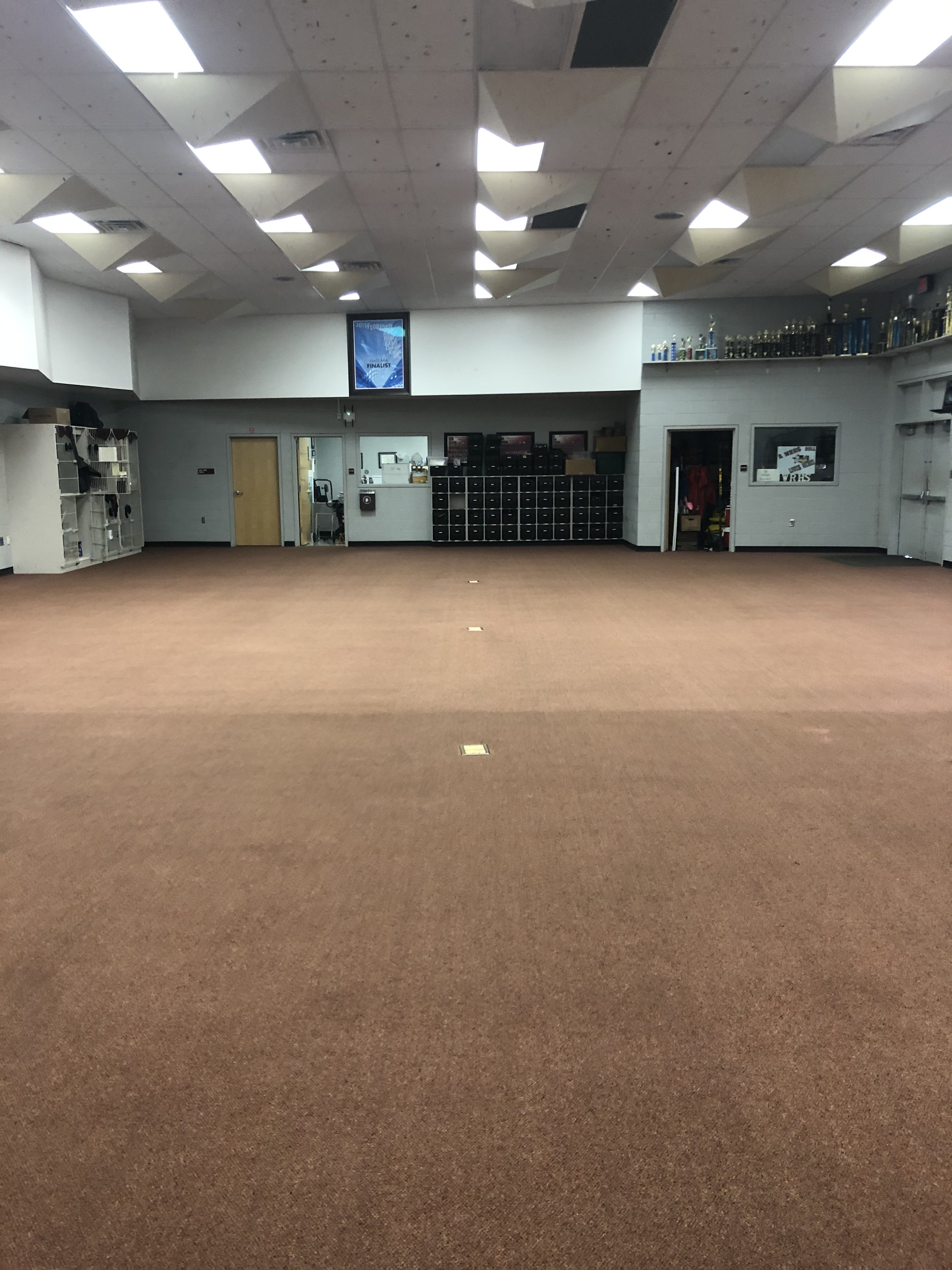

I had a crew do a job today. A school to be exact. And in one of the room the maintenance department previously used Host GVX and Host SJ on half the room. The crew used out strongest Butyl Commercial Pre-Spray, scrubbed with a CRB and extracted at 600 PSI with devastators and couldn't get the 2 half's close to matching. Our half didn't look nearly as clean and/or light as the half the maintenance department had done. We're going back later this week to encap. it to hopefully get it more uniform. I have a couple questions hopefully somebody can help answering.
  1. There's the old "where's the dirt go?" joke.... but in all seriousness, without a thorough extraction, there's no way in my mind that Encapsulation can get carpet as "CLEAN" as Encapsulation. That does not, however mean the end appearance is superior. That leads me to believe encaps. have superior chemistry that make the carpet "look cleaner". Is this true?
  2. Assuming the answer to question 1 is true, what EXACTLY do encaps. do to make the carpet appear cleaner? (ie optical brighteners, oxidizers, reducing agents, etc...)

Skip all of the supposed theories. Encap is a shampoo that leaves a light-reflecting residue on the carpet. The residue does not attract soil because Teflon has been added. There's no "crystalizing" and no soil removal except what is removed by pre-vacuuming and what happens to stick to the applicator.
It will absolutely make a carpet look cleaner though.
Industry accepted practice is to encap no more than three times before extracting residue and packed-down soil. Otherwise you risk a build-up that will eventually start to attract soil and can't be removed for less than the cost of replacing the carpet.
As to this job, something is fishy.
The "maintenance department" made half of a filthy room look great using Host, and then left half to be professionally cleaned? Nope.
I'd ask the maintenance guys to do a little demo of their methods on the dark side. I'd guess they can't get the carpet clean, which is why you were called.

as has been mentioned, something is fishy
if their guys can get it looking good, why did they call you?
I cant tell from pic on my ph, it's not something as simple as a join with 2 different aged carpets?
Whats it look like from other side looking back?

Take a look ad see if there's a seam there. It looks like a different dye lot.
