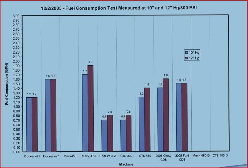

when a jet is going cruising speed at 30,000 feet, it's more economical. So just becuase it's going faster now than at takeoff doesn't mean it's using more fuel and more power, it actually using much less power and fuel.
T
TimP
When you run 2.5 hose your level of HG ATM is LESS.....BUT the level of HG ATW is higher due to less restrictions (less drag or friction).
When you figure how much fuel is going to be consumed you look at what the machine HG is.
What uses less fuel 2 HG ATM or 11 HG??? clear answer 2 HG. Also every fuel usage chart I've seen for TM's an HG rating related to the consumption. Like the following
Real world 14-15 HG or 11-12 HG. I would say 11-12 HG and that's what people are seeing as a difference when using 2.5" hose vs 2" throughout. It's not a difficuilt concept as Rex has stated. If you can'g grasp it or don't believe it.
Run a test yourself!! Don't start telling people how it is unless you have tested it and that's what gripes me most about what you're saying Larry. Bring us some proof!!!
