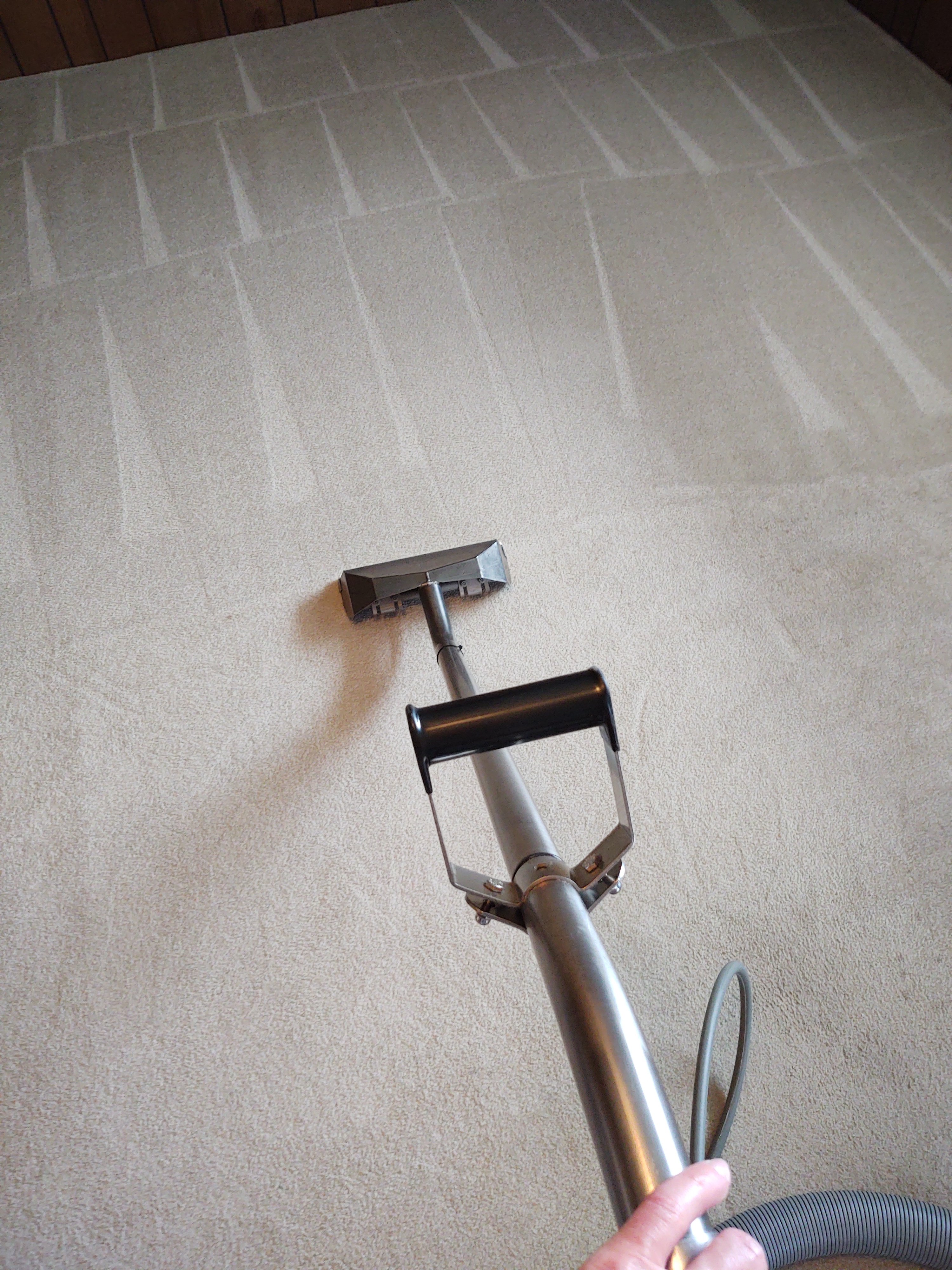

A lot more enjoyable in residential today. Flat glide much more forgiving on cut pile. Still not a fantastic wand, but it's getting the job done.
