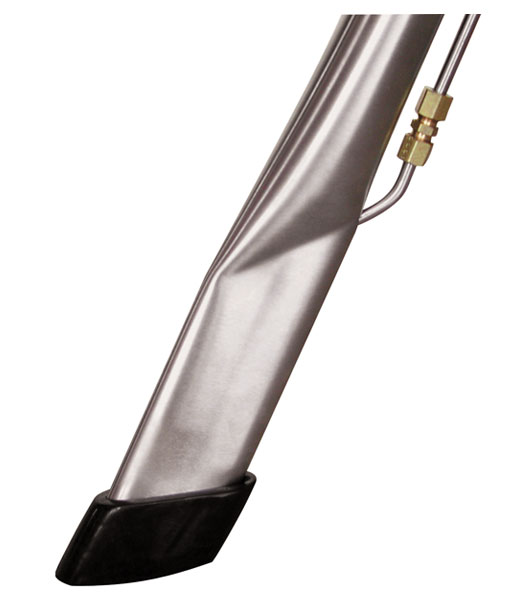

PMF called yesterday, they are sending me a new HS wand to test..
What I like:
12" head
Swivel
Narrow vacuum slot
Vacuum tube not blocked
Killer tufted brush ring
S bend
1.5 tube
Built in M'erica
Concerns:
Confused airflow due to internal jetting
Price

Bob look inside close and you'll see that the 11 inch long spray bar is now been cut in half, totally unobstructing the vacuum port

Which has a cavernous vacuum head in comparison to the pmf the only Tile tool that doesn't use the big wide opening dry floor tool design so I have my hopes..
Problem with the gekko tool is with the squeegee head, it locks down so you can't move it. With the brush head, it doesn't remove enough water. Hopefully the pmf is better. I don't have any problem with the internal jets. At 1000-1200 psi, it won't be a problem and it will help to contain the over spray. It would be nice to have an automatic vacuum relief if it locks down. I just don't know how easily serviceable those jets are.

Unhook the brass barrel nuts and the whole back plate comes right off and let you easily service it.. you nerds are way overthinking this
From what I see:
Unhook the nuts, back out screws (including on the brush frame), deal with loose brush frame and plate and manifolds, back out jets, clear jets, hope manifolds are clear, but everything is apart so no way to check, reverse process, get everything back together, get back to work...
...jet plugs again 5 seconds later.

Getting back to the subject..
This has the narrowest vacuum chamber of the all.
Narrow is best, narrow increases recovery.
When Conway and I tried to work with pmf to design a new HS wand, we thought having the jets in their own separate chamber would be best. Unfortunately that tool never came about.
Who knows, this could be good enough...
We'll see next week...
