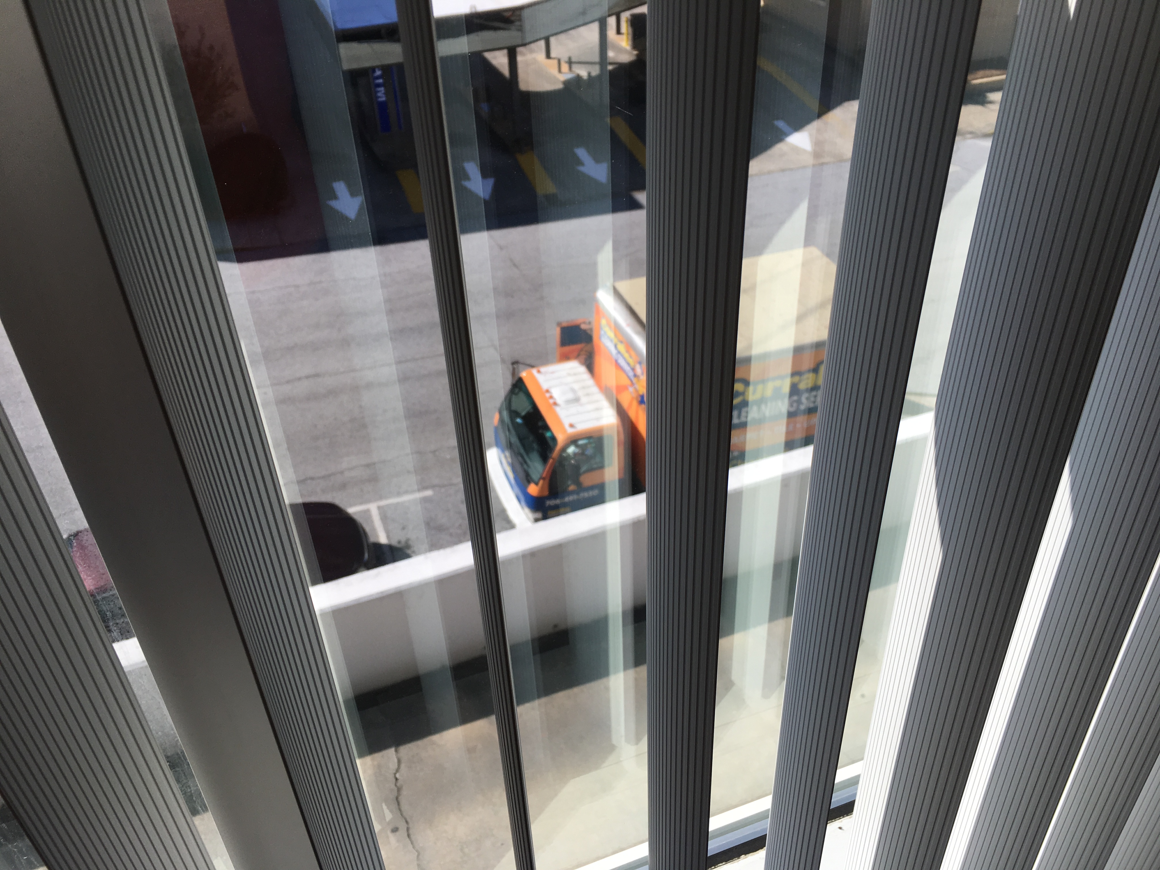

Did a job today that I thought was applicable to your post. We do not have any BIG AEROTECH STYLE TRUCKS but have multiple standard size Truck mounts. If making long runs (250’ - 350’), I will schedule, if possible, 2 trucks per wand. Run a 2” hose from each truck maybe 100’, then “T” it to a single 2” hose for the remaining distance. I don’t have an Aerotech to compare to but I think something like this gives you more flexibility for the same money.
Standard days, run separate routes, but when you need the power of a larger truck, just combine them.

Roots 56. I used 2 trucks because each carry 300’ of vacuum hose. If I need a 300’ run and I want to run 2 -2” hoses 100’ i’ll need 400’ of hose.
I’ll have to take 100’ of hose off a 2nd truck anyway. I hate having extra hose just laying on the floor of the truck and the 2nd truck had already gassed up and was done for the day at 1 pm when the crew went to the commercial job.
The truck was available and rather than taking just the hose and running 4 to the door (yes are vacuum tank lids are set up for this) we just took the truck and hooked them both up. I’m not a physicist but I have to think that creates more vacuum and CFM’s than the same hose run hooked to 1 truck. @Hack Attack
