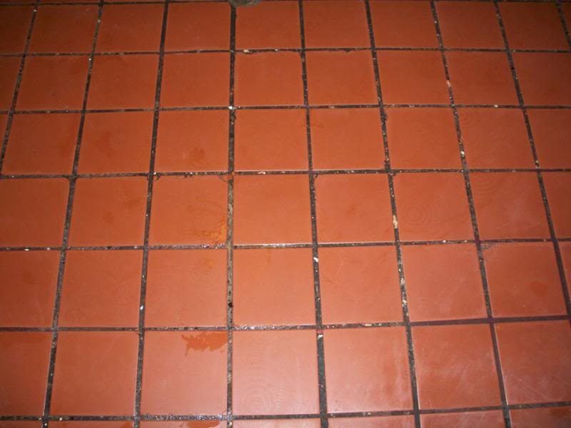

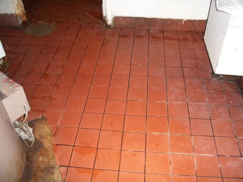

this places has not been cleaned in about 10 yrs..i really am not sure why i even took the job??
i used strong mixed powermax with a full scoop of powerburst..brushed with a 175 using the 3m grout
brush ring and then followed up with the hand brushing..it looked better but i still have what looks like
grease pushing through the grout..it looks good then after a little time it gets coated again, by little
time i mean less than a hr.
also the tile has a whitish haze in some areas..i am going to meet up with them on tues but i am sure
the hazing is wear in the tile itself..only thing ever done in the past was a hot mop this was the first
"real cleaning" it has ever had.
anything else i could/should do?? also am i right about the hazing?

using a turbo at 1k psi and the truck (butler) was reading 220 at the truck
this is a close up after 2 cleanings..same night
this is the white haze i am talking about..the before and after
i can imagine them dragging things on the floor makes for some nice marks as well..
i love what shows up after it is cleaned then it is something you did..not because it was so dirty
that you couldnt see it before

The white haze is efflorescence.
It's not going to go away as long as you or they continue to get the floor wet. It's mostly calcium and a few other well formulated minerals wicking up from inside, underneath and around the tile. Fact of life when dealing with Terracotta/ clay tiles.
You'll need to use a heavy duty Purple Power automotive defunker to loosen that food in the grout line. Forget the peroxide products
and most likely a screw driver!
You should have walked but if you do get the crud out finish up the job by misting a acid over the floor and buffing it and the efflorescence off.

Wow what a dump. If you wanted experience...I'm sure you'll get it with that project.
I think Mike's right about using a screw driver as the first step. You may want to go the other route, lower pressure and higher heat and see what that accomplishes. It looks like the grease maybe what is holding the tile to the floor.

Crappy thing is once you start taking the grease out it may be blotchy and you'll have no choice other then to get a uniform clean. I'd go with the engine degreaser for sure and even add some citrus to that. If the grout is loose and grease is under the tile and working it's way out then well, their screwed. I'm thinking that they'll probably say it looks ok as it is.
