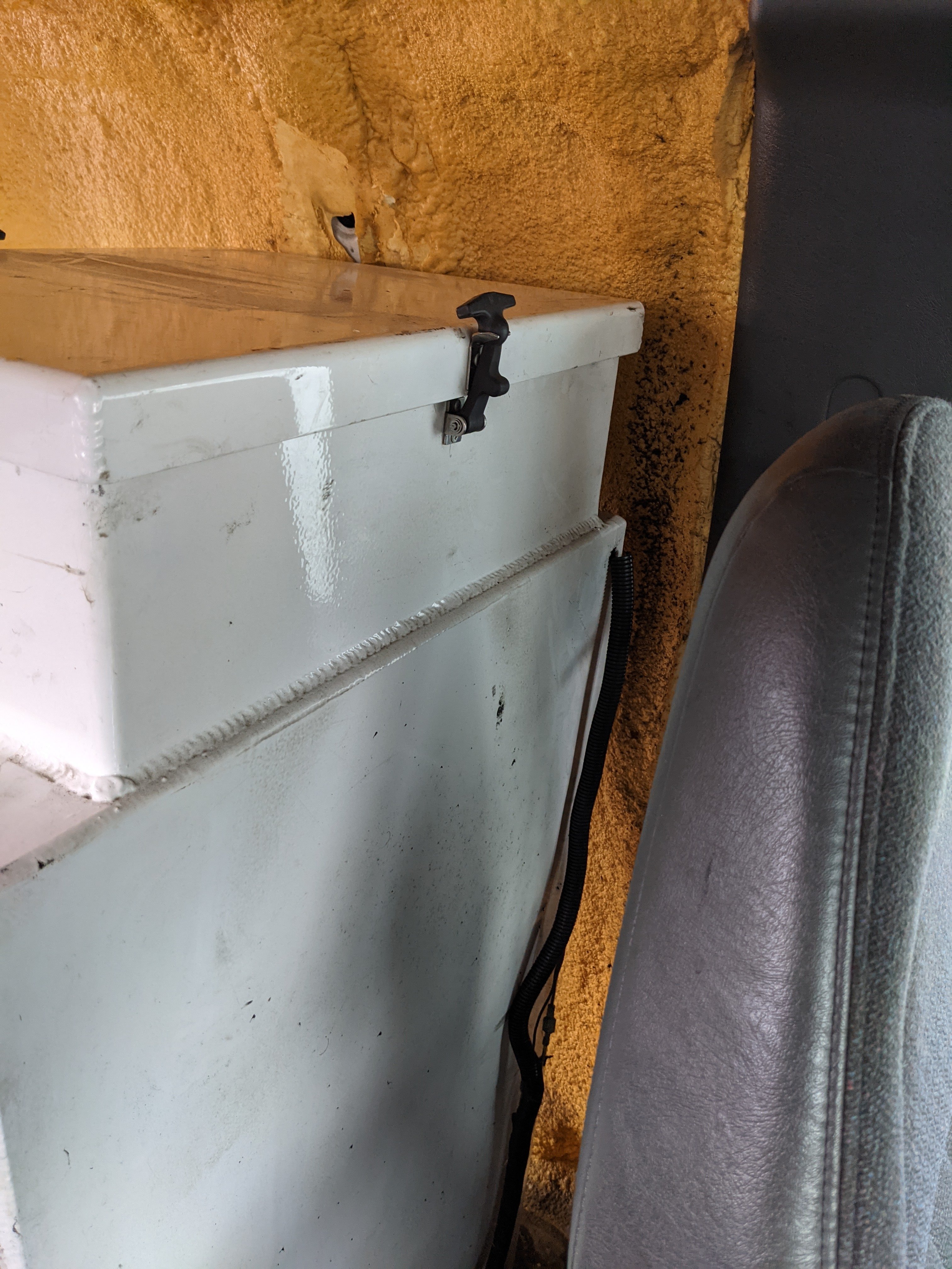

I have a 2002 cleanco 47 that seems to have developed a leak in the waste tank. Filling it up with a garden hose, it doesn't leak. Running it under load, it begins to leak as soon as I turn it off. Anyone ever pull the tank out? Biggest problem seems to be the connecting hose from the blower to the tank. Not a lot of room to move either.

It appears to be coming from the bottom of the tank. That's the problem with the cleanco design. I have maybe an inch of wiggle room from the tank to the wall. Have to take of the instrument panel and disconnect the by pass hoses and sensors. Will have to pull the hose reel as well.
