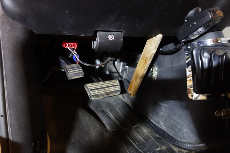

Have you ever run a CDS unit like this?
The Cleanco was running fine for about 5 minutes and then lost power, went out to the van and the Savana was idling. Shut everything down and started over again and the same thing happened after a few minutes. After doing this several times it quit revving up completely.
I have an '07 Savana with a Cleanco Compact 47. The local distributor couldn't get it running and determined it was a GMC issue. The Cleanco throttle control module will only call on the GM ECM for more rpm's if certain conditions are met - transmission in park, parking brake set, can't touch service brake or gas pedal, GM error codes MAY affect operation.
The Savana has had a wonky oil pressure sensor for the last year so the local GM dealer replaced it and could not see any reason why the Cleanco shouldn't run. Van went back to the distributor who cleared any error codes the high tech way (disconnect battery) and was able to get the unit running. Drive the unit home, the next day Cleanco won't run. Van went back to GM per distributors request to check for error codes , none found.

Where you have the ECU hook up there to the left ...the red wire block....
Do you have something else like an after market gps unit hooked up there.
They hooked my gps unit into those wires for power and every now and then, the gps unit searching for signal will shut down my Butler to an idle....
I just have to shut the unit off and restart....but most times it happens....it's when I am on a 3rd floor apartment building! :dejection: :hopeless:
It was not Butler that hooked up the gps there, but our local after market installers.....
Actually had it doing it to my Butler just 2 days ago.
Van was up against the side of a school building, gps getting bad signal, and it was making my Bulter RPM fluctuate....
I thought it was the Blower started to gum up.....nope....gps unit interfering with the Butler....
Jim Morrison
783
jim
There is nothing else hooked up to the ECU block Mark. At Fibreclean now, fingers and toes crossed!

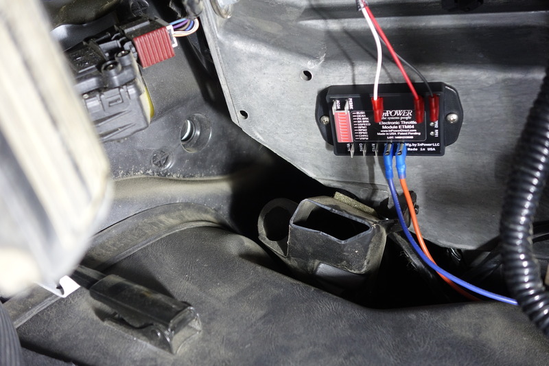

The red plug (in the first photo) is connected to the GMC ECM . That is what a mechanic will plug his diagnostic equipment into when he checks your vehicle for codes. The leads coming out of it go to the Cleanco electronic throttle module. Its mounted above the gas pedal.
Install a push/pull throttle cable to the unit. Infinite speed control.
Not sure how that would work, tying into the efi on the 6.0 litre and running it to the panel on the Cleanco?
We just had to make a small adjustment to the speed of the unit. There are a couple of small set screws below the red cap where the black lead terminates. The blower was spinning at 2450 rpm on the carpet setting. We upped it to 2850.
