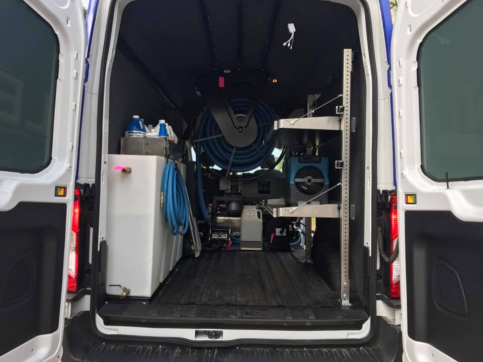

Ceiling mount Prochem reel
117,321
This actual truck will be at Florida Fest in March
Papa John
Lifetime Supportive Member
Aug 19, 2013
7,040
John Stewart

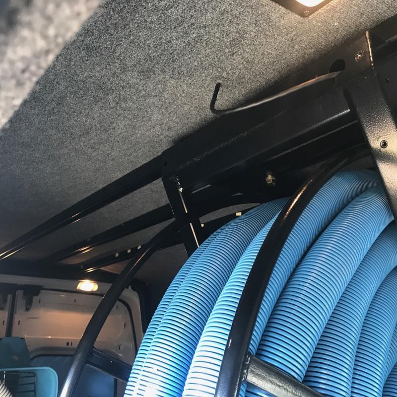

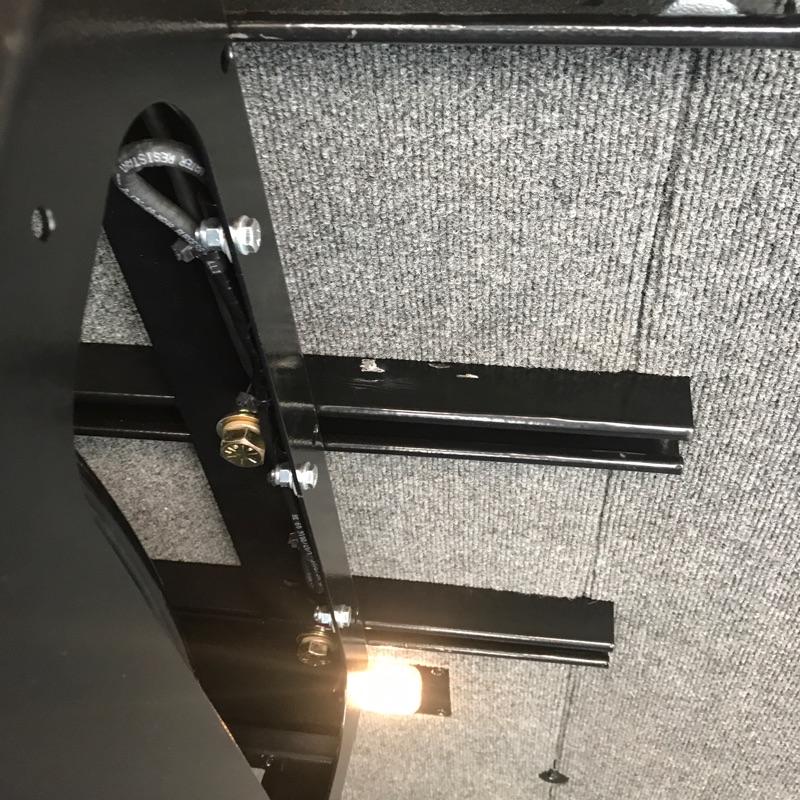

:headscratch: I was expecting to see the solution hose reel on the ceiling !!
I would have thought the vac hose and reel would be too heavy for the roof or mounting bolts.:eekk:
with all the bumps and pot holes in SF streets I don't think this would work for us.:dejection:
Jim Martin
10,877
Jim Martin
I like it...looks like a good space saver......but on the flip side...that seems like a lot of weight to be hanging off the top with no vertical supports to help pick up the weight...looks like they have the channel running across the ribs on the roof.....but all that reel and hose weight is concentrated in on spot...stop and starting...it is going to flex from front to rear...and all the jolting around...unless it is seriously braced and we just can't see it..I would be afraid that in time the roof would start to sag.........
14,634
I've never seen this specific reel up close, but the majority of them are wobbly, due to how thin the skeleton is. If that reel is the same way, just think about how that thing wobbles and sways 1/2 inch constantly back and forth. It looks good, and is using wasted space very well. I'm just concerned about how long it'll last like that with the way we drive our vehicles
117,321
Sapphire/Prochem reels are the real deal. I had one in my Judson set up. Very stout.
