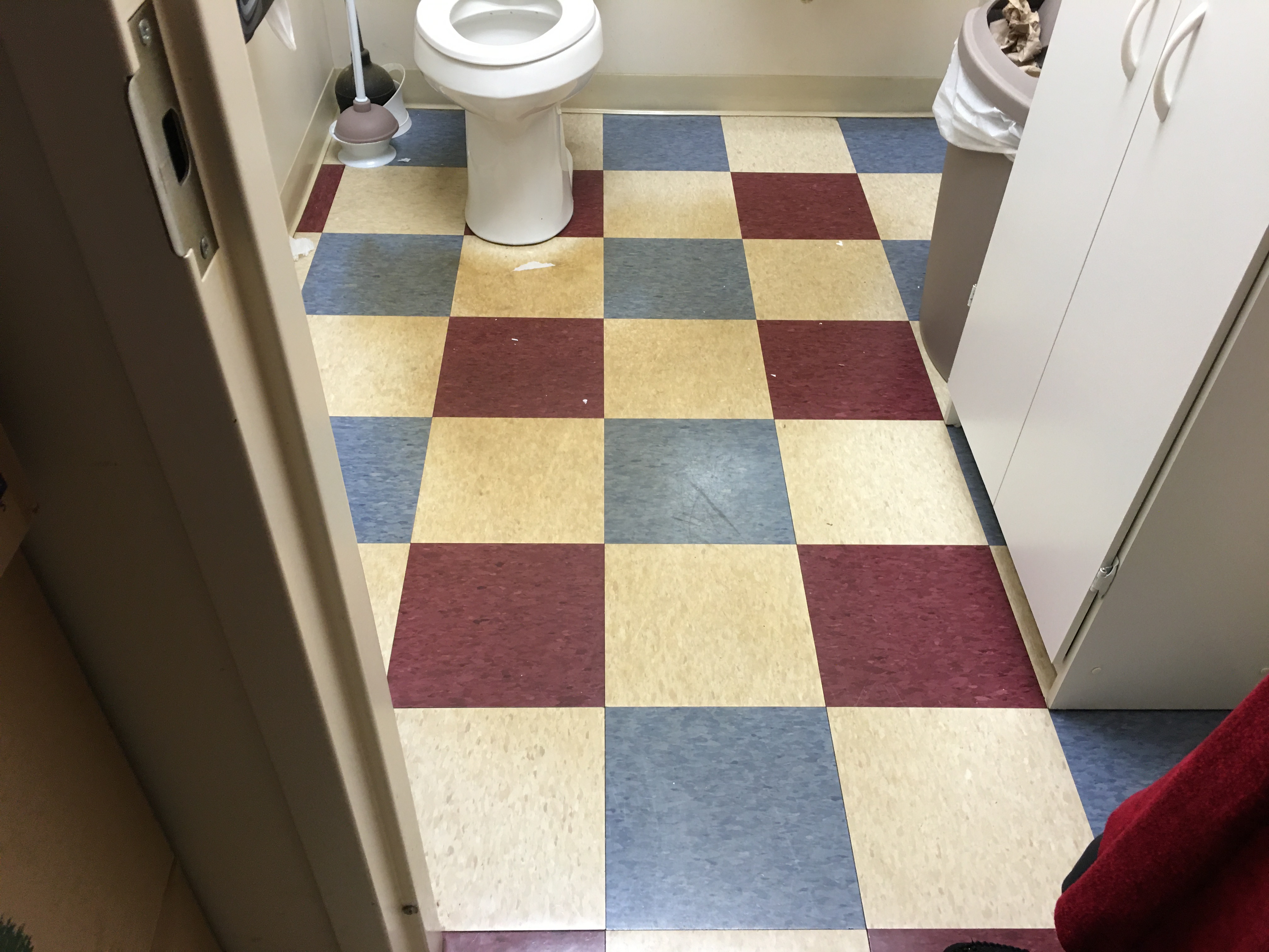

That's a looser all around. Sorry you got into it. I do vct when I have to because alot of my janitorial accounts have it in the contract. I have the right tools and still don't like it. The good news is you learned something. Black pad and a side by side. Or your vibe. Slop the stripper on with a mop, let sit for 15 min, scrub with the black pad, slop some more stripper on, let dwell for awhile. Scrub again. Mop the stripper around again. Eventually, after longer than you think, shop vac it up. I doubt you will get all the way to tile but you can "strip it clean" as some janitors say, lay some wax, and hit the road.
14,630
I don't think it's as bad as Damon's making it out to be. It's freaking restaurant grease on top of some wax, making it look much worse than it really is. The dude used a freaking carpet cleaning buffer OP with a diaper and a red pad. That crap is made to get the encap into a cut pile of carpet...Not breaking up the wax on a grouted floor.
Quit giving Damon advice and tell him to get a good old fashioned 175 and do the job right.
I told him to call a Janitor company and pay them to fix it. He's already lost money on attempting to do it. Now he's gonna go back? Screw that. Pay someone to do it right and go back to work on what you know how to do and start making money again and write it off as a loss. The hell if I would lose MORE MONEY by wasting more time trying to get it clean when I could go make money on my good jobs waiting for me.
You guys gave me hell when I thought about buying a garbage truck, selling vacuums, and probably something else. Which I DESERVED. It slapped me in the face with common sense. Quit rocking the baby's crib and tip his crib over to wake that idiot up.
I love me some Damon, but when he's this stupid, trying to show off his forum fancy OP, he needs to wake up.

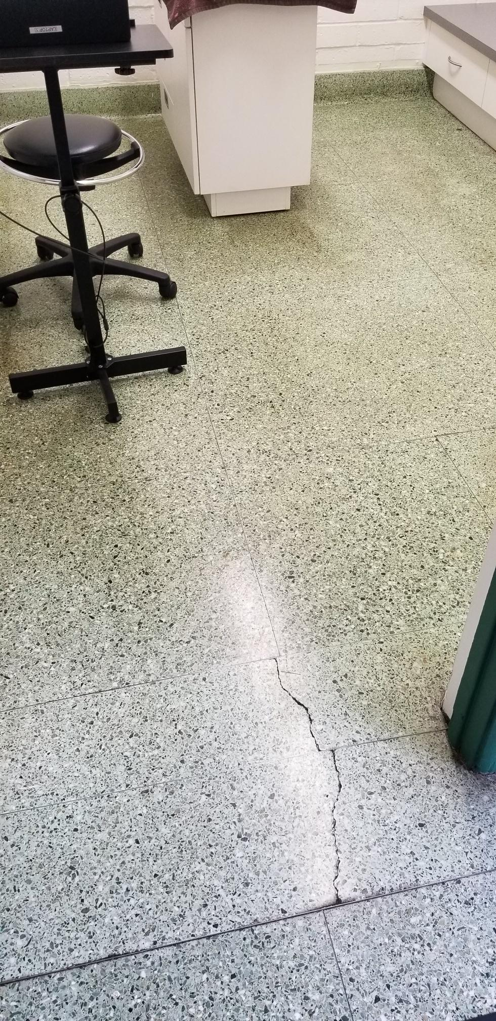

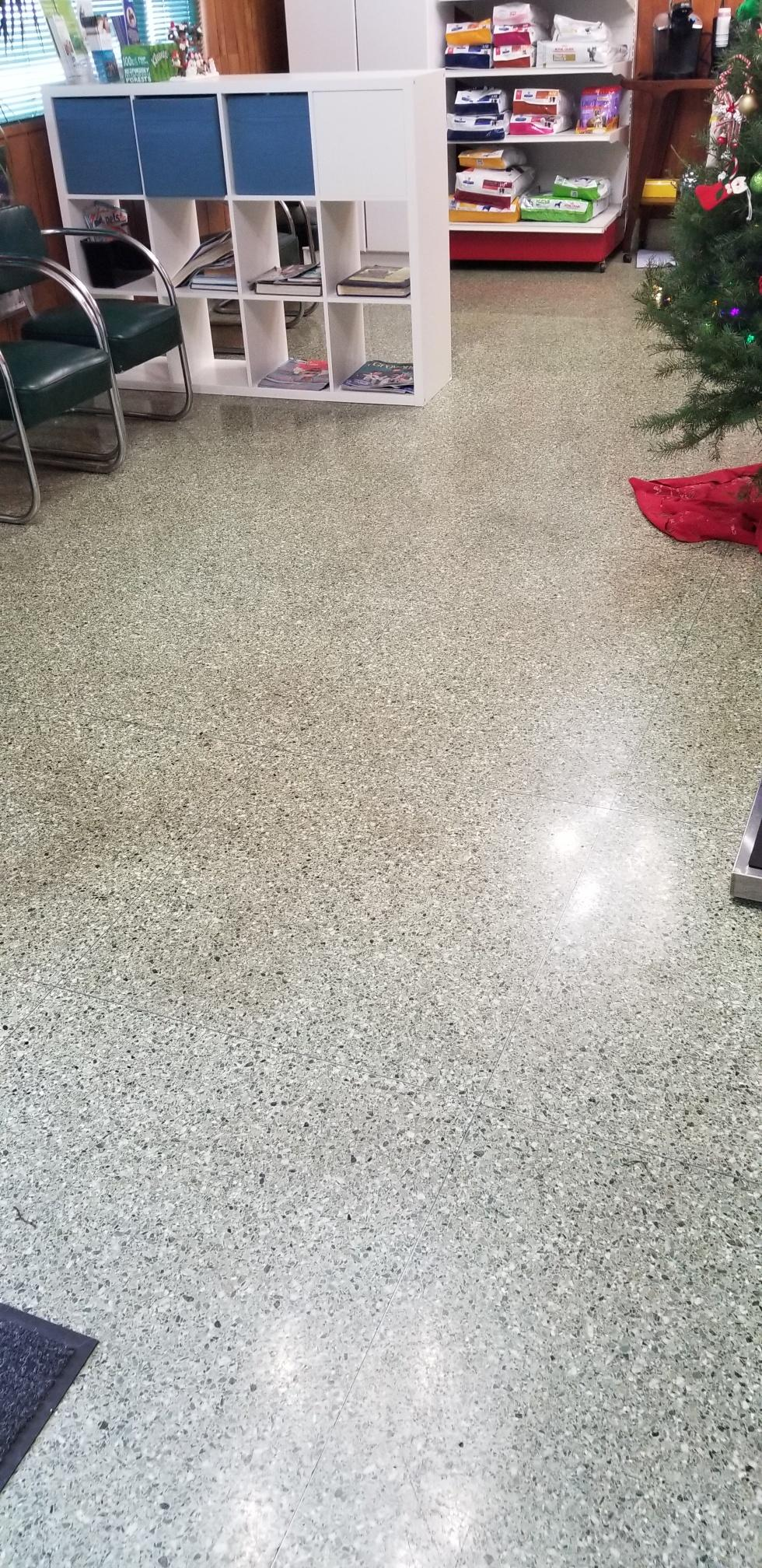

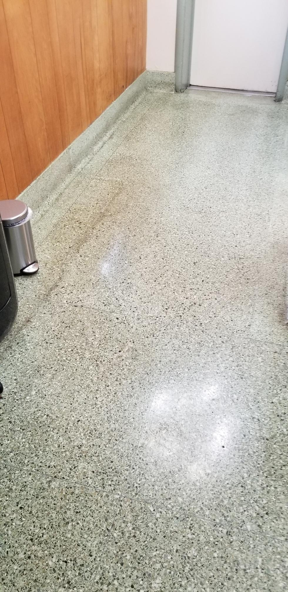

Vet office requesting this to be done on Xmas Eve...
Strip and leave unfinished..
How do they construct those baseboards?

Heat welds

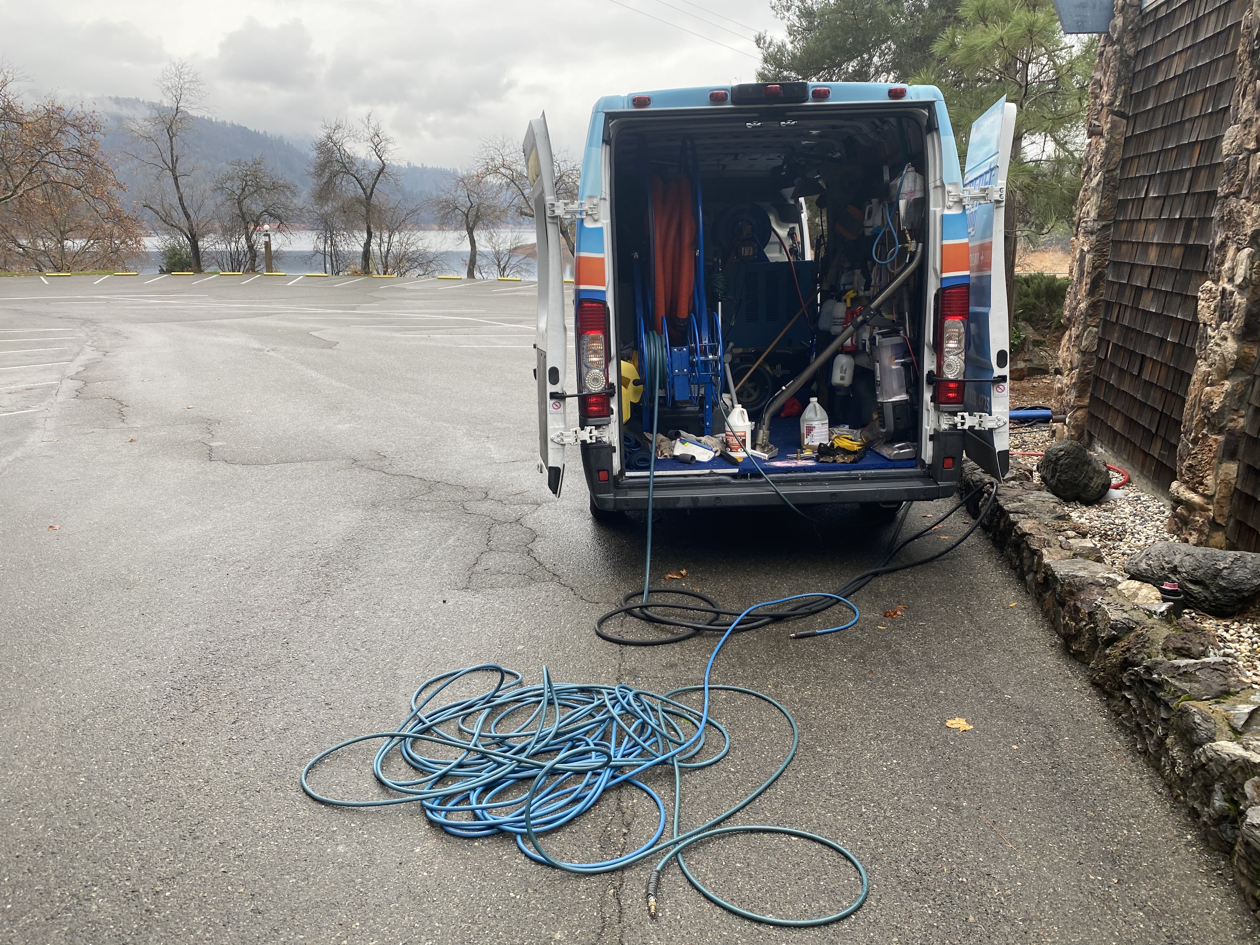

2. Never extract emulsified floor finish into your truck mount. I know that many get away with it, but this is from a guy who has a service department that fixes truck mounts: Floor finish has caused thousands of dollars in repair costs for guys who have used their machine for that purpose. You'd be better off buying a wet dry vac and throwing it away when you were done with the job than to let your machine be damaged.
