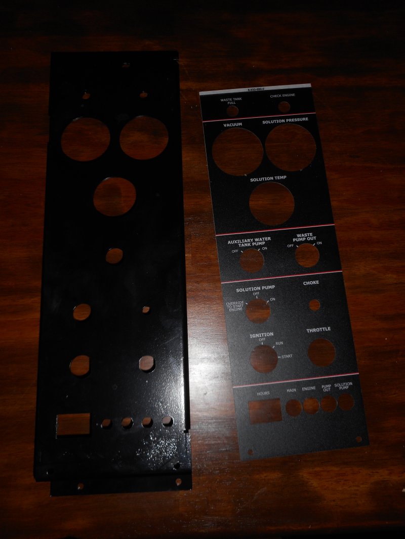

Big hold up now is I can't get my hands on any stickers, or they cost $250 per I think I'm going to have it all hand painted. .
Here's a thought.
I tried this when I restored a motorcycle. Can you go to your local sign shop and have them duplicate the stickers? You can take pictures of another APEX, and have them duplicate them. That's what I'd do...
Reactions: Able 1
A
Able 1
From here on out every sticker I buy will be scanned and made into a PDF file. Most places don't have the scanning ability because of the size. I went to a blueprint place that does vinyl today, they said no problem..:biggrin:. Wish Prochem would just send me there pdf's..

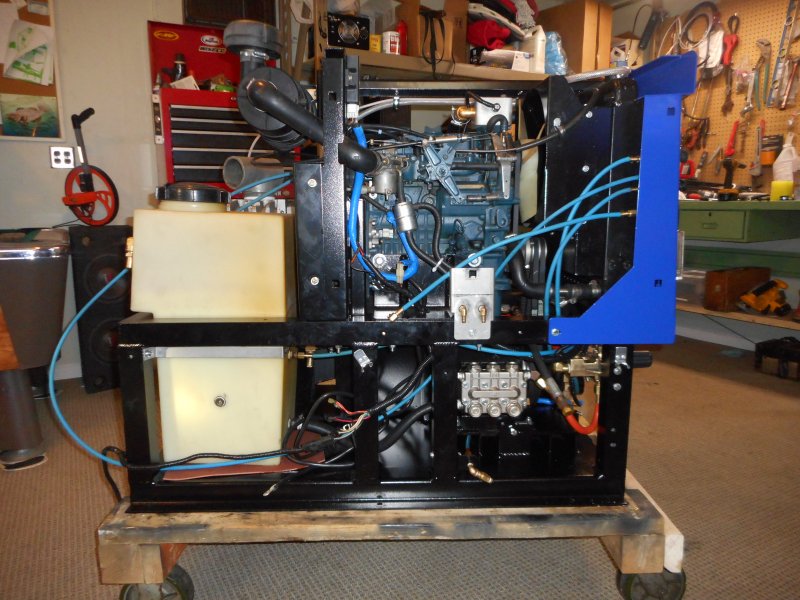

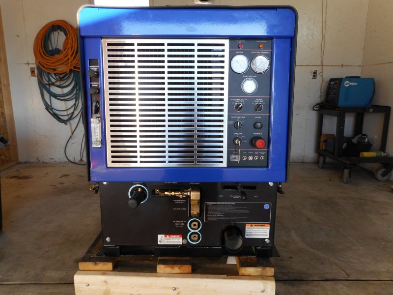

This one was a LOT of work, nothing went easy for example::madder:

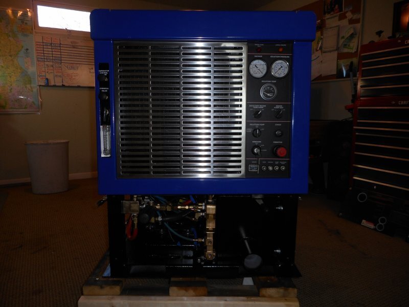

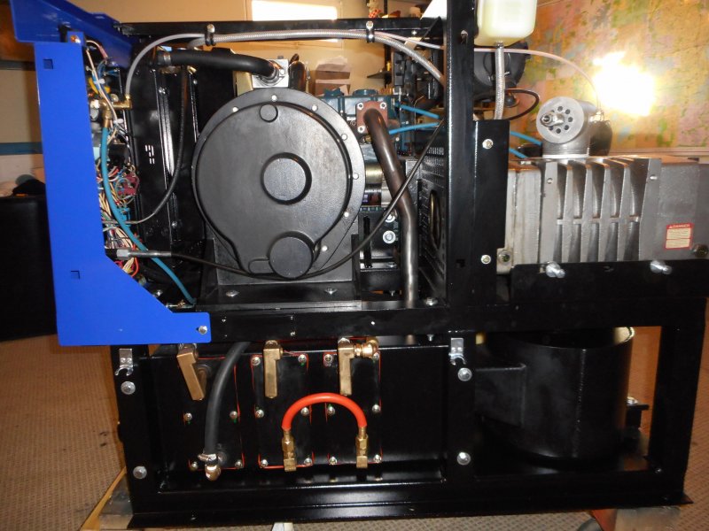

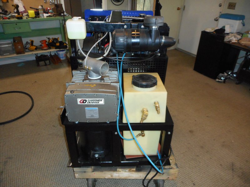

Plumbed and wired..

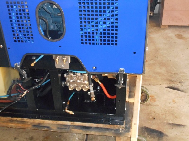

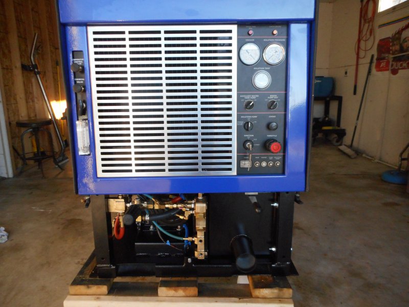

Planing to run it tonight..
I decided to go with these hood latches instead of putting the rattle clips back on..

Looks good. Have you done anything with the recovery tank yet?
A
Able 1
I took it in I'm going to have the whole thing skinned with sheet aluminum.
