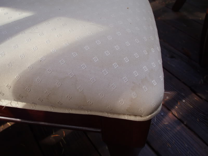

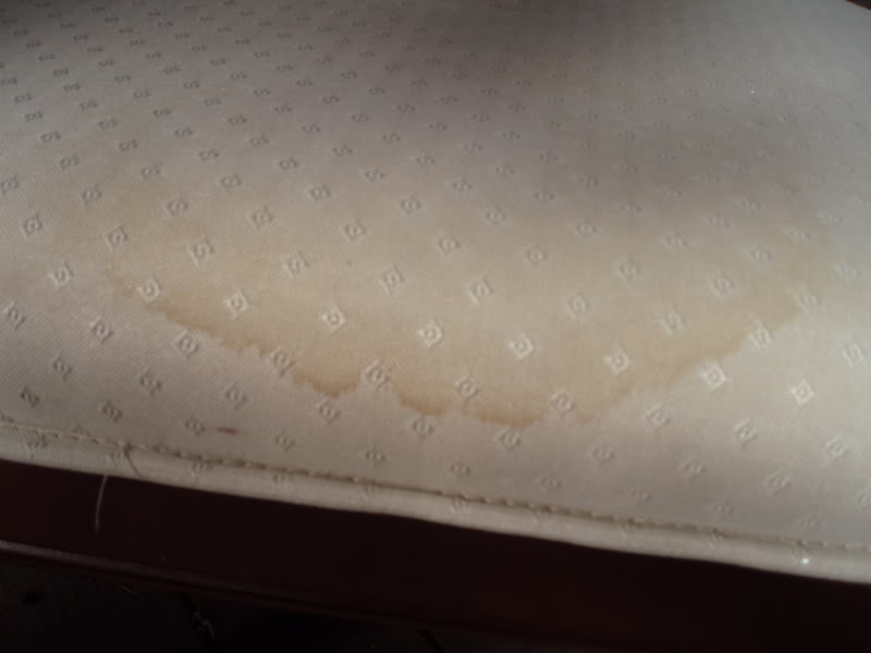

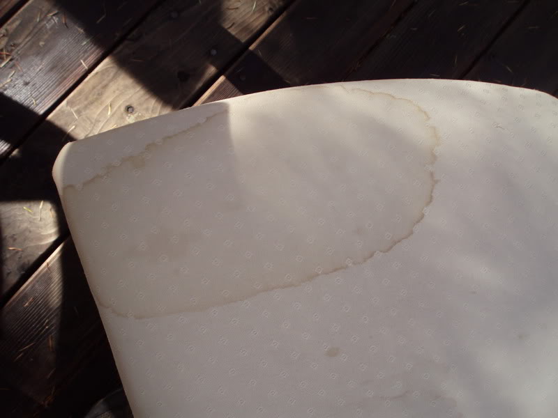

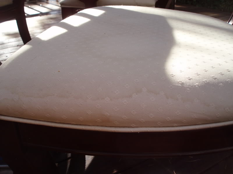

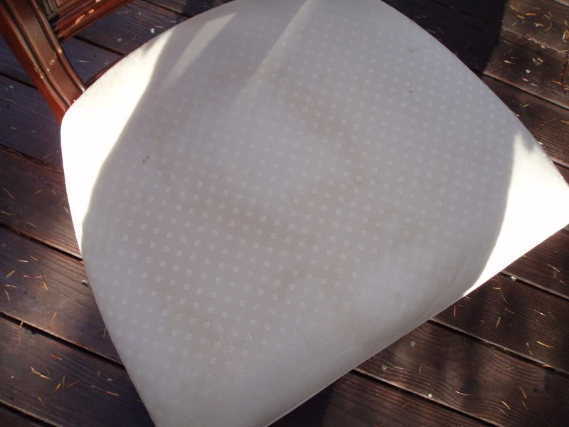

When your talking to Mrs Pift in her kitchen , innocently tilt a chair or two back and see how they look.
These I did today look like Stanley Steemer or Kevin P got to them before I did...
Obviously water/liquid rings from drinks but also notice the water marks along the edges caused by uneven cleaning.
Easy fix.

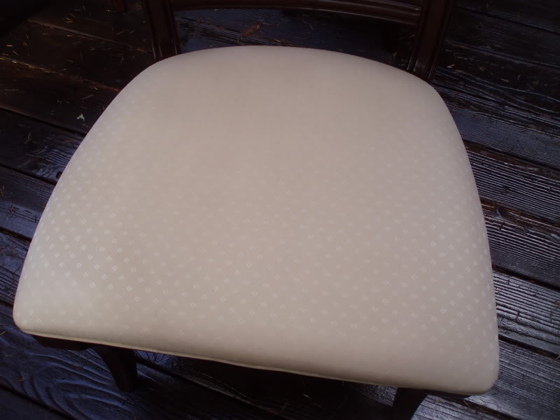

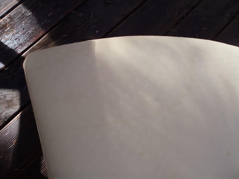

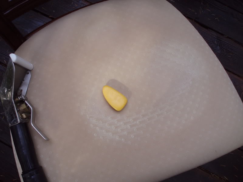

Vacuum if needed then drench the whole seat with a Powdered Reducing Agent. :shock:
Give it a few minutes to work, agitate with a towel or horse hair. You'll see the rings start to fade right away.
I didn't even need a cleaning agent on these 8 chairs.
A few tough spots came out with a Fels rub down...

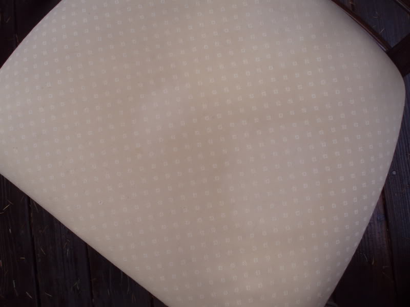

Then extract..
All of them came out this good.
Sell them some Protector and $30 times 8 is a cool $240 while your chimps cleans the carpet.

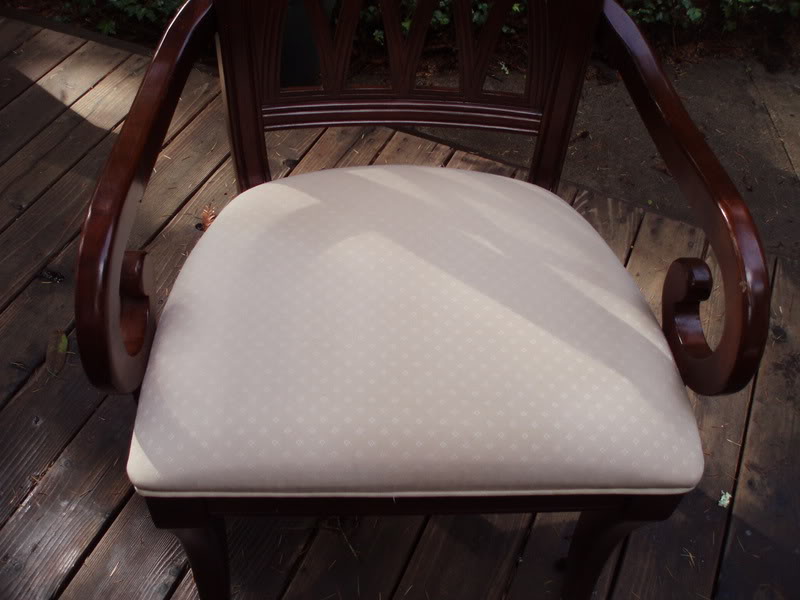

Cobbs Fiber Bright and Dyna Chem Ultra Shield used in this promotion and the cheap bastard wont even buy a banner.
