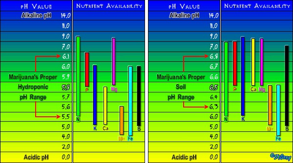

regardless of the product plants like a certain ph to grow properly. Grass for example if you raise the ph of the soil will probably die. Most plants grow well in slightly acid soils. I grow lettuce in 5.5 ph. You can use the water for plants but to much in the same area over and over will raise the ph of the soil causing negative results.

The ph doesn't burn them. They absorb the nutrients they need only in a certain range. Outside of that range key nutrients are locked out. If the ph is to high or low they suffer. Iron for example isn't absorbed at a higher ph. All plants are different but most prefer a slightly acidic soil. In the chart, marijuana won't absorb any nutrients if the soil is above 9 ph. No I don't grow marijuanaa but they always have the best chart and most up to date info. They still absorb the water but you starve them from the nutrients they need. If you water the same plant to many times the damage will start to show with yellowing first.

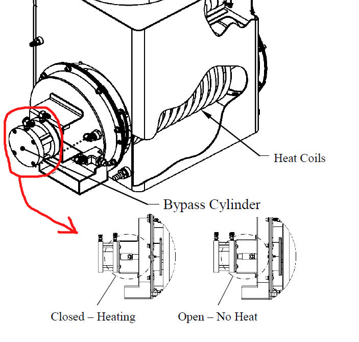

Sam - as Gene mentioned there is an exhaust diverter that either sends exhaust through the HX or around it. The diverter moves in or out by means of a Bimba pneumatic cylinder. By your description (temperature knob continuously variable) I assume your machine is serial 343 or earlier. Later models used a 4-position switch and were setup slightly different.
So, basically - as the temperature increases above the setting the temperature switch closes and sends 12V to a solenoid air-valve (Mac Valve). The air valve switches vacuum to one of two ports on the Bimba air cylinder, causing the exhaust to be diverted. When the temp goes back down the process is reversed, closing the diverter.
Possible causes:
  • No power to the thermostat. Unlikely, as it gets power from the same place as temp gauge and hour meter.
  • Bad thermostat. If the dial is set colder than the current temp it should send 12V out.
  • Broken wire between the thermostat and Mac Valve, or bad ground wire to the Mac Valve.
  • Bad Mac Valve. When it gets the 12V from the thermostat it should switch the vacuum ports.
  • Broken, cracked or kinked vacuum lines - one from the blower inlet to the Mac Valve and two from the Mac Valve to the Bimba air cylinder.
  • Bad Bimba air cylinder.
  • Linkage issues from the air cylinder to the diverter valve (i.e. the clevis pin fell out or something like that).
  • diverter plate stuck (gummed up with exhaust deposits?).
  • There has to be at least 7 in Hg at the blower inlet or there won't be enough vacuum to move the air cylinder. Unlikely - if your vac is that low you would have noticed!

I put it on low temp does it stay at 195 degrees by somehow not using the heat exchanger and diverting?
Yes - if it's working properly the diverter opens and sends exhaust around the HX coils instead of through them, but the exhaust is always preheating the water in the water box, so you always get some heat input.
