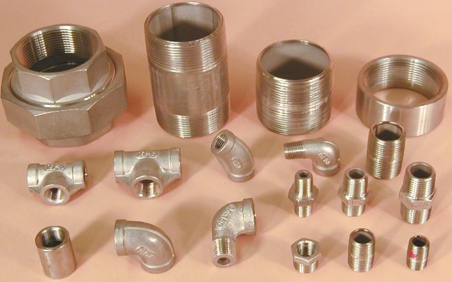

Sometimes, you can slip the 2.5" hose cuff over an existing 2" pipe coupling or nipple.
We have used a 2" SS coupling (top right) to adapt up.
It is an inexpensive way to start with 2.5" vac hose.

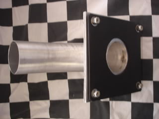

Are you telling Whiskers to use a 2" port and step it up to a 2.5" connector?
It would still be a 2" bottleneck.
For 1/2 the cost of a section of hose you could solve this dilemma.
A single $79 bolt on connector would fix this scenario, it even comes with gasket and SS hardware.
