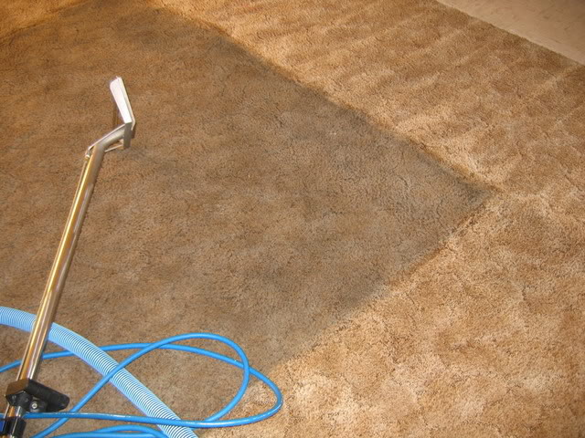

Do you remember the first time you really pre scrubbed a carpet?
I'm not talking with your shoe or a lame Grandi Groomer, I mean with a 175 floor machine or maybe a Cimex or CRB?
What was your reaction?
I did this back in my POG/Millers days but when I went to Coitus I sold the 175 off thinking a TM wouldn't need prescrubing.
Boy was I wrong.
I got by for many year without scrubbing by using way too much pre spray, heavy rinse agents and too many wand passes.

I did my first scrub with a 13'' slow speed buffer the other day and I could tell the difference in the cleaning.
It was one of my apartment complex.I would like to see what the difference would be with a 17'' 175 buffer and also
what type of pads to use I had a nylon bristled pad driver the bristles are about 2 inches long.

I got tired of hearing you, Dobs, and Charlie Brown preach the benefits of a rotary over on ICS a couple years ago. So I went out and bought a Minuteman rotary.
First time out put it on a carpet similar to the one Chad posted above. Lack of prespray and experience had the unit jumping all over the room till it tripped the breaker. I don't use it a lot, but it gets used on restaurants and occasionally on other cgd. Would like to do more experimenting with post padding on burber and offer more commercial pad capping.
