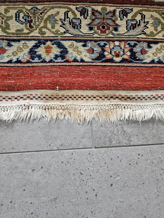

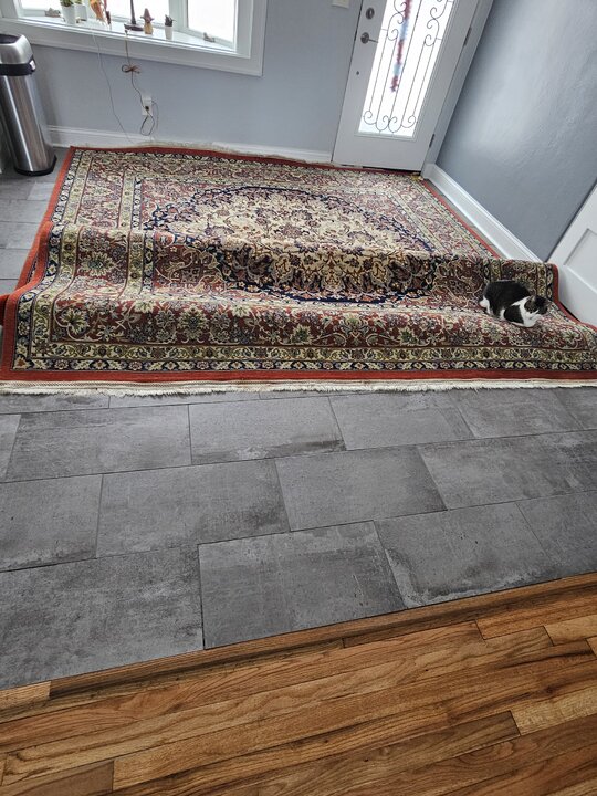

I got this rug about done except for the this spot on the fringe. I just applied a little 3 percent peroxide to see if it will work before going with volume 40.
It came from a home Genny was cleaning. While she was there a leak from the upstairs toilet came pouring down on the rug and a couple chairs so she called me in. I got everything including the wood floor under the rug cleaned up and brought the rug home. Its 10x15 and thick.
I couldn't get it dry in the shop because its not heated and it was 5 degrees this morning so I brought in to finish drying.
The owners already had a plumber coming next week and it had been leaking for awhile.
The rug smelled like 💩.
Matt knows what I was talking about though. 20251205_151338.jpg20251205_151323.jpg
Matt knows what I was talking about though. View attachment 133349View attachment 133350
It's nice rug ! I would put plastic under the fringe. Use a small sponge with 3 % dab it on multiple times over a few days, let it dry in between dabs. Good luck !!!
I used a cheap paint brush to apply it. Its lighter today so I will apply it again.
Yes I should have put plastic under it. The porcelain tile wasnt installed well so Im not so concerned about it. I did pull it off the wood though.
I hope you get it out !
