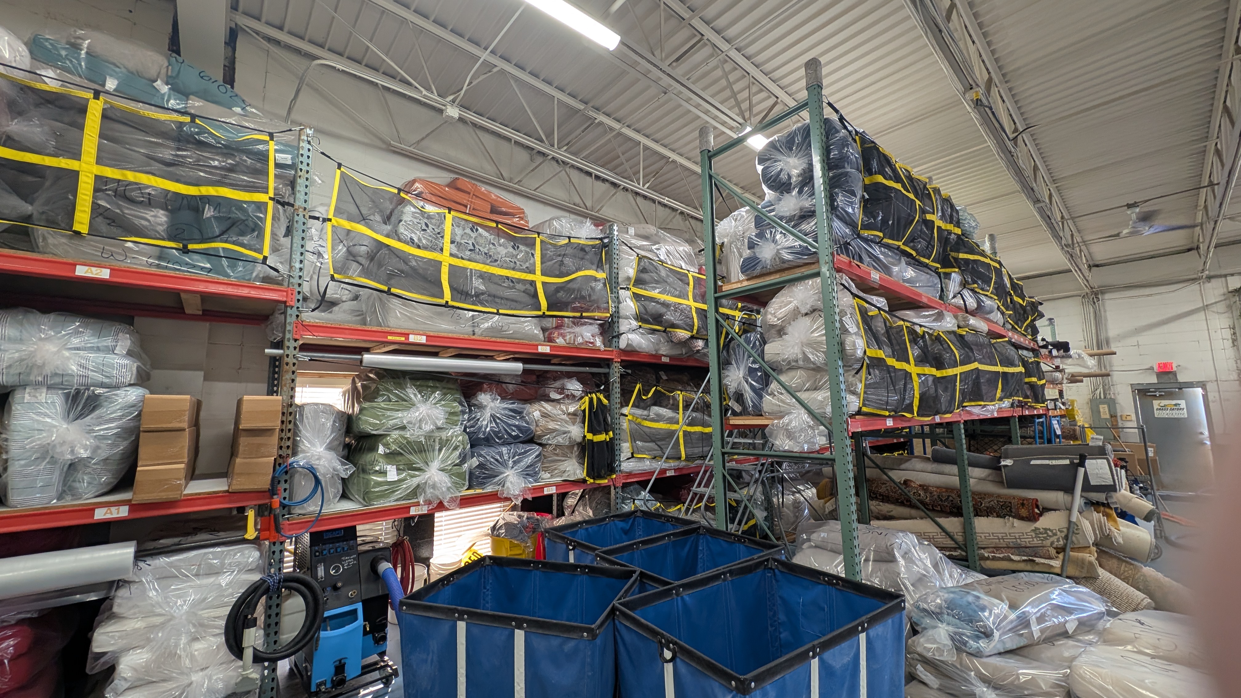

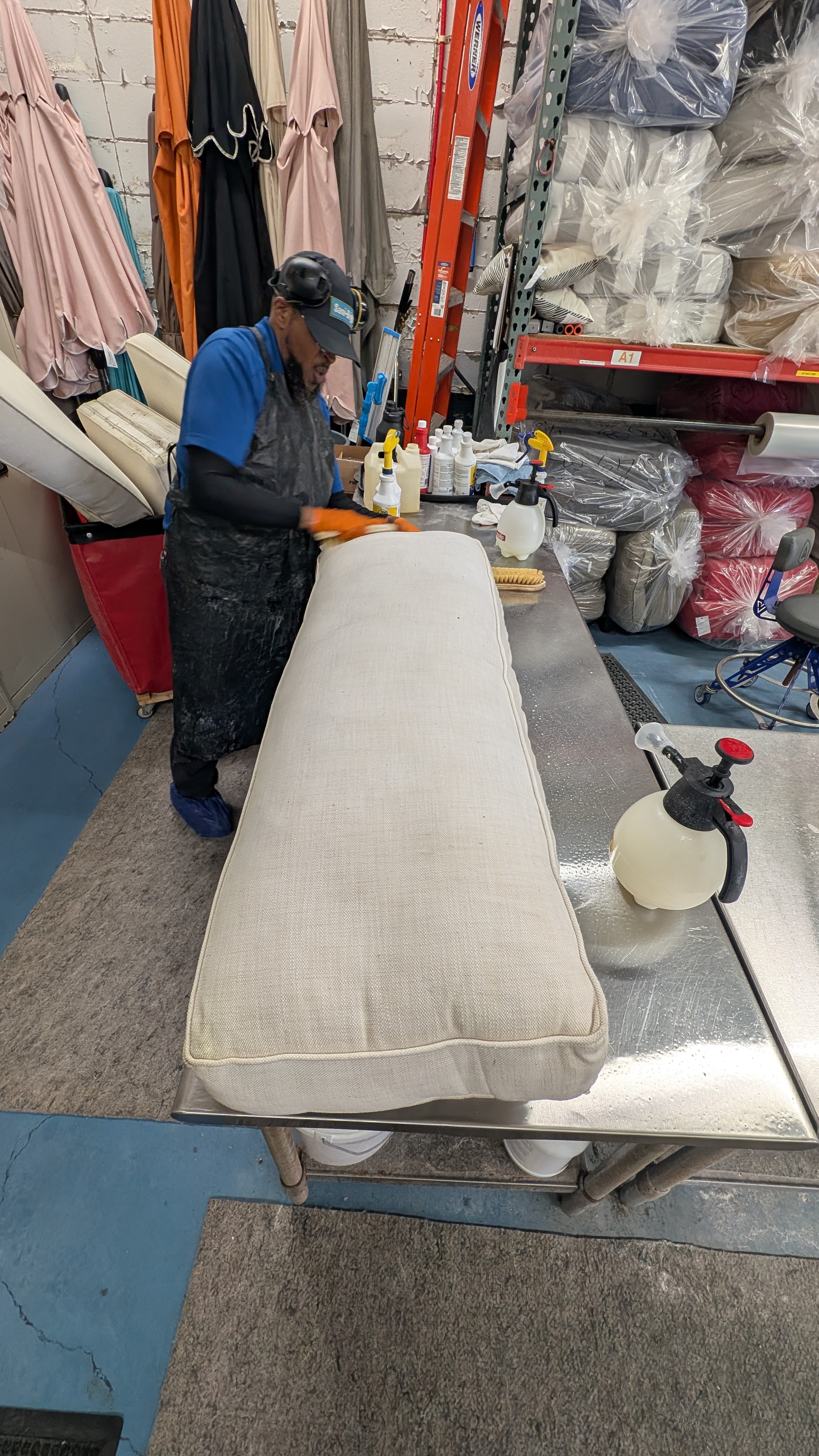

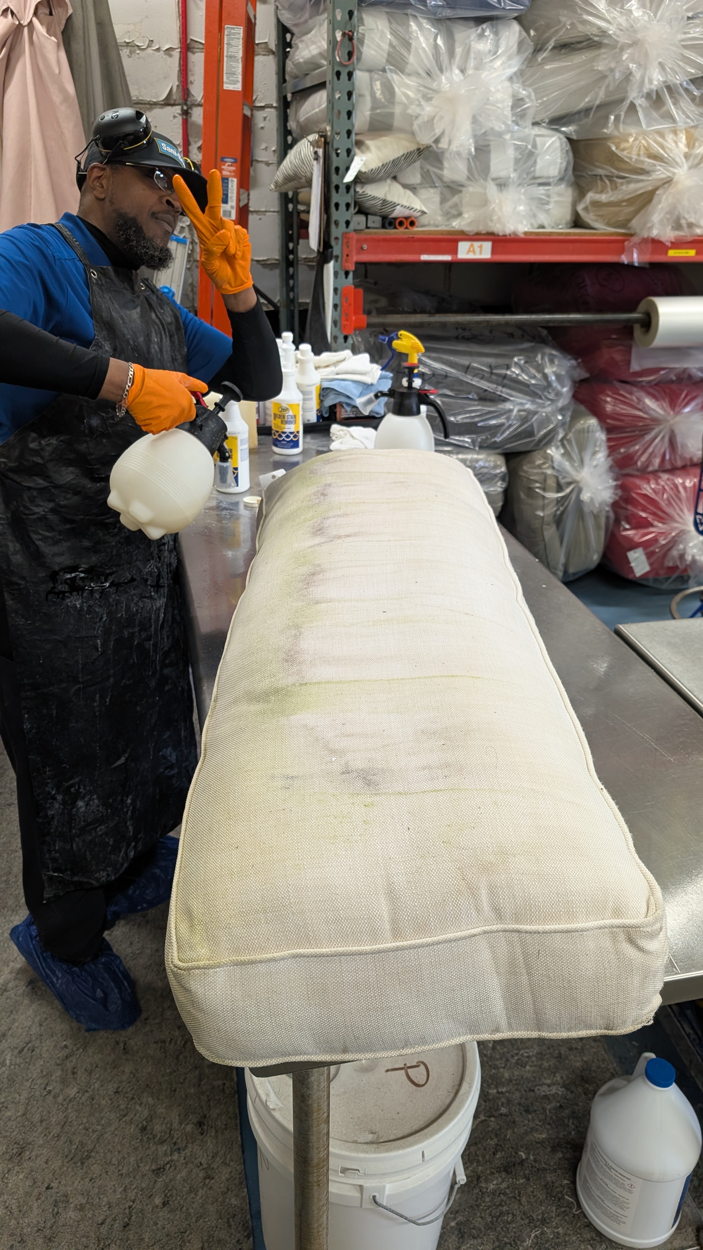

Looks like Hagopian's too!! We took in about 5000 cushions in 2024. They are cleaning away at them right now.Pre vacuum
Pre rinse
Apply enzyme cleaner
Rinse
Apply Zep
scrub
Dwell
Rinse
Repeat Zep if needed
Rinse
Dry
View attachment 129688View attachment 129689View attachment 129690View attachment 129691

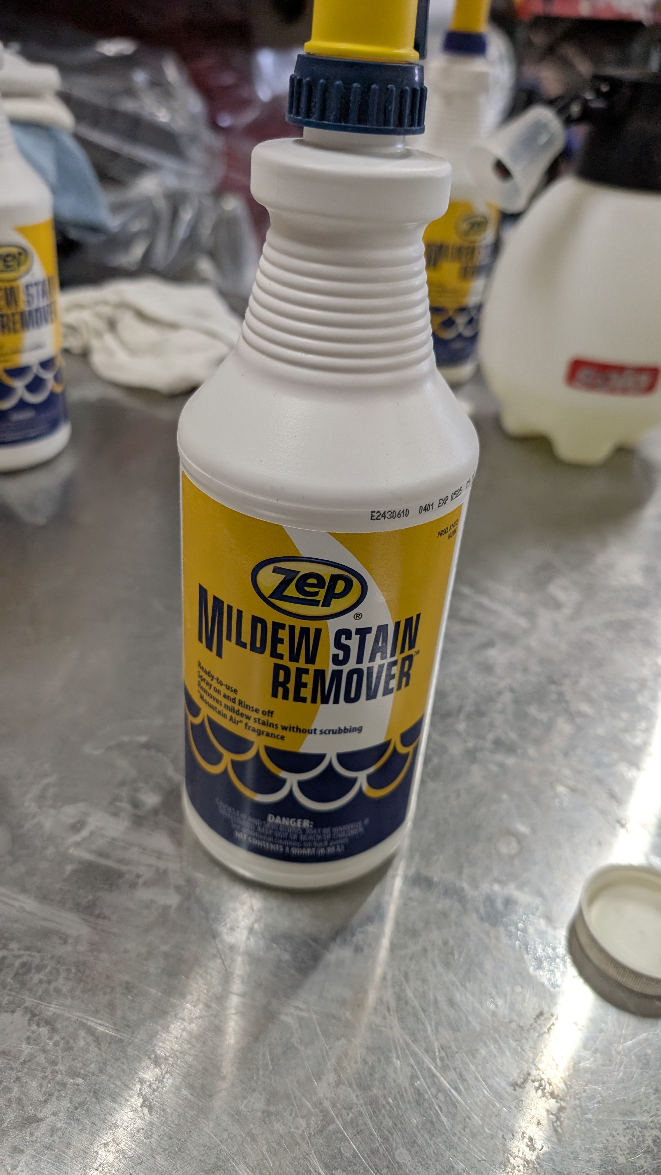

Sani-Bright does a ton of patio furniture
I'd be surprised if cotton was in outdoor cushions. Why in the world would any company do that?
And is that Zep a chlorine or peroxide based mildew chemical?
ChlorineI'd be surprised if cotton was in outdoor cushions. Why in the world would any company do that?
