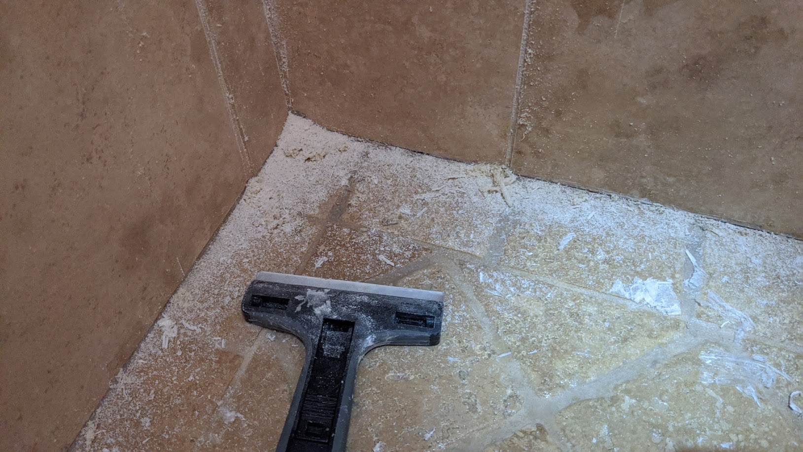

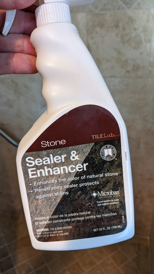

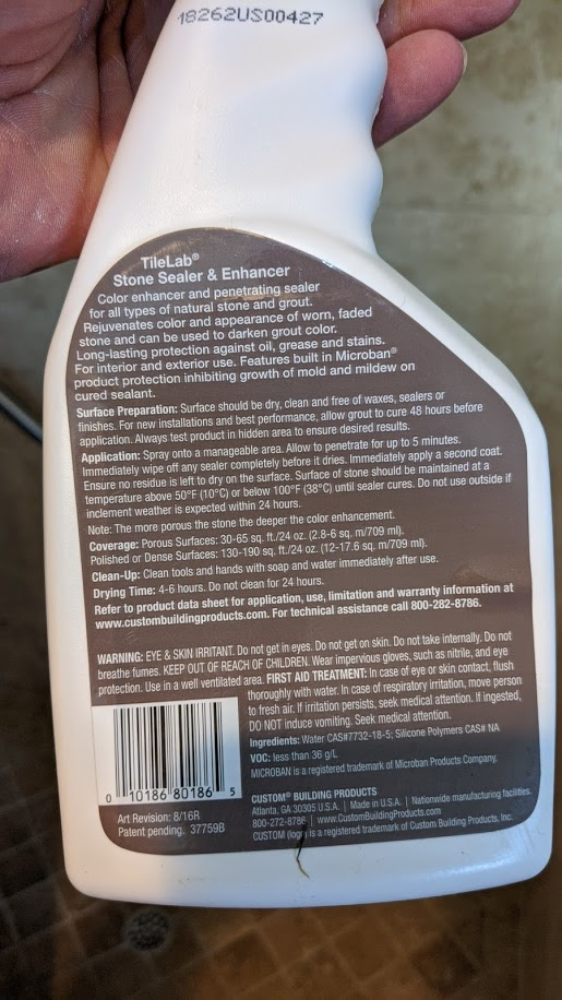

Aug 8, 2020 #1 Mike Pailliotet Administrator Joined Oct 6, 2006 Messages 117,270 the residue it left on this Travertine shower was a streaky, oily, yellowing mess, that luckily, between a 4" scraper and some stripper came off....
Aug 8, 2020 #2 Old Coastie Supportive Member Joined Jun 29, 2015 Messages 7,504 Name Stephen It reminds me of an expensive stone enhancer I bought locally at a tile store. It was boiled linseed oil. That was all. I came back the next day and scoured it with acetone to remove the gooey surface.
