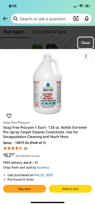

Liquid
My experience with the powder is that it leaves a death valley salt pack around fittings and spray tips
Procyon Extreme works very well for wool carpeting. (Liquid), but the price is RIDICULOUS!!!!!!
I also found that the ‘Silver Solution’ product does very well for it aswell. (Just LST cleaner rebranded). If memory serves correctly, I think it’s a ChemMax product…

50,014
My last Procyon order was March 3rd

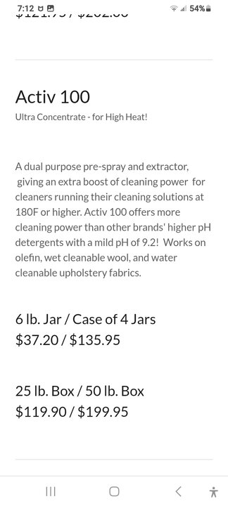

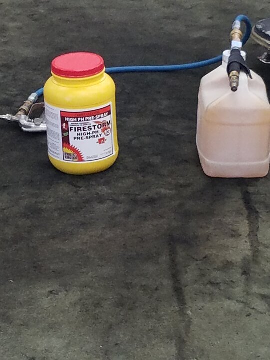

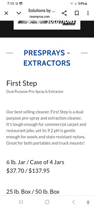

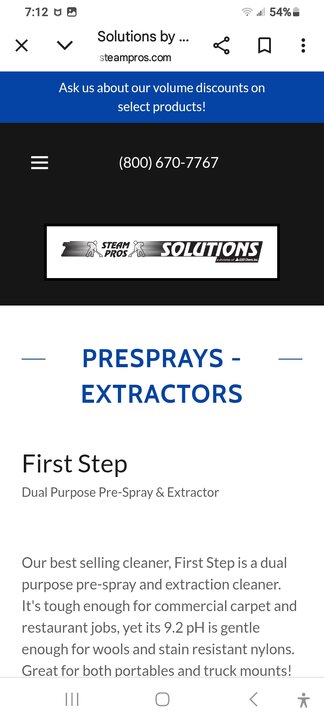

I use first step as my primary prespray and hd100 as an emulsifier for virtually all carpets including fine wool . After cleaning i do rinse all carpets with prochem all fiber rinse. It cleans very well and is pretty idiot proof with employees i never had to worry that they used the wrong product on wool. About the only other prespray i use is firestorm for greasey restaurants and my shop and funky rentals occasionally ill boost eighter one with 2cups of peroxide per 5qt hf sprayer and the other 2 cups in the bottle goes into the emulsifier jug. I go thru about 150lbs of hd100, 50lbs of first step and 30lbs of firestorm (6 jars) per year. Added perk when i order from steam pros solutions is that when i order 2-50lb boxes of any of there products i get a 25lb box for free to offset some of the shipping costs
