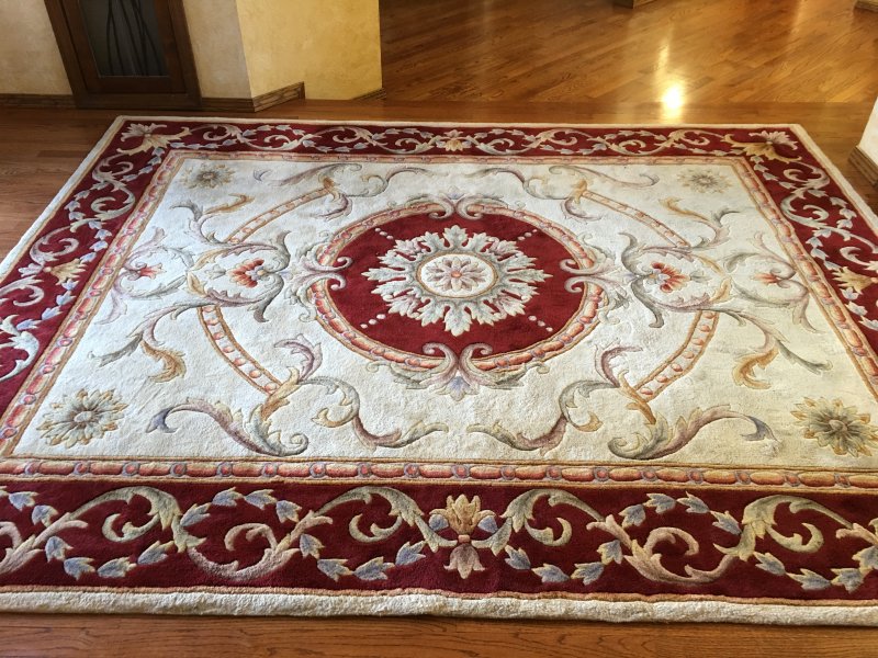

Getting ready to clean my gf extremely tight wool rug. After seeing pics of Springer's shop on this forum (props to the Huxley dude and Mr. Hugh), chance of success is against me. Wish I could figure out how to post pics. In one of the pics I seen at springers, was that a wringer like they use to use with laundry? Here's my game plan: prespray with solution at ph 9, agiate with my groomer (yes it does have a wooden handle), water extract (no chemicals), then rinse (acetic acid, ok yes I'm gonna use vinegar), throw in a ton of dry strokes, and my carpet fan. So I'm thinking this should dry by turkey day, gf leaves me, and I will be on match.com looking for my future X. I'm thinking it's really good that I have a normal job outside CC, that way when I screw someone's carpet up, at least I can threaten them with a payment plan.

Start by vacuuming both sides, back first then front, very slowly to remove as much loose soil as possible. Lower your pH of your pre-spray to 7-8 to be safe and use an acid rinse in your chemical injection. Keep your heat off and pressure under 500psi. Be sure to groom the pile with the nap after extraction to help remove the wand marks and set the nap in the correct direction. Check for dryness with a moisture probe. When dry, vacuum again. You should get out of this unscathed.

Never thought to vac both sides, killer idea. 500 psi, I got a porty. Heat, I'm using tap water out of the sink. I used my upholstery tool to clean because the $3 utube super duper wand glide I made wasn't cured yet (and when it is cured, I'm betting it comes detached easily). The rug does look better. When I drained the water, it looked like I sucked my cat up in the machine. After I read your reply, I did run down stairs and make sure I had the nap going like you said. Thank you, advice is cheap, good advice comes with experience and is priceless.

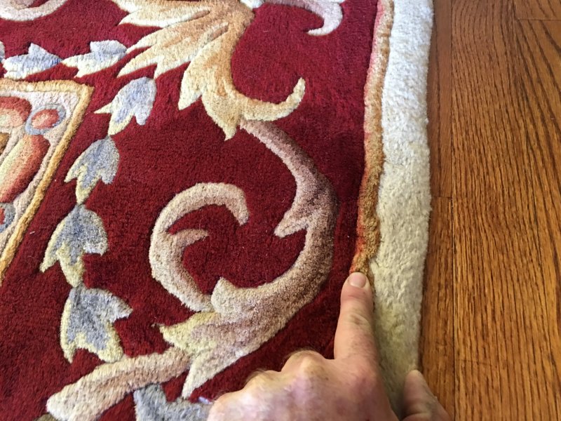

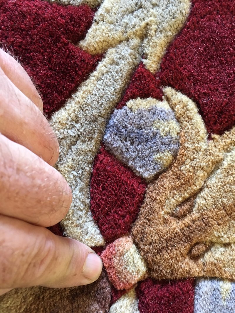

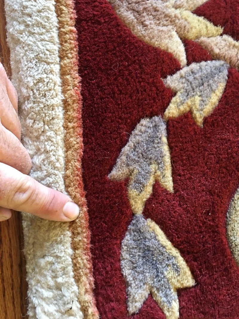

There are many variations in construction of wool rugs. Type of dyes, foundation yarns, weaving methods and so forth. Many more factors to consider than cleaning an installed carpet.
For best results, I suggest you take it to a rug cleaning expert. They often will give a discounted price to other cleaners.
If you do decide to clean it yourself, email me for my introductory training manual on wool rug cleaning. I will send you a free copy. Actually email me assistant - nstoker@interlinksupply.com
Key points -
  • Therei s likely a lot of dry soil in the rug. Shake, beat vibrate, vacuum etc. to remove as much soil in a dry state as possible before adding any moisture.
  • Use the minimum amount of moisture. Extract as much moisture as possible. Dry quickly with aid of air movement and possibly heat.
