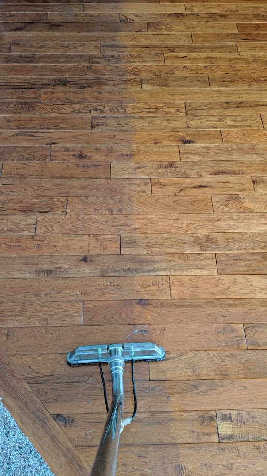

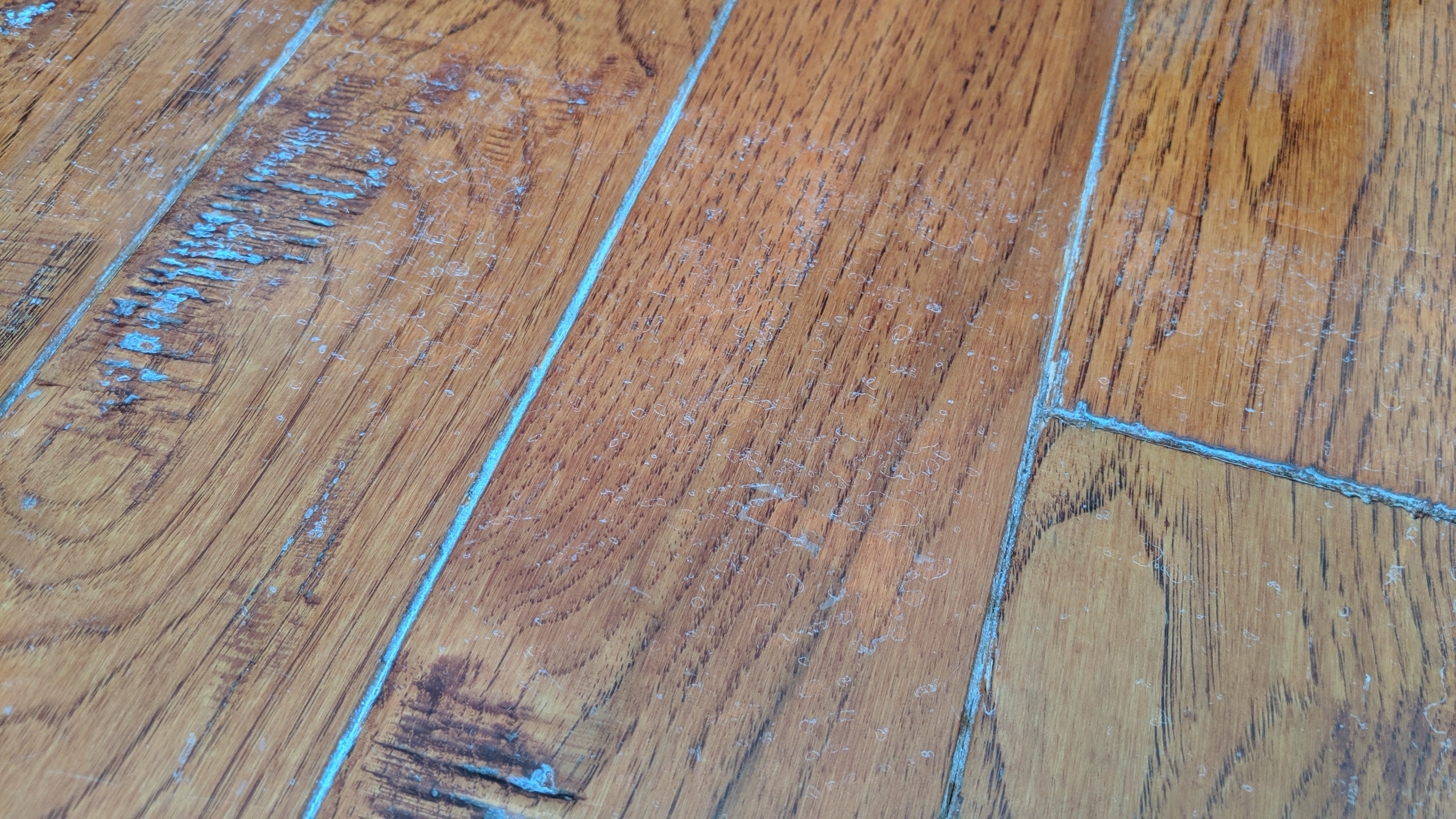

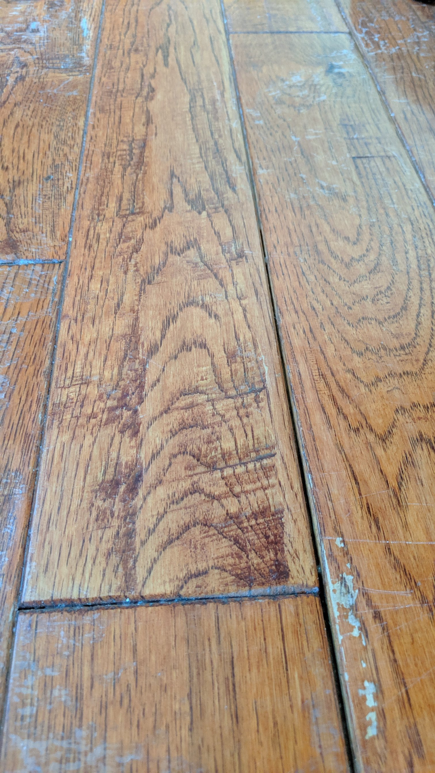

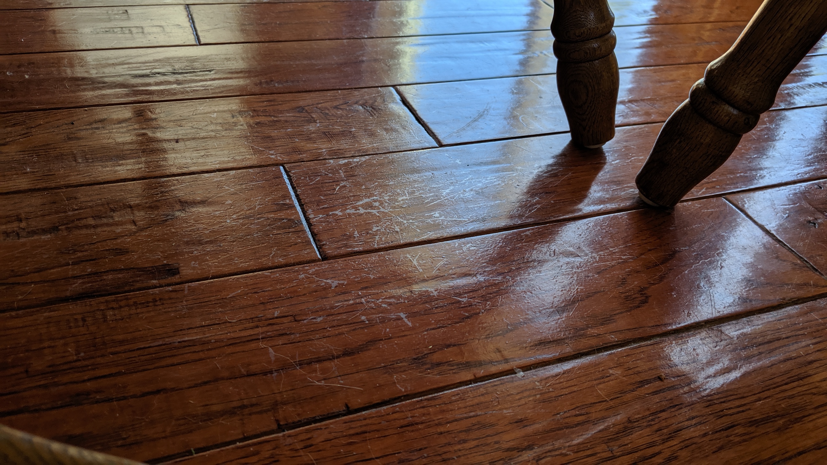

Looks good so far. Hopefully the grain doesn't open up too much. Are you going to put a finish on it?
Not sure what that means but ok.no need the Aluminum Oxide is holding up well
That's why I'm here. For those educational moments. Thanks Mikey.![]()
All About Aluminum Oxide Floor Finishes | Accent on Floors
The ins and outs of luminum Oxide Flooring Finishesaccentonfloors.com
What color pad did you use to strip it? And how did you know it was aluminum oxide? I've never heard of that type of finish which is why I'm asking. Is it something that's common on the west side or is that common everywhere?
And when the customer has cancer or the onset of Alzheimer's.No pads..
Poll brushes.
Masking would have took hours.
Most pricey wood floors are AO finish these days. When you see very few, if any scratches, little to no fading and a dark color on a hand scraped look finish that can't be sanded without destroying the look, those are your clues...
