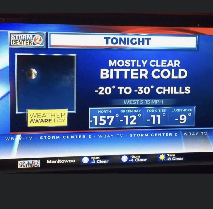

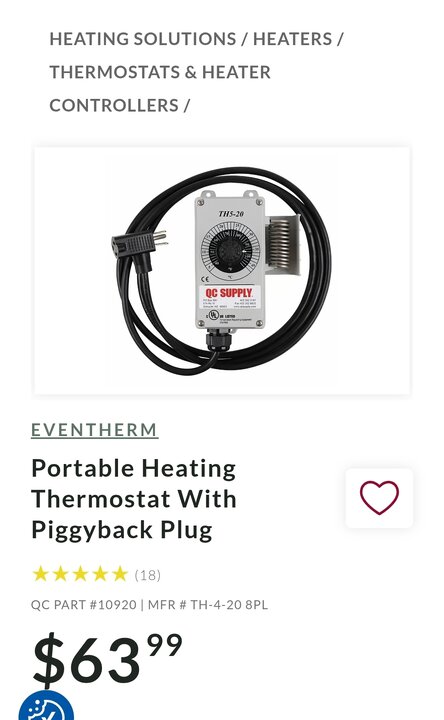

If there was ever a good reason this is why Dwaino lives on the coast!
Screenshot_20251106_173426_Google.jpg Screenshot_20251106_173441_Google.jpg Screenshot_20251106_174539_Google.jpg Screenshot_20251106_175828_Google.jpg

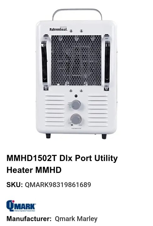

Are you saying just put it up for the winter? How long does it take to make ready after winterizing it for next job? At what temperature can I continue working without hose problems? I see some working in the snow. And last but not least any particular type of heater source recommended?Heater
