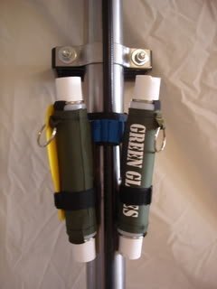

For specialty spotters that you only need small quantities of I would use one or two or even three of these, hang em right on the wand.
Each HandiSpotter has two small bottles, one on each end.
As you can see there are attachments to hold a gum scraper, as well as a clip to make drawing the HandiSpotter off of the wand strap and putting it back quick and easy.
They aren't very big so they aren't very heavy.
What you see in the pics is about $25 retail for the whole set at your local store.
I don't like carrying spotters on my belt.

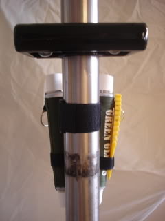

That is what I use the thing is great.I hook mine on to the inside of the handle of the wand and it stays put and has never gotten in the way..........
One side of mine I like to use the OJ from Interlink..it is a critic jell and it is pretty thick so I had to change out the lid so I could get it to come out......
here is a closer picture
