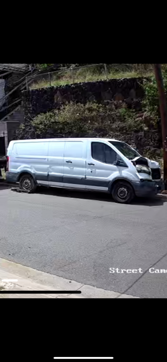

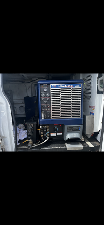

Didn't @Nomad74 have his 870ss in his GM before getting the platterpus van?
It fits in a GM van but it's tight.. I always thought it was the same footprint as the Everest 650?
A friend of mine I just helped pull a Everest out a low roof Transit van.. Had quite a bit of room in there..

Double doors not sliding..
