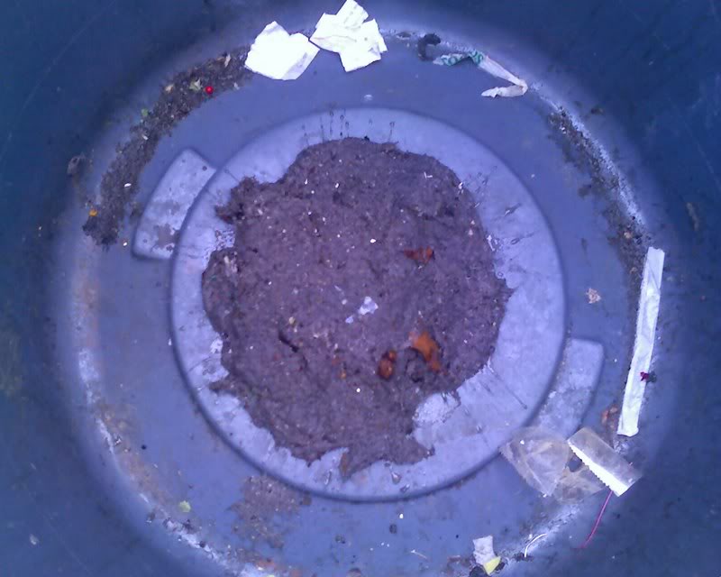

This was in my drain filter today...

You're supposed to clean carpet not the driveway.
How does that paper get in there? I think someone takes the hose off the wand and sucks up crap. ARe you sure the vacuum cleaner is working??
vincent
1,899
Vincent Sapp
That's a 200 gal waste tank right?
Just think I get half that much with a 120 waste tank.
Question though, are you sure you are leaving carpet there after cleaning. Thats alot of junk.

You definitely are not a snobby high end cleaner but just a simple HACK like the rest of us?
So how many times did you have to punch the holes in your glide to get the crud out while you were using it?
B
B&BGaryC
I use the hole glide, and my filters will get like that even when I pre-vac. I am using a dinosaur of a royal for a vac now. Rebuilt, and pretty fierce, but still no Sebo...
I do have to check my glide during a big job though, I take the cuff and suck the crud out that gets stuck in the middle.
When MicahR put my wand glide on he kinda pinched the metal wand lips together in the middle, so there is not enough clearance for the crap to go all the way through in the middle, just the sides...
