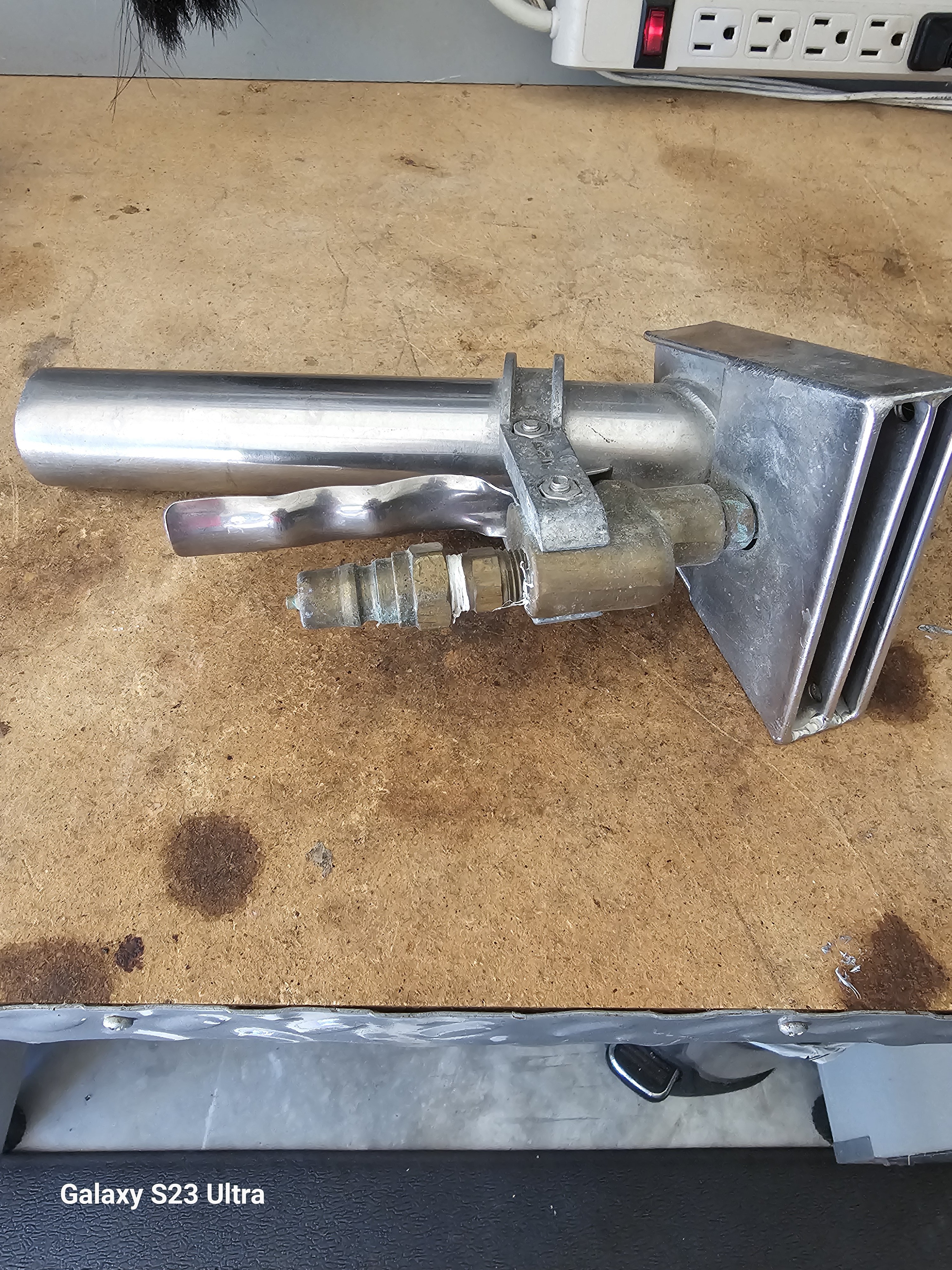

Who has the valve for this tool?
Jun 20, 2016
6,560
Jeff T
PMF V300?
You answered my question aswell. I’ve got the exact same tool at my shop, waiting to go back into service…

Used the wand yesterday. That valve sucks lol. I might modify the wand to fit the the other valves I have.
The trigger pulls hard even at low pressure.

It's not that I can't pull it lol.
It feels like it's going to break. It's not smooth.
I don't have faith it will last.

the valve is "OK" and will last as long as any before needing rebuild
It's just heavy to trigger open
because of that ^^ it's the trigger lever that's weak .
It will bend eventually and won't open valve fully
there is/was a solid straight lever that won't bend
I remember that happening on a wand a long time ago now that you mention it.
But tge valve I replaced didn't do this.
