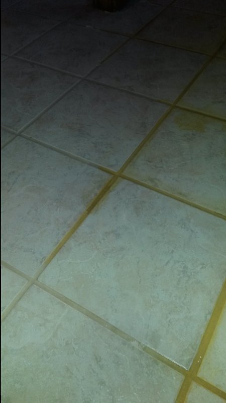

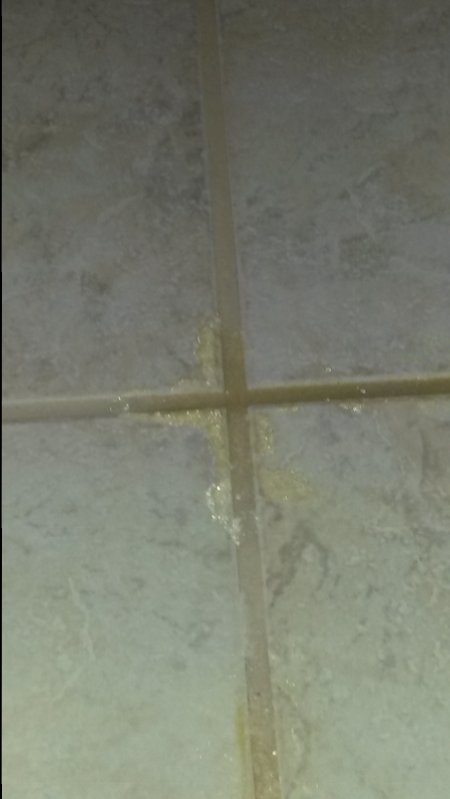

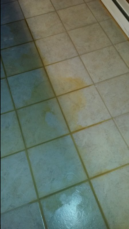

This is at a friend's house
he asked me to look at it...
tile is on a slab
he had a flood in that room in May.
Serve Pro did the dry down
they noticed the effervescence 4 months later.
She cleaned it and it came back a month or later
Jim Martin
10,877
Jim Martin
bet if you were to pull a few tiles in the middle you will find a lot of moister still trapped and it is dissolving and breaking down the mastic.....
tile is on a slab
Did water remain standing on it for a long time? We see it happen whenever water remains on concrete for extended periods of time. 24-48 hours and you can expect some problems with moisture in the concrete. I'm with Jim, pull the tile and see what's going on.
The can always do a calcium chloride text and see if there is too much moisture in the concrete but it sure looks like that's the case.
http://www.homedepot.com/p/Taylor-T...ide-3-Test-Value-Pack-625-POP-VP-HD/203419910
That's not too long but maybe it was enough?
For one reason or another you have moisture diffusing through the concrete as vapor.
think we found the source ...had nothing to do with the original dry down .
it's bong water .....
well not really
this is their pool room that rarely gets used or even entered all that often .
in that room in a closet is the water softener ...when regenerating it drains into the connecting crawl space where there's a drain.
That crawl space is also where the well tank is (the source of the original flood when it failed)
Long story a little less long, that drain must be clogged enough that it can't handle all the flow from regenerating softener .
he discovered puddles in the crawl space this morning.....it was dry when we looked at it a few days ago trying to determine where the moisture to cause effervescence was coming from
Mystery solved ...gotta be the softener and slow/no drain.
Reactions: Desk Jockey
That makes a lot more sense. Had it sat over night or for days then I'd say it was associated to the original water loss.
