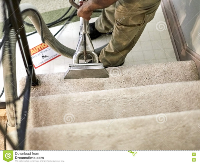

Nov 21, 2016 #3 R roro Member Joined Oct 18, 2006 Messages 1,311 Name Ross Craig Does the twin neck give better airflow? roro
Nov 21, 2016 #4 Mike Pailliotet Administrator Joined Oct 6, 2006 Messages 117,350 Doubtful, just confuses the flow Reactions: Shorty and BIG WOOD
Nov 21, 2016 #5 Cleanworks Moderator Joined Oct 22, 2012 Messages 28,277 Name Ron Marriott But it looks cool. Can you imagine if it swiveled?
