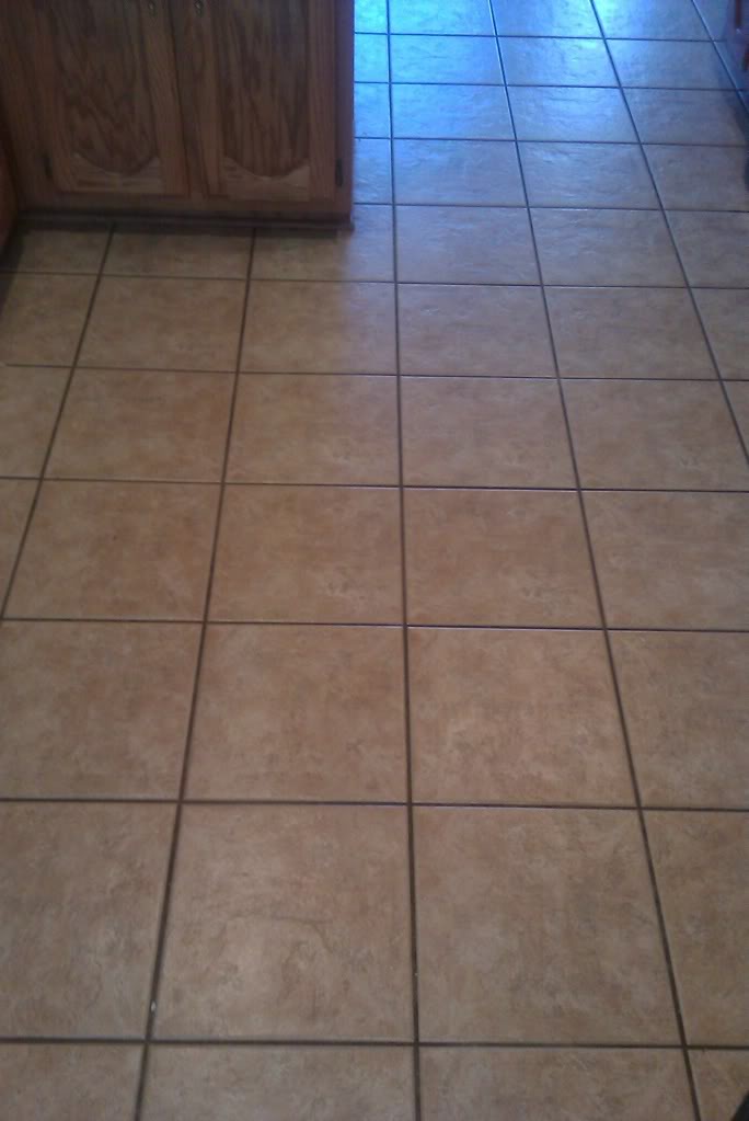

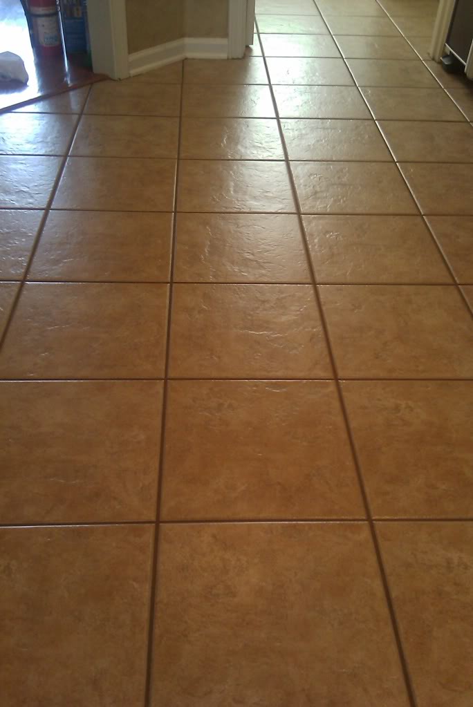

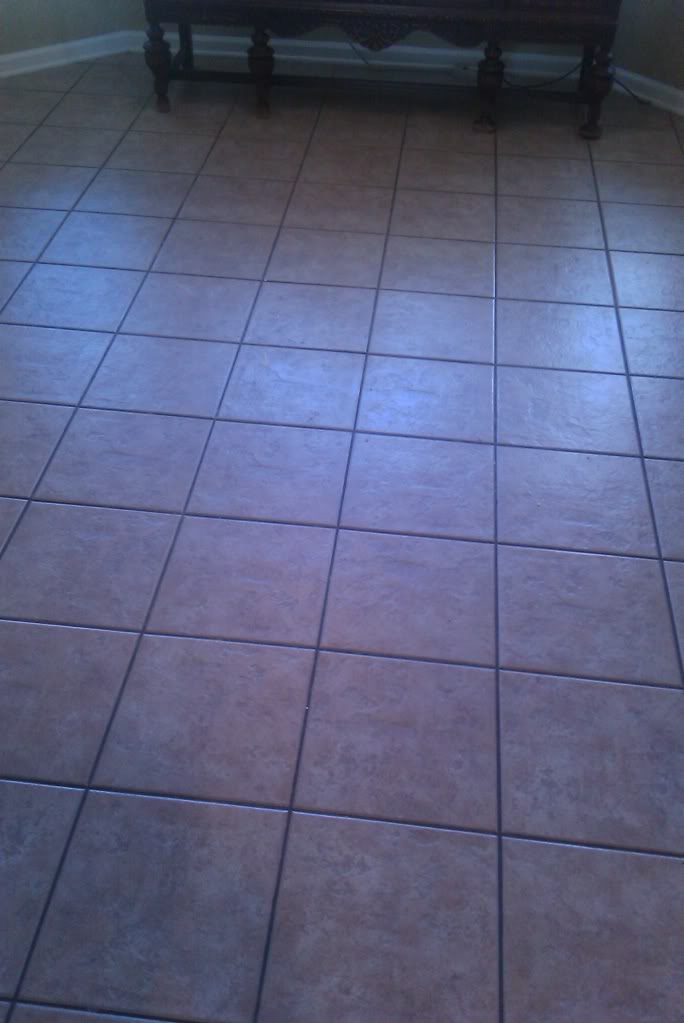

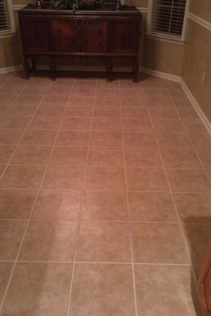

I had to clean and color seal 250 sqft and a small bath with just clear seal. This job took FOREVER. I stripped the floor and steam cleaned it two days ago and went back this afternoon to seal and clean some carpet. I thought I will have this knocked out in 1.5 hours but no longer than two hours. The seal part took 4 hours. :shock:
The sealer kept wiping off the tile. It adhered ok if I waited 5-10 minutes before wiping, but the sealer was dry by then and I had to scrape it off literally. I wanted to apply and wipe it off while it was still damp, but the grout joints were real deep and when I wiped the sealer a lot of it remained on the tile and the sealer would come off. Then I would have to reapply. I thought I was making decent money at 425 but I will take 300 to clean and clear seal any day of the week before going through this again. Most color seal jobs are not as bad as this one. My back is shot and my wrist is killing me. The customer walks in and says wow it looks great and I was thinking this looks horrible and splotchy. I left some extra sealer and showed them how to apply if they need to touch up any spots.
Any tips would be appreciated on how to avoid these problems.
Before Cleaning
After Cleaning
With color seal

If you have the GP CS CD, I'd recommend watching it before and after several times. The first few times will take a while, but you will only get better at it. It requires practice. There's a certain way to do the wipe. All this is in the video, after you do a few jobs, you'll get the hang of it.
Those tiles in the bathroom are easy, I was expecting 2x2 inch tiles with high grout lines before seeing your pictures. Watch the GP video, if you don't have it, go buy it.
We only offer GP CS, best results, best support, and our clients are happy.
Brian -
He didn't color seal the tile, when you apply the sealer onto the grout it will smear onto the tile itself. Than you just wipe it off the tile w/out removing it from the grout line. There's a technique, that requires practice. In the very end, spray water in 50 ft sections and use a cotton bonnet/pad on a floor machine to remove all the CS haze that is on the floor.

Yes you have to push your finger in the grout joint just enough to wipe the excess off without removing the sealer on the grout. The problem with this job was when I did that I could not get all the sealer off the sides of the tile. I would do a double wipe and there would still be sealer on the tile. So then I just had to scrub if off and then go back over the grout with just the brush to smooth it out. I guess I need more practice. The video makes it look so easy. It is not. Plus in order to apply and scrub you really need a person to follow up and wipe because if the bottle of sealer sit the tips clog up and makes the sealer hard to squeeze out.

Seriously Daniel, that looks like a cake job. What Color seal did you use? If you used Grout Perfect......why wait the 2 days for drying? With GP, I clean and color seal the same day. Just make sure theres no pooling water in the grout joints.
The sealer should not stick to the tiles......it's the grout you are coloring.

Practice. Don't put your finger in the grout line. Make your hand flat, using a slight circular motion. Let it set for about 1 min, then wipe. Works for us.
Also, don't give the customer the color sealer. Keep it. Offer lifetime warranty if cleaned within 12 mths at 70 - 80% of original clean price. We just did two of these last week. Easy money, sealer held up great. Also time to upsell!

about 45 secs of sealing, go back to where you started and start wiping. The sealer will have 60-90 secs to set. Also, too much sealer being applied could be causing the problem. Try applying less, brush it in. should have very little excess if doing it correctly. Less is better!
