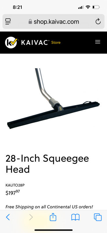

9,238
Yukon, Oklahoma
This with a Rigid wet vac is the cats ass for stripping small floors. I wouldn’t even want to get a good Mikey floor tool in that. It will swivel to even get behind toilets beloit or not.
It’s gone up a hundred since the last I bought, but it’s so worth it.

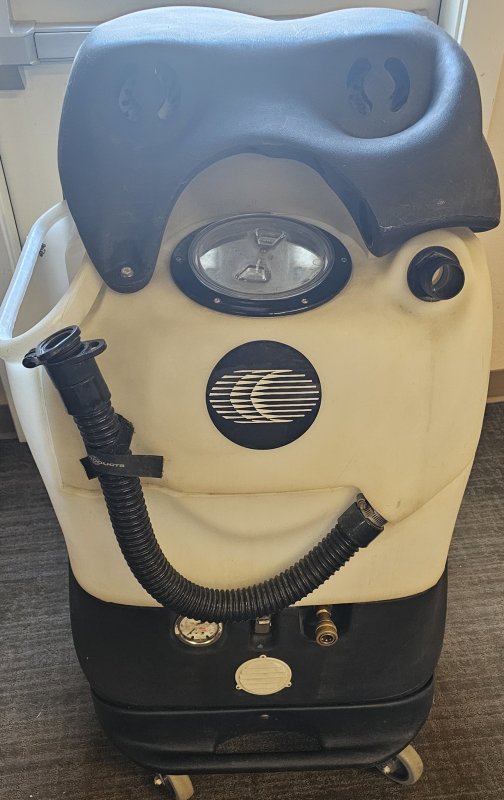

12,559
As above. Your portable is too valuable, and your time too valuable, for the consequences of getting that mess into your unit.
Truck mounts?
We’ve had to do some expensive repair work for cleaners who have made that mistake.

9,238
Yukon, Oklahoma
I had an EDIC porty and it wasn’t worth 2 cents as a porty. 110 psi 😏I started using it as a vacuum for slurry and might’ve lasted 6 months. You couldn’t clean it enough. That crap gets in the vacuum motors and soon it just craps out😏

9,238
Yukon, Oklahoma
Most of the floor guys use a Tennent or Nobles or something with the squeegee on the front and push it around. When Diana was on the #truck with me, I wanted to buy one for her.😂 She nixed that real fast. She said, I don’t want to push a tank full of water around. She just used the Kiavac Squeege wand and 50’ of hose. Actually it was effortless. (says me😏)
