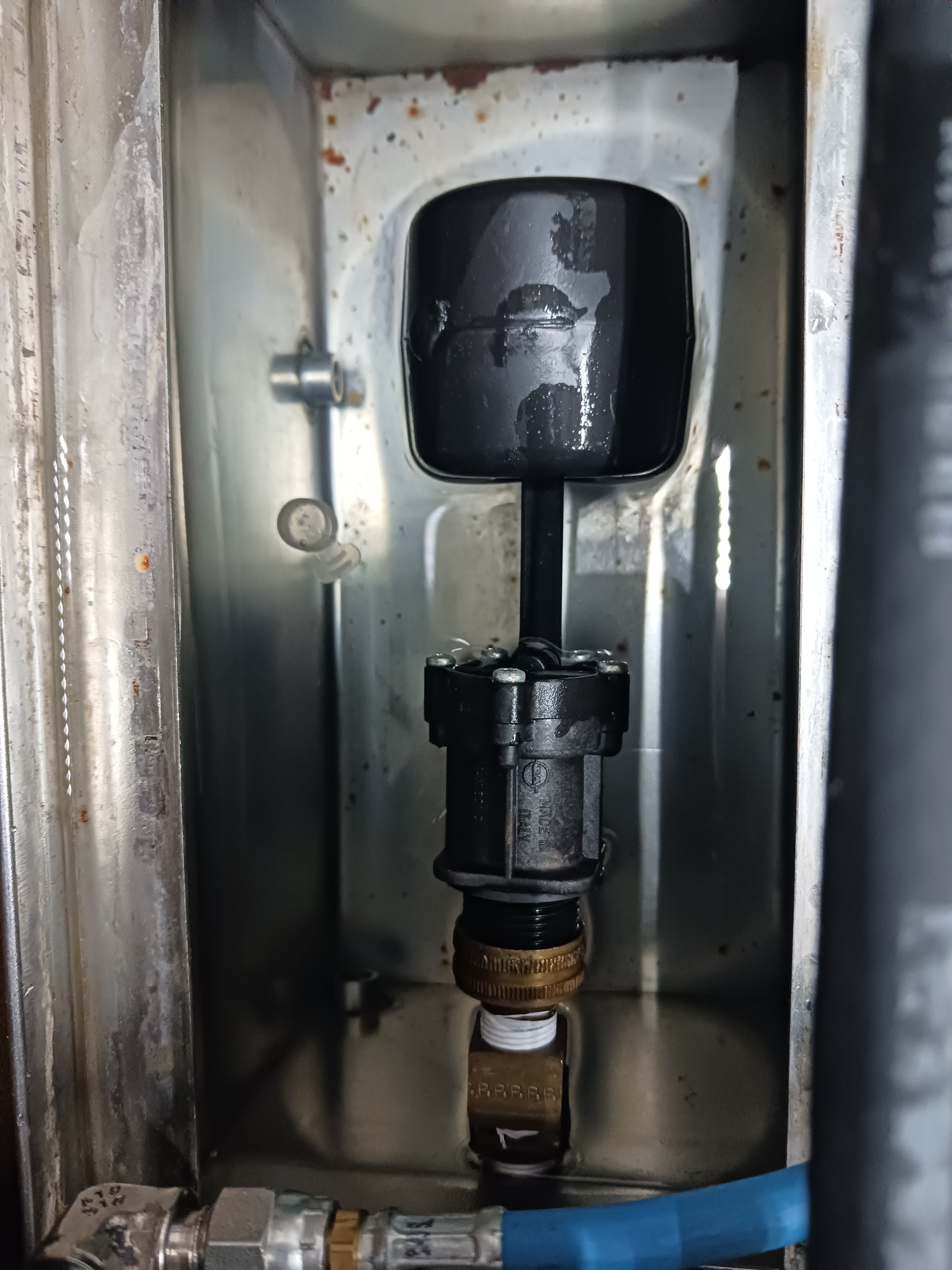

Do you see any place that sell the water box complete valve, float and rod?I'd probably stick with the harwil L-21 (?) that is in it
I didn't even look since afaik it is just a valve......but I will

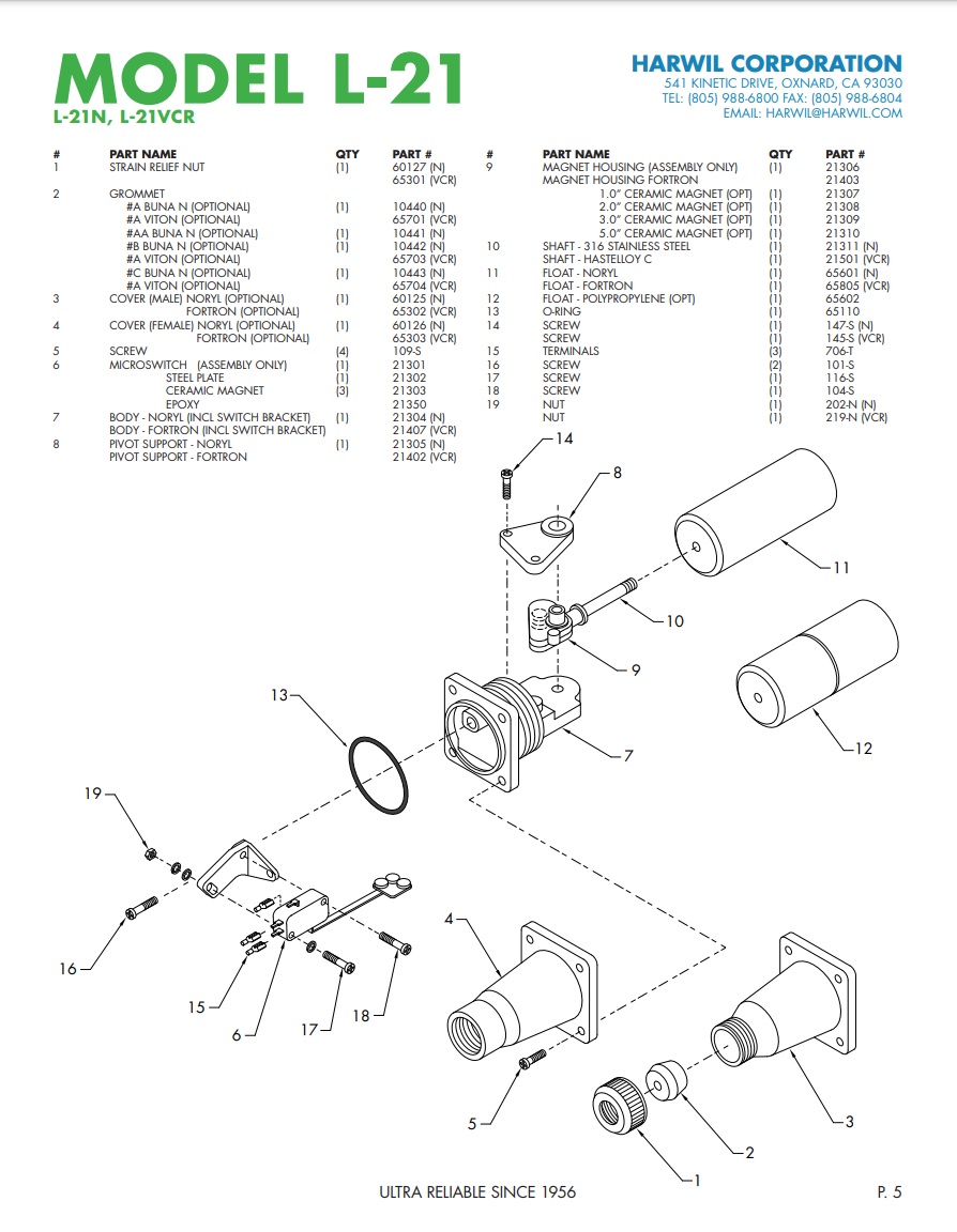

also the harwil level switch you don't necessarily have to buy the whole thing
you'll probably have to pull the switch part number after disassembly unless going straight to harwil (or supplier in vid)
