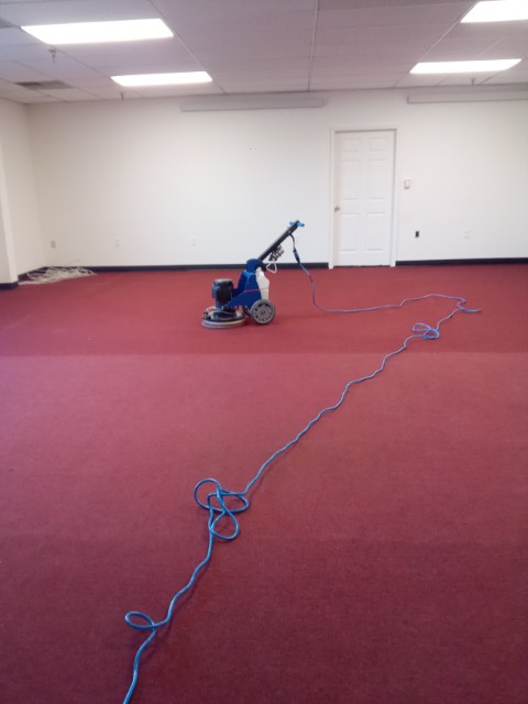

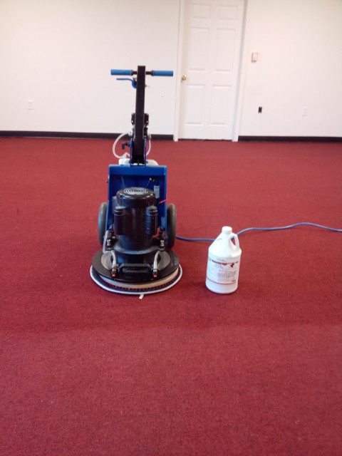

Oxy-Dry from Canada is the King of Floor Machines. He uses a 200-300 rpm Rotary with a tank to disperse the solution through a bonnet
His results are amazing. Clean and dry in most cases in less than one hour
He has been in Business for over 30 years, has many many YouTube videos, and a Facebook Group for VLM'ers
He is also the guy that came up with SETT - Soil Extraction Transfer Technology
